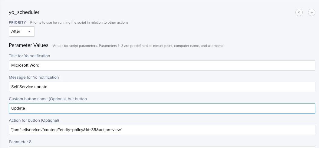

@mm2270 Great work on this script.. I am running into an issue where the script runs but the listed action does nothing. I've tried running this using our custom Yo build and the generic build just to make sure it was not me.
Am i missing anything? any pointers on this would be appreciated. We are now resorted to bugging our users to update.

Hi @mack525. Off the top of my head, I'd say change the "action" parameter string to something like:
open jamfselfservice://content?entity=policy&id=35&action=view
I think the open is needed or Yo may not know how to handle the link on it's own. When you send a Self Service link like that via email, the email application typically knows it's a hyperlink and will instruct the OS to attempt to open it, but with Yo you probably need to be more specific, by using that open command in front of the link.
You also shouldn't need the quote marks, since the entire parameter string should be passed to the Yo application with quotes around it based on how I designed that script.
Give that a try and see if it helps.

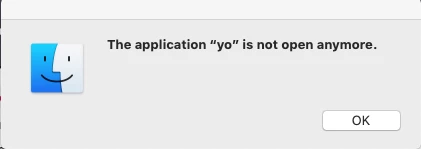

@mm2270 that actually did not work within the script either. Oddly enough i am now getting this strange error.
Even though the application is installed.

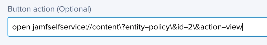

@mack525 I'm not sure what may not be working for you, but in case it helps, I've had this running on recurring check-in, set to Ongoing as a test scoped to my 10.14.3 Mac, and it works fine. When I click the button, it opens Self Service to the description of this policy.
Oh, and that's not a vertical pipe at the end of the string. Just my cursor while I was in the field that got captured in the screenshot.
Looking back at my last post, I realized I forgot to mention you still need the open part of the command. It's not enough to put the URL in there, even when the characters are properly escaped. I guess Yo just doesn't know what to do with those links since they are not the usual things like mailto: or http, www etc.
