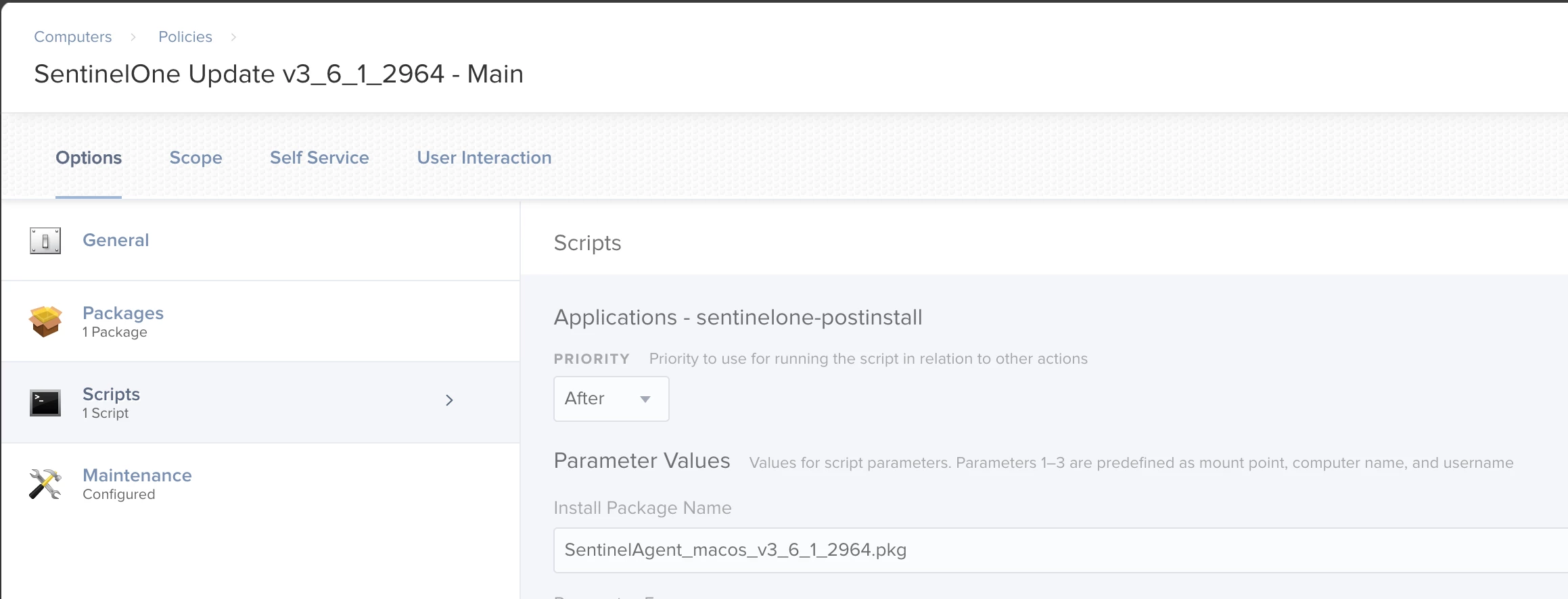

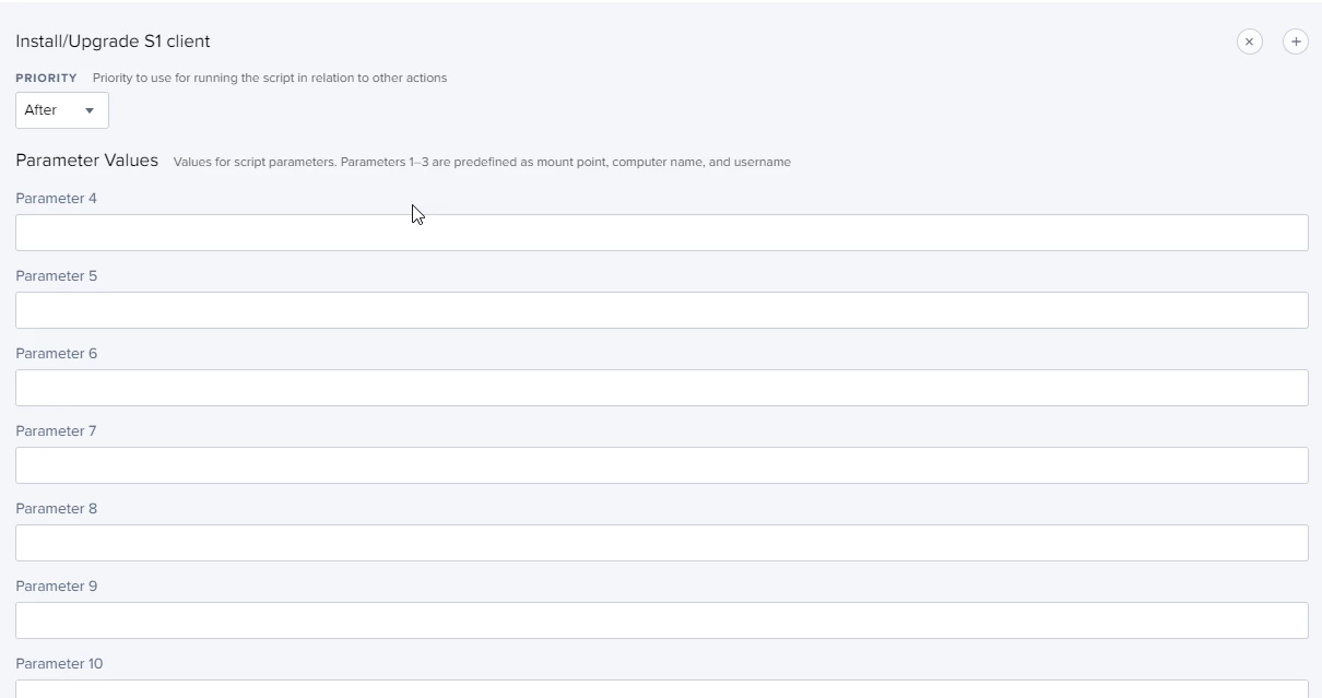

I made the PKG_NAME="$4" so that the variable could be given to it by the Jamf Policy (see attached image)

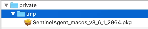

my installer goes into /private/tmp/ (i attached a screen shot of my composer package as well)

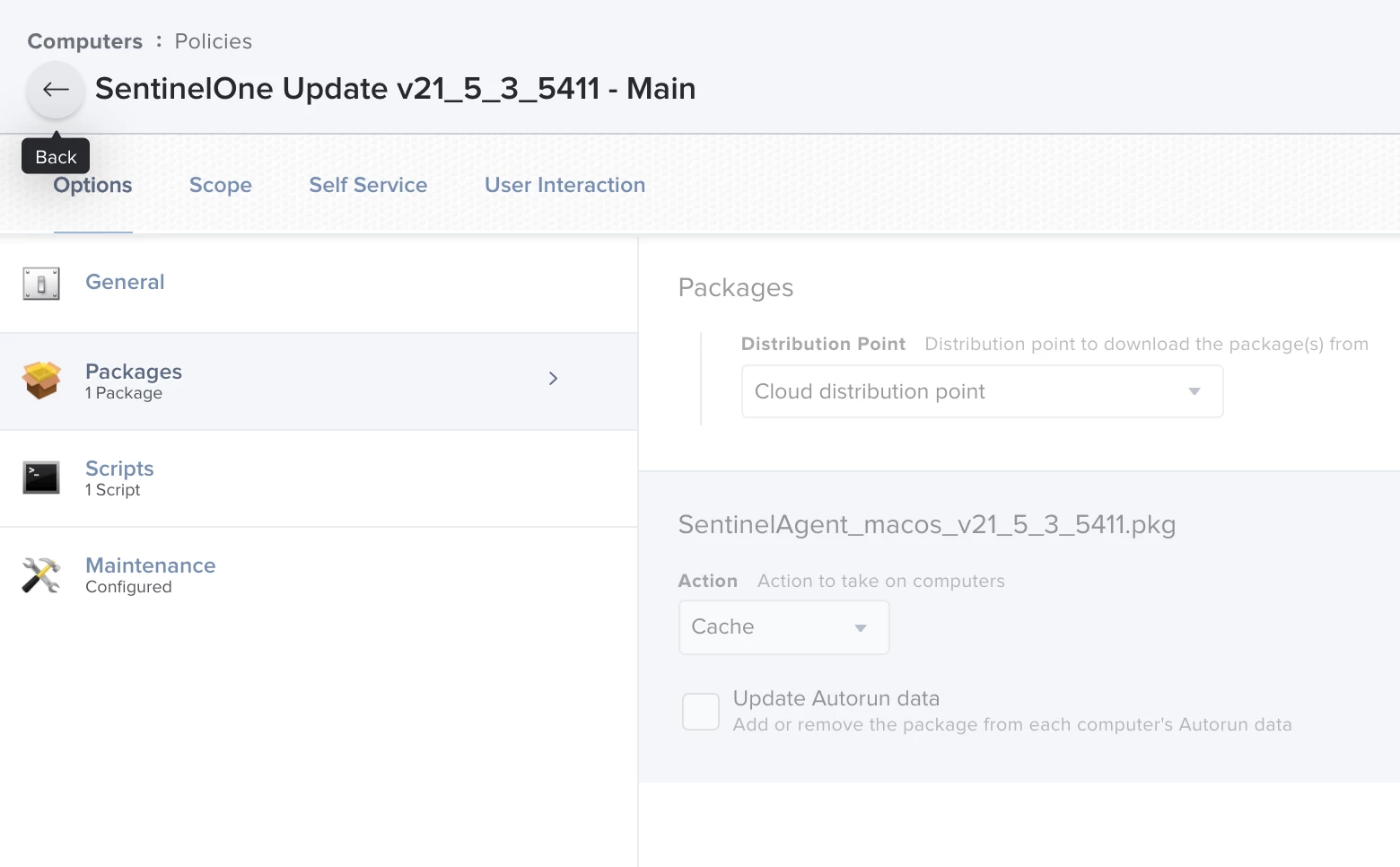

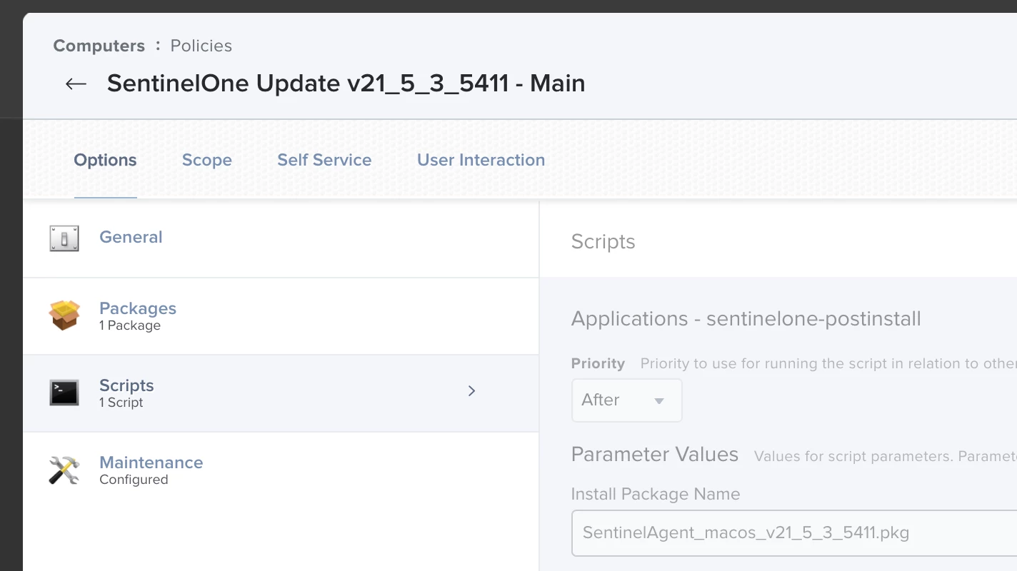

I've honestly stopped re-packaging things and putting them in /tmp I just cache the installer so it installs right from the waiting room.

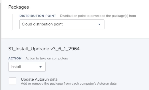

  • April 6, 2022
I ran into the same issue. I found in the policy that I had my packages set as install when it needed to be set as "Cache".  The script completes the download for me
