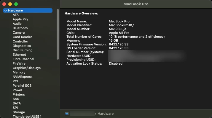

The model number will tell you the color. You could use a script to read the model number from system profiler and use some Variables to add the color to the host name.
For example:
  • MJV93LL/A is the blueish iMac
  • MJV83LL/A is the greenish iMac
  • MJVA3LL/A is the pinkish iMac
The Model number will change ever so slightly for different configurations like RAM, CPU, SSD and Color. The command below will pull the Model Number, the results need to be prettied up for a script but its entirely possible. JAMF is also aware of the Model Number, if you wanted to have different policies scoped to different model numbers and do it that way.
system_profiler SPSoftwareDataType SPHardwareDataType | grep "Model Number"

Hi AJPinto, thank you for your reply.
I tried that but on the machines it responds with a wrong model number I'm afraid (e.g: Model Number: Z12U000SEFN/A)

It reports back fine on my device with system profiler.
I just updated a script I use to name devices add a function for the model number. I have not tested it but it should set the hostname to Model Number Serial Number (example: MK193LL/A Q74V1234WX). Just add more and update the existing if statements to turn MK193LL/A in to the color verb you are wanting. MK193LL/A is for a Space Gray MBP16, it should report out correctly for whatever the device the script is run on has.
#!/usr/bin/env bash #*============================================================================= #* Script Name: #* Created: #* Author: #*============================================================================= #* Purpose: Requests input and renames computer based on Naming Conventions #*============================================================================= #*============================================================================= #* GLOBAL VARIABLES #*============================================================================= computerName=$(scutil --get ComputerName) hostName=$(scutil --get HostName) localHost=$(scutil --get LocalHostName) serialNumber=$(system_profiler SPHardwareDataType | awk '/Serial/ {print $4}') serialNumberII=$(system_profiler SPHardwareDataType | awk '/Serial/ {print $4}' | tr -d '"') modelNumber=$(system_profiler SPSoftwareDataType SPHardwareDataType | awk '/Model Number/ {print $3}') #*============================================================================= #* SCRIPT BODY #*============================================================================= ## Check & Update Computer Name if [ "$computerName" == "$modelNumber $serialNumber" ] then echo "Computer name matches serial number, $modelNumber $serialNumber" else echo "Current Computer Name: $computerName" echo "Computer Name does not meet standards" echo "Changing Computer Name to match Serial Number" scutil --set ComputerName "$modelNumber $serialNumber" fi; $DIV2 ## Check & Update Host Name if [ "$hostName" == "$modelNumber $serialNumber" ] then echo "Host Name matches serial number, $modelNumber $serialNumber" else echo "Current Host Name: $hostName" echo "Host Name does not meet standards" echo "Changing Host Name to match Serial Number" scutil --set HostName "$modelNumber $serialNumber" fi; $DIV2 ## Check & Update Local Host if [ "$localHost" == "$modelNumber $serialNumber" ] then echo "Local Host matches serial number, $modelNumber $serialNumber" else echo "Current Local Host: $localHost" echo "Local Host does not meet standards" echo "Changing Local Host to match Serial Number" scutil --set LocalHostName "$modelNumber $serialNumber" fi; $DIV2 ## Final Check computerNameII=$(scutil --get ComputerName) hostNameII=$(scutil --get HostName) localHostII=$(scutil --get LocalHostName) echo "" echo "Serial number: $modelNumber $serialNumber" echo "Computer Name: $computerNameII" echo "Host Name: $hostNameII" echo "Local Host: $localHostII" if [[ "$computerNameII" == "$modelNumber $serialNumber" ]] && [[ "$hostNameII" == "$modelNumber $serialNumber" ]] && [[ "$localHostII" == "$modelNumber $serialNumber" ]] then echo "Computer Name satisfies naming standards" $DIV1; exit 0 else echo "Computer does not meet naming standards" echo "More troubleshooting will be necessary." $DIV1; exit 1 fi ## Perform final Recon to update computer name on Jamf sudo jamf recon #*============================================================================= #* END OF SCRIPT #*=============================================================================
I am not sure if I would try to read the color theme, that just seems like it would be a mess with how Apple does things. Id stick to system profiler, and convert the model number to a color with a if statement.

Thank you for your response. I was thinking about converting the model number to the color via an if statement but am clueless why the system profiler reports back the wrong model number.
 Just comes back with "Z12U000SEFN/A" Mac is fully up-to-date.
*edit*
I guess its because the Mac is a built-to-order with different than basic specs. 😅

What does Hardware information say? Z12U000SEFN/A is not a valid Model Number as far as I am aware. If you are testing on a VM this is one of the things that does not come through correctly.
Jordy-Thery
  • April 7, 2023
The hardware overview says the same. Z12U000SEFN/A is a valid model number though, it's a built-to-order Mac with following specs: Apple BTO IMAC 24" M1‑chip 8C CPU/8C GPU 16GB, 256GB GIGABIT MM MAGIC KBD TOUCH ID NUM AZERTY - GREEN
AJPinto
  • April 7, 2023
Each model ID would need to be accounted for in the script.
You need to add something like this, and you would need an if statement for each model number you want to cover. I would also put an if statement for if the Model Number does not equal one of your options so the script does not error. Id also add a function to skip all this mess if its not an iMac.
#!/usr/bin/env bash serialNumber=$(system_profiler SPHardwareDataType | awk '/Serial/ {print $4}') modelNumber=$(system_profiler SPSoftwareDataType SPHardwareDataType | awk '/Model Number/ {print $3}') if [ "Z12U000SEFN/A" == "$modelNumber" ] then echo "Someone got a ping iMac" scutil --set ComputerName "pink $serialNumber" else echo "thank god its not pink" fi if [ "MK193LL/A" == "$modelNumber" ] then echo "Good, someone has the only correct color; space gray" scutil --set ComputerName "Space Gray $serialNumber" else echo "Its not space gray?!?! What is wrong with this person" fi
This will probably turn in to a reasonable long script, but thankfully it should not be a complicated one and it will repeat a lot. So once you have the verbiage down its just copy past and make adjustments.
