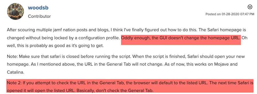

@bwoods, If we relaunch the safari again it opens with the default apple page.
bwoods
  • Feb 7, 2022 2:24 PM UTC
@user-aj what OS version are you running? What is the output of the script?
  • Feb 7, 2022 2:38 PM UTC
MacOS Monterey, it relaunched once with the correct homepage and in safari preferences it shows the default one. After quitting the safari and relaunch it going to the default again.
bwoods
  • Feb 7, 2022 4:12 PM UTC
Will do some testing. Haven't looked into this on Monterey yet. Will get back to you.
bwoods
  • Feb 24, 2022 3:25 PM UTC
@user-aj It works the same for me on Monterey, but I do understand what you're saying. I mentioned this behavior when I initially created the script. You can't check the safari preferences, or it will revert. Haven't figured a way around this.

Our requirement is to land the home page for initial setup and change it afterward. After testing it listed the homepage once launched, but gone without changing it

For my script, you basically just have to avoid checking the URL in Safari preferences. If you don't check, it'll open on your page every time. I figured if a user is going into Sefari prefs and checking the URL, they're going to change it anyway.
