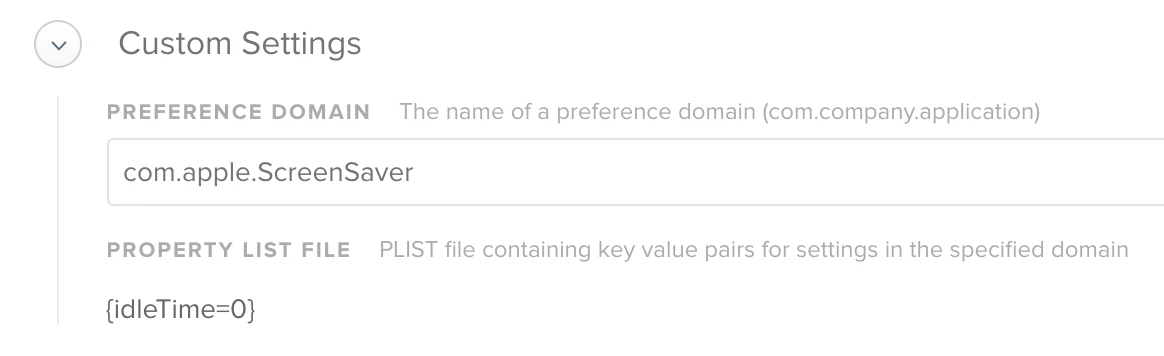

I am having an issue with Jamf having "Start screen saver after" unchecked within a configuration profile, yet after 20 minutes each one of the iMacs run their screensaver. Does anyone have a workaround to changing the screensaver time from 20 minutes to never without me having to apply it individually per workstation?

This can be done, but you need to use a Custom Settings payload with a plist uploaded.
The trick to getting the screensaver to not kick in at all is to set the idleTime setting in the com.apple.ScreenSaver.plist to 0
You can do that with the following set of commands in Terminal
defaults write ~/Desktop/com.apple.ScreenSaver.plist idleTime -int 0
plutil -convert xml1 ~/Desktop/com.apple.ScreenSaver.plist
Then go into Jamf Pro, create a new Configuration Profile and add a Custom Settings payload. Upload the plist on the Desktop that was created using the above steps and it should look something like this:
One key thing about this - It must be set as a User Level Profile. A Computer Level profile won't work in my experience. What this means is that once it's scoped it may not get pushed down to any devices in scope until they either log out/in or an inventory collection is run on them. So if you're scoping it to a test Mac to start with, just run a sudo jamf recon on the Mac and you should see the profile get pushed down into the Profiles preference pane.
Once it's been successfully pushed to any MDM enabled accounts on your Macs, the setting in the Desktop & Screen Saver Pref Pane should look like this:

I'm following your guide @mm2270 but I cannot seem to get the profile to push to any endpoints when using "User Level" scoping. As you say Computer Level scoping results in the profile being successfully delivered, but the payload doesn't seem to work. After adjusting to "User Level" I can no longer get the profile to show up on the Mac (multiple recons, multiple reboots, re-managing, etc) -- even scoping it to All Users / All Computers does not seem execute as I'd expect
When you say "...pushed to any MDM enabled accounts" I'm wondering if this is my problem. The computers in-scope for my profile are all kiosks, with local user login (i.e. 502-type account). Would this be my culprit? If yes, is there any way to still force JAMF to push it down anyway?

Hi @ryan.s So, by "any MDM enabled accounts" what I mean is, if you go into a computer record and look in the General tab for a line labeled "MDM Capable Users" That should show a list of one or more user accounts that can receive user level profiles. If your user accounts are all local, be aware that only one local account can be MDM enabled. If they are AD users, then any of them can be. I'm not sure why it works that way, but that's how it is.
If the user you are trying to push the profile to is not listed as MDM enabled, then it will never get the profile pushed to it. It's not a machine certificate, so it works differently.
Hopefully that helps a bit.

Thanks for this, saved me a couple of days of headche. I have 11 M1 mac minis being used as Zoom Rooms, they all had a existing config profile with the login window payload that disables the screen saver. for some reason the config profile was not applying the screen saver part and every 20 mins or so the Screen Saver would start. I applied the above as a new config profile but based it on Device level instead of User level as i dont have any MDM enabled accounts on these machines. and it seems to be working.

I can confirm @mmobin this is working for me as well. Having it set to User-Level removes the profile, while Computer-Level adds it back.
