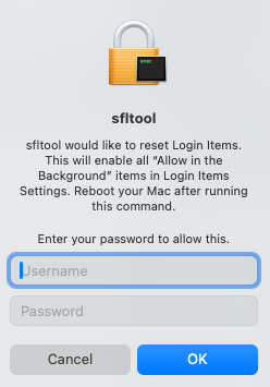

sfltool popup when installing Maya 2024 via script
  • Jun 24, 2024 9:44 AM UTC
  • 0 replies
  • 57 views
I am installing Maya 2024 and I am running into this popup.  I am able to get the license to verify via the network server when putting in my credentials.  I haven't tried on a non-admin machine.
I created a configuration profile with Managed Login Items, and added the Team Identifier/Bundle ID to it and deployed it to my machines and still getting the popup.  I've not seen this popup before.  Anyone have any info/experience on this?
Here is the script I am using, with the AutoCad and Mudbox install lines removed:
#!/bin/zsh ### Install AutoDesk Combo 2023 (AutoCAD, Maya & MudBox) ### silently @ login window with network licenses (aka multi-user lab/classroom deploy) ### 2022.07.27 by JonW ### Simply update variables/products below the function section as desired ### Read the additional details at the end of the script for more clarity on licensing. ### Ensure: ### 1) installer app(s) re-packed from .dmg by Composer & deployed to /private/tmp (root:wheel 755) ### 2) the network license server is functional ### 3) optionally, that previous Autodesk installations have been removed. ### and if so, you've also unloaded com.autodesk.AdskLicensingService.plist ################################################# installFunction () { ### Before install, clear quarantine that may step on Setup.app when run at the login window. ### Also as of 2023, Mudbox still uses a different setup app path with --noui flag NOT --silent ### Finally, remove the installer app when complete /usr/bin/xattr -rc /private/tmp/"${installerApp}" if echo "$installerApp" | grep -iq "Mudbox"; then /private/tmp/"${installerApp}"/Contents/MacOS/setup --noui else /private/tmp/"${installerApp}"/Contents/Helper/Setup.app/Contents/MacOS/Setup --silent fi /bin/rm -rf /private/tmp/"${installerApp}" } licenseFunction () { ### based off Onkstons's terrific work (I think they we're the first?) but simplified for 2023. ### see also, addl details at the end of script for alternative 'legit' licensing method. licensePath="/Library/Application Support/Autodesk/AdskLicensingService/${productKey}_${year}.0.0.F" /bin/mkdir -p "${licensePath}" /usr/bin/touch "${licensePath}/licpath.lic" /bin/echo "SERVER ${networkServer} 000000000000" > "${licensePath}/licpath.lic" /bin/echo "USE_SERVER" >> "${licensePath}/licpath.lic" /Library/Application\\ Support/Autodesk/AdskLicensing/Current/helper/AdskLicensingInstHelper change --pk "${productKey}" --pv "${year}.0.0.F" --lm NETWORK --ls "${networkServer}" } ################################################# networkServer="your.network.license.server.here" ### AutoCAD productKey="11111" year="2023" installerApp="Install Autodesk AutoCAD 2023 for Mac.app" installFunction licenseFunction ### Maya productKey="11111" year="2023" installerApp="Install Maya 2023.app" installFunction licenseFunction ### Mudbox productKey="11111" year="2023" installerApp="Install Mudbox 2023.app" installFunction licenseFunction ################################################# ### Verify license details - not required, but kind of nice to see. /Library/Application\\ Support/Autodesk/AdskLicensing/Current/helper/AdskLicensingInstHelper list echo "Autodesk network licensing complete" ################################################## ### Additional network license details: ### For those who are curious, or if the above ever ceases to function: ### The 'legit' method for initial silent license registration (using autoCAD as an example) uses the 'register' command instead of 'change'. ### It also requires use of the --cf flag to denote a path to the app's config (.pit) file. ### e.g. ### configFile="/Library/Application Support/Autodesk/ADLM/.config/ProductInformation.pit" ### /Library/Application\\ Support/Autodesk/AdskLicensing/Current/helper/AdskLicensingInstHelper register --pk "${productKey}" --pv "${year}.0.0.F" --cf "${configFile}" --lm NETWORK --ls "${networkServer}" ### The end result is the same as the 'change' method used above (at least after the initial app launch). ### Essentially the 'change' method works backwards to manually create the licpath.lic directory & file, ### then uses the 'change' command to register it. ### Anecdotally, the 'change' method appears to produce a slightly faster initial app launch, ### but it's hard to say which is better. ### Either way, it's good to know both & having handle on the AdskLicensingInstHelper utility helps a lot! ### Check these out >>> ### /Library/Application\\ Support/Autodesk/AdskLicensing/Current/helper/AdskLicensingInstHelper register --help ### /Library/Application\\ Support/Autodesk/AdskLicensing/Current/helper/AdskLicensingInstHelper change --help ### Also, either method seems to deploy fine while at the login window, so no worries there. ### Some good tips & reference: ### https://knowledge.autodesk.com/support/autocad/troubleshooting/caas/sfdcarticles/sfdcarticles/Use-Installer-Helper.html ### https://knowledge.autodesk.com/search-result/caas/CloudHelp/cloudhelp/ENU/Autodesk-Installation-Basic-ODIS/files/ODIS-silent-install-htm.html ### Hope this helps some folks out!
