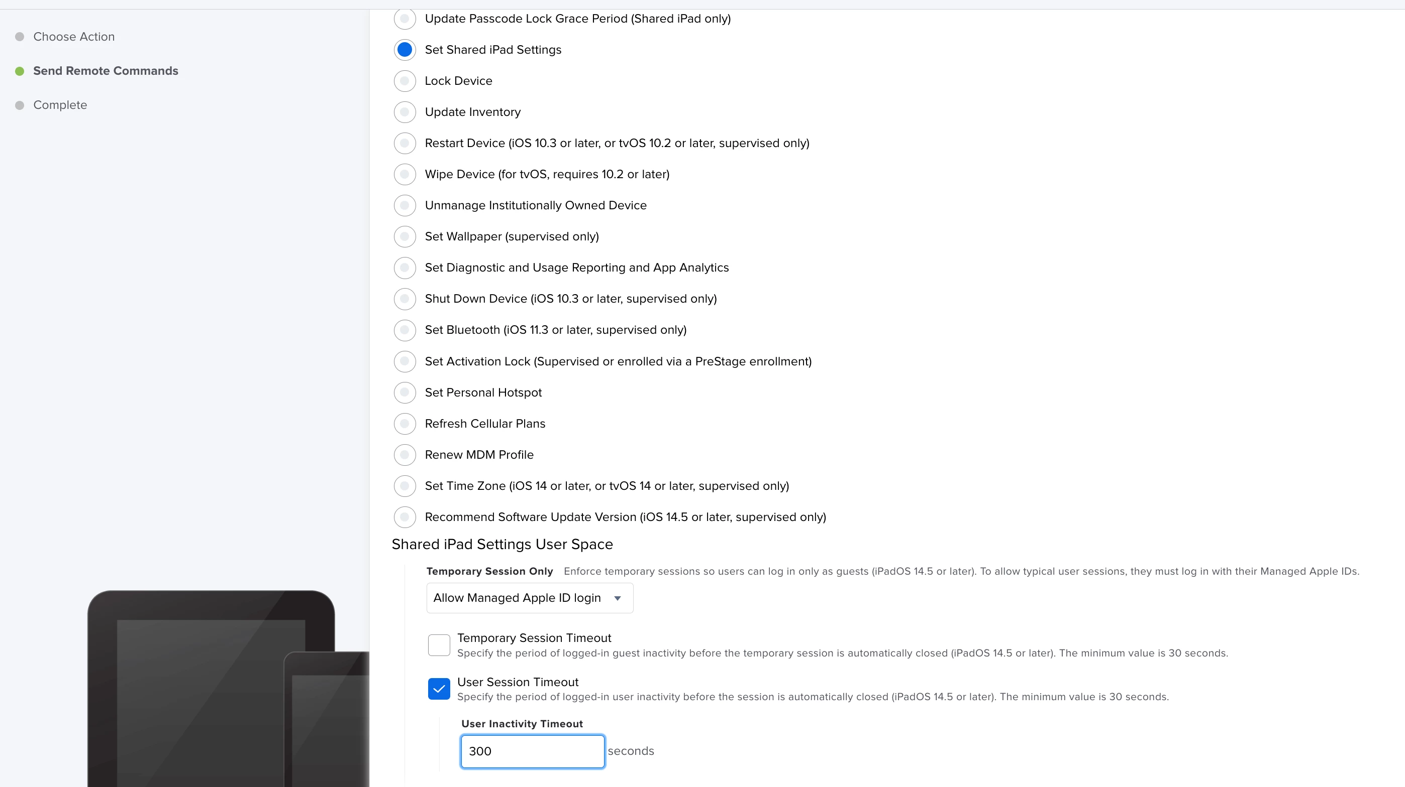

If the iPads are set as true Shared iPads you can not change when they lock but you can change the Lock Grace Period in Remote Commands.
  • March 5, 2018
@bfrench
Wow, I can't tell you how many times I've looked right at this and it never dawned on me that the solution to our problem was right there. Thanks for sharing your screenshot. I interpreted the usage differently and thus never used it.

User session timeout is not the same as the "Update Password Lock Grace Period" command which is what this thread is about. The "User Session Timeout" command is for logging a user out of a Shared iPad session. This thread is about extending how long it takes for the screen to lock in Shared iPad sessions.
  • February 16, 2023
As an update, I just tested this again on a Shared iPad, sending a command to adjust the "Update Password Lock Grace Period" to 5 minutes. It had no effect and the iPad Lock Screen was enabled after 2 minutes. So the issue is not resolved.
