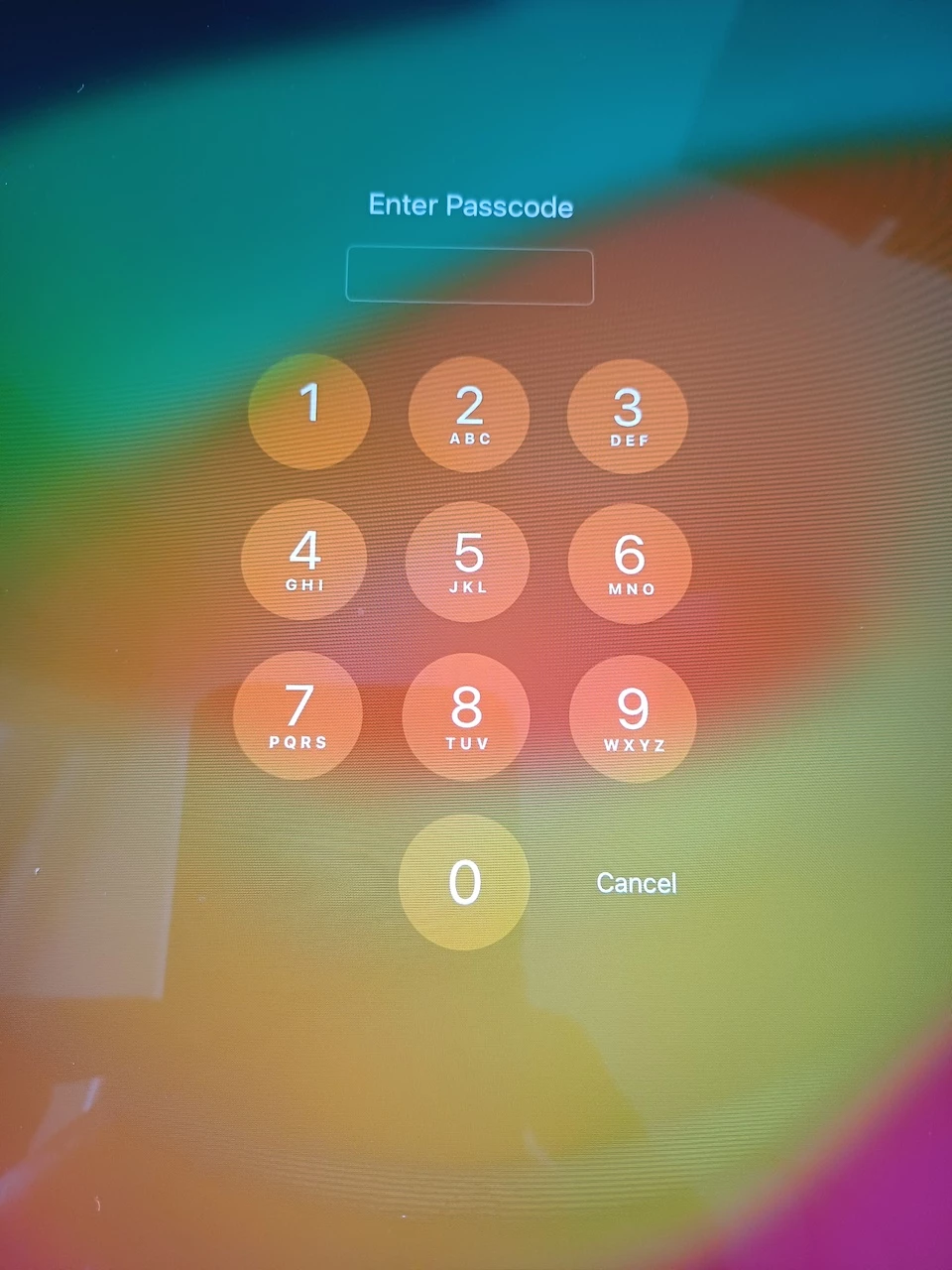

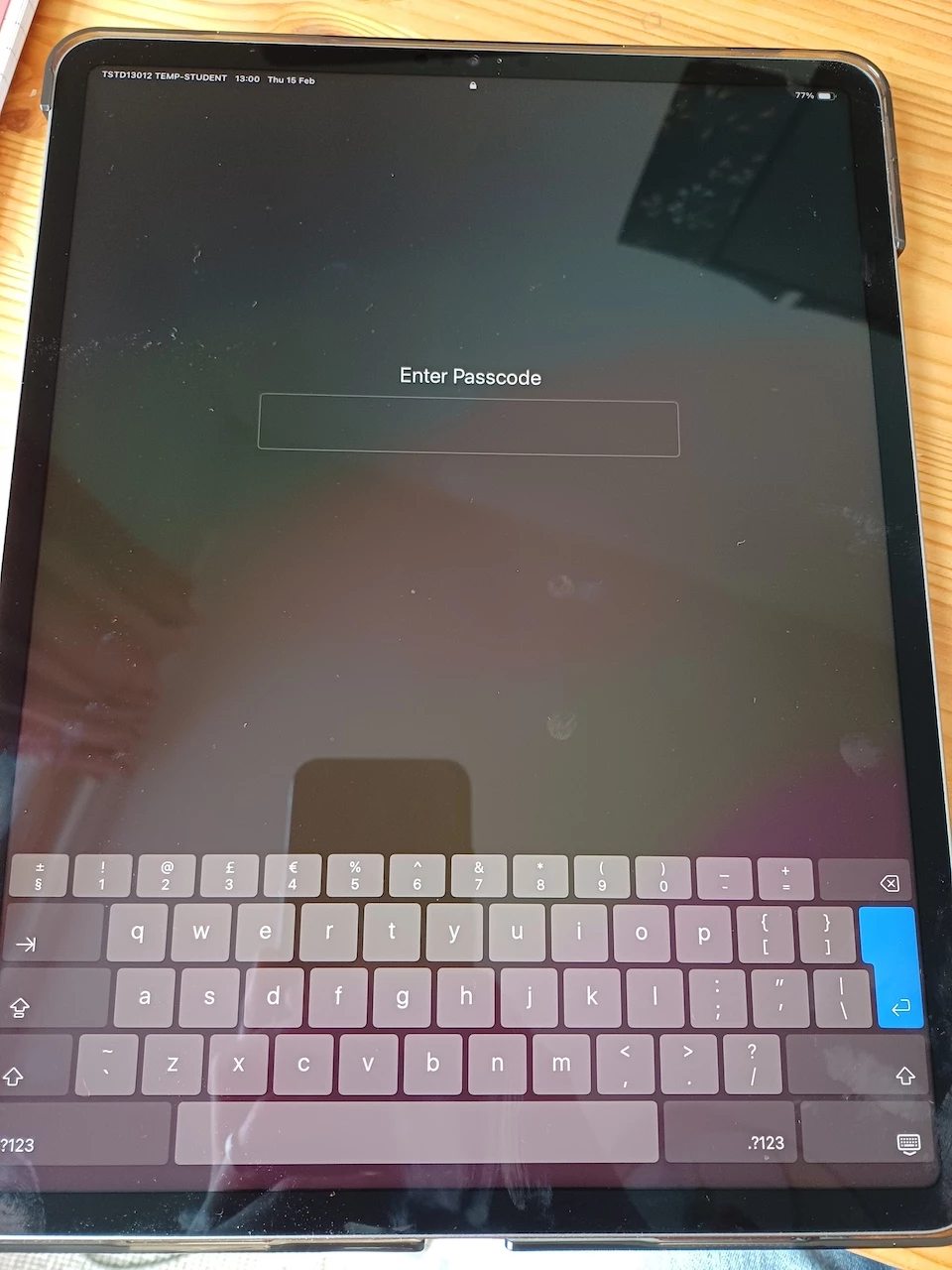

We are a University with Apple School Manager and Federated Apple ID setup, devices managed by Jamf Pro. Recently we've seen an issue with new users signing in to our shared iPads. They sign in with the federated account details fine, are prompted to create a passcode as normal:
Then, when logged into the iPad, when the screen locks then the prompt to enter their passcode to unlock it is not the same as the normal federated one, its a numerical keyboard only, so they have no way of entering the alphanumeric passcode they just created:
I've found that resetting the users passcode within School Manager resolves the issue. But its not a workable solution to have to do this for an entire class during a teaching session. Has anyone else experienced this issue?

Just heard another admin that is running into this issue, so if someone hits the same wall here are my notes:
What you're running into is a known behavior with Shared iPad: Apple School Manager has a passcode complexity setting per managed Apple ID (4-digit, 6-digit, or Complex/alphanumeric). If that's set to Complex, students can set an alphanumeric passcode the first time they log in, but the Shared iPad lock screen that shows up right after only presents a numeric keypad, so there's no way for them to enter the passcode they just created, and they get bounced back to the login screen. That matches exactly what you're seeing.
The fix is on the Apple School Manager side rather than in Jamf: change the passcode policy for the student accounts used on these carts from Complex to 4-digit (or 6-digit) numeric. That way the passcode students set matches what the lock screen can actually accept, and you avoid the reset loop entirely going forward. For any students already stuck, they'll still need one reset in ASM to clear the mismatched passcode, but after that the numeric policy should prevent it from happening again.
