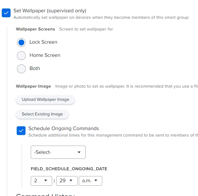

  • Secondly, I have the device smart group supposed to be setting a wallpaper / lock screen on the device, but this doesn't appear to take. The group says the wallpaper command was 'Acknowledged', but it stays on the default. I DO have a setting applied that prevents changing the wallpaper, possibly this is preventing it?

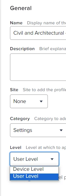

  • Web Clips seem to need to be set to the user level, not device level, in shared iPad mode. That is what the error is complaining about "Cannot be installed for system". You can change this on your config profile in the general tab. It does mean that the web clip won't load until after the user signs in (even for guest accounts), but it should show up.
  • In my testing our smart groups do set the wallpaper/background for shared iPads, but during the initial setup the iPad restarts or reboots itself and then loses the image settings. Usually if its a small group I would push the proper image back out using commands on the management tab of each device. Not ideal for large groups but manageable for individuals. If it was a large group and the devices are all on hand, then I would wait until all devices are provisioned and then set the image with a smart group. Something else that might help. I recently found that smart groups can schedule ongoing commands. I have not tested this to see if how it works, but potentially something else to try and force the image to re-add to devices each night.

lays2 - fantastic! I just gave that a try for both items and it worked immediately. Had made my morning. :)
Thank you for both taking the time to reply and the thoroughness of your answer. Hugely appreciated!
