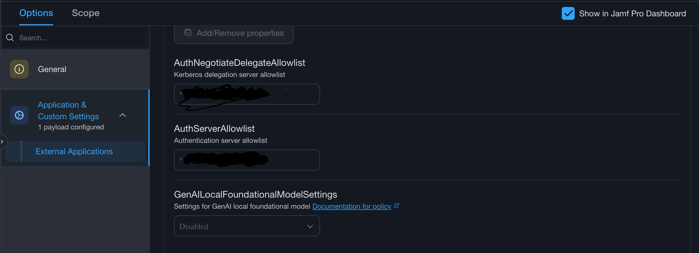

This is what our Google Chrome config profile looks like. Only three keys

Gotcha.  So the top setting (called Kerberos delegation in google admin center) is what’s doing it.  It’s grabbing a kerb token locally which allows it to “just work”. I’m assuming you still have on premise AD and that’s where you’re testing all of this.
Get CP working properly (enrolled with a TGT) and the SSOe configured….and  Edge will work beautifully.
