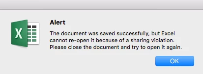

We are having an interesting issue at our company. Using both PCs and Mac computers by the creative departments. When we try to save an Excel/Powerpoint file on our Windows file servers we get a sharing violation error, the permission table gets messed up and the file cannot be re-opened again until our server guys re-inherit the rights on the file servers. All Macs connect via SMB.
The Macs are running El Capitan (not fully up-to-date, 10.11.4) and the Windows file servers are all Windows Server 2012 R2. Previously not just excel sheets and powerpoint presentations had this problem but all other files as well. The servers are utilizing DFS and we also have Talon File Services installed.
We are granting access to the servers via Active Directory groups, two different ones, one for read-only and one for read/write. When the issue happens the file loses all individual and group rights in ACL, only the currently editing user is there with read/write access and everyone with no rights, but nobody can open the file again.

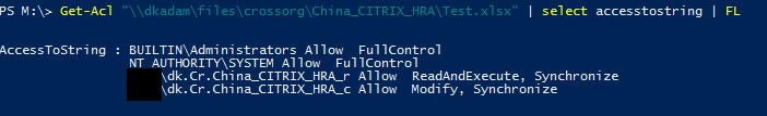

While a healthy file looks like this:

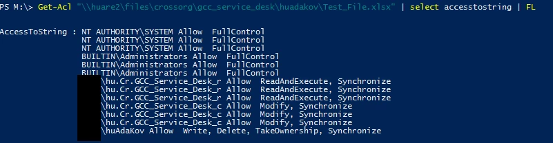

Wireshark was showing a lot of "object not found" and "access denied" error messages on the "faulty" shares. Also when I check from Powershell on a Windows machine I can see that the ACL entries are sometimes duplicated or even triplicated on shares where I'm not the owner of Temp. For example this is a file that is editable but if I create a copy from it and try to save I get sharing violation.
A file that has no problems looks okay, otherwise all non-Excel and Powerpoint looks like this:
