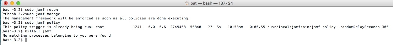

Sick and tired of failure of recon, policy and manage commands
The picture above shows how the recon, policy and manage commands are failing. What do we do if these commands are not taking affect immediately ? Can anyone please help ?
Best answer by sdagley
@khurram You need to do a sudo killall jamf to kill the Jamf processes

notice how the 'recon' command was not responding and then Ctrl + c was used to abruptly end this command
garybidwell
Policy checks run as per your global checkin settings on the JSS - yours is reporting 300 seconds (so every 5 minutes)
All Settings, Computer Management Management Framework, Check In
if you need to run a policy check instantly, just running jamf policy command is all that is required to check for new and outstanding scheduled policies (the execution is then done a per each of your policy settings - once per computer, once per day, each check-in etc...)
*Not required for Config Profiles as that's APNs, which is near instant (or at least as how fast Apple's network sends out the APNs commands)
I'm not sure why you are running a Jamf manage command as this should really only be used on unmanaged devices or if you have issues with the client, as it forces all the jamf framework to be re-installed from scratch (its will then run through nearly all the commands as if its just been enrolled).
From the jamf man pages: manage = Enforces the entire management framework from the JSS
jamf recon - this does do a jamf policy command as part of its function, but also updates the inventory records at the same time (normally once a day is the default) - depending on your inventory this can take a minute to collate and upload to the JSS
if you clicked every inventory option and also collect user application usages stats the recon command could take upto 15 mins to get all of this.
You won't get any feedback on a recon command until its finished getting the info on inventory settings and what extension attributes are being used from the JSS - then is should start giving feedback on each step of the command
If it really is hanging then its struggling to talk to your JSS use the jamf checkJSSconnection command and may be try the -verbose and -displayJSSTraffic options on a recon to see how much data it being sent back to the JSS

  • May 29, 2019
Thanks @sdagley I was actually missing the sudo, aarrrghhh, silly me. If you are working as 'root' you don't need to add sudo.
