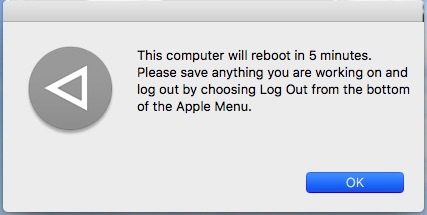

In testing I can force the Management Action to show up with the wording I want. Yet the entire install happens in the background so I'm concerned users will open apps and try and do work during the longer updates - screwing up the updates. Is there a way to lock the screen or put a progress bar on the screen during updates?
Once the management action is complete, the Restart message is at default "This computer will reboot in 5 minutes...". Is there a place to set this? I have delay set to 1 in the Restart Options payload with a description set in the User Interaction Restart Message field.
