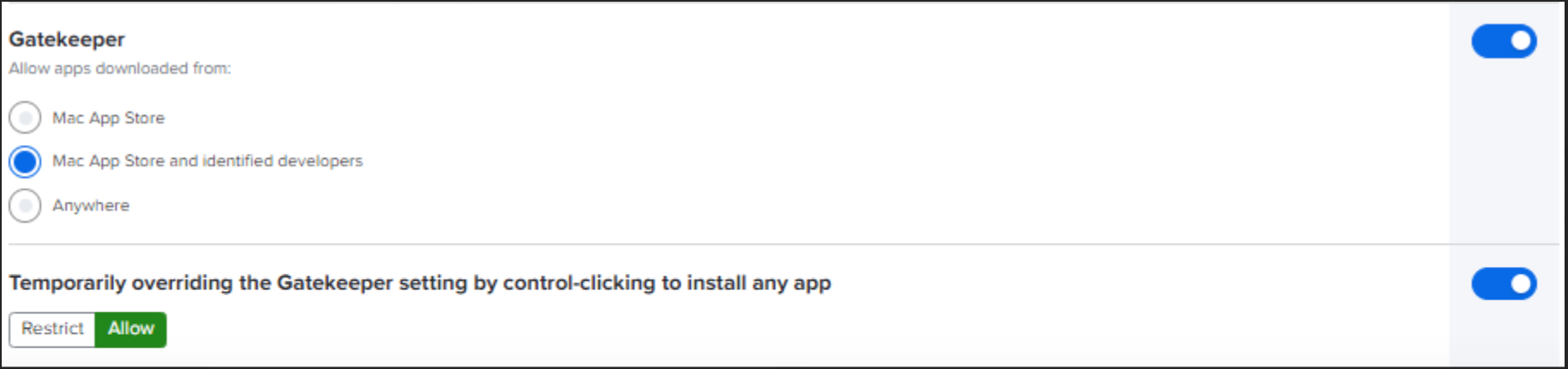

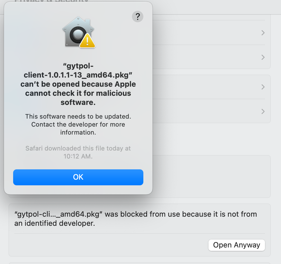

I have a simple question to ask. I'm trying to install an application called Gytpol on a Mac and I'm getting this error. (See screenshot 1) - When I click on: "Open Anyway" the same error still appears. I checked the GateKeeper settings and the options needed to bypass this error have been enabled - (See screenshot 2). I was wondering if there's another setting that I need in order to get this processed? Obviously, I don't want to bypass Gatekeeper with the spctl --MASTER-DISABLE command and disable GK since this install is going to be added onto other users.

As I can see you downloaded the pkg from the internet, I would check the quarantine flag on the file. It may be set and preventing Gatekeeper from scanning the package. I've seen that happen before, and the message you get is a little confusing.
Try running this against the downloaded app
xattr -dr com.apple.quarantine /path/to/gytpol-client-1.0.1.1-13_amd64.pkg
You may or may not need to use sudo in front of the command, not really sure. It depends on the ownership and permissions on it and which account you run this command under. The above will attempt to remove the Apple quarantine flag on it. Do that and then try installing it again.

Hey guys, I just wanted to add that we got this application from a vendor so it is a legitimate program that was approved by our Cyber team. We ran the command that @mm2270 provided and that worked. However, is this something more toward the application developer that this issue needs to be looked at or is there a way to disable the quarantine flag so this application can open freely without the use of commands or disabling Gatekeeper?
You can't permanently disable the quarantine flag on downloaded files as it's something that comes from programs like Safari and other browsers. I suppose potentially if you downloaded it from a Windows machine and transferred it to a Mac, it might not have that flag set, but I've never tried that. The best thing to do is keep that xattr command handy and run it against downloads as needed.
That said, I don't run into it too often, so it might have something to do with the originating site. For example, when I download any Microsoft installer packages from https://macadmins.software I never have an issue with those. But I've seen it from some others.
You might also want to look at this other recent discussion, as it seems Apple added some additional flags starting in macOS Ventura to downloads that can cause similar issues, that they failed to document thoroughly. This is my shocked face (-_-)
