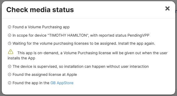

I've just added a new app to my Apple School Manager and have assigned 200 licenses. When I push this app out to an iPad it gets stuck on Waiting for Licenses despite there being more than enough available.
Checking the status of the app says "Waiting for the volume purchasing licenses to be assigned. Install the app again." Doing this just results in it staying on Waiting for licenses again.
This is the result of quereying the status of the app:
Apple School Manager has assigned the license but still Jamf doesn't complete the install.
Any ideas how I fix this?
[edit] I've just tried pushing a different app to this particular iPad and have the same issue. The iPad is online and checked in with Jamf and working for everything else. Just can't push apps to it.

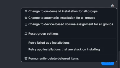

The app is assigned as 'On Demand', did you go to the device and tell it to download through Jamf Student/Teacher? I've had some issues before with apps that are set to 'On Demand', even if I tell them to install. If it's an app that I want on the devices I always will set it to 'Automatic'.

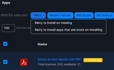

Another quick tip that I've used is to run the 'Retry app installations that are stuck on installing' and the 'Retry Failed app installations'. Those options are on the app's info page. Its the tiny gear right above 'Save' button.
There's a couple other 'Retry' options on the Apps > Inventory page too. One is the same as above.
