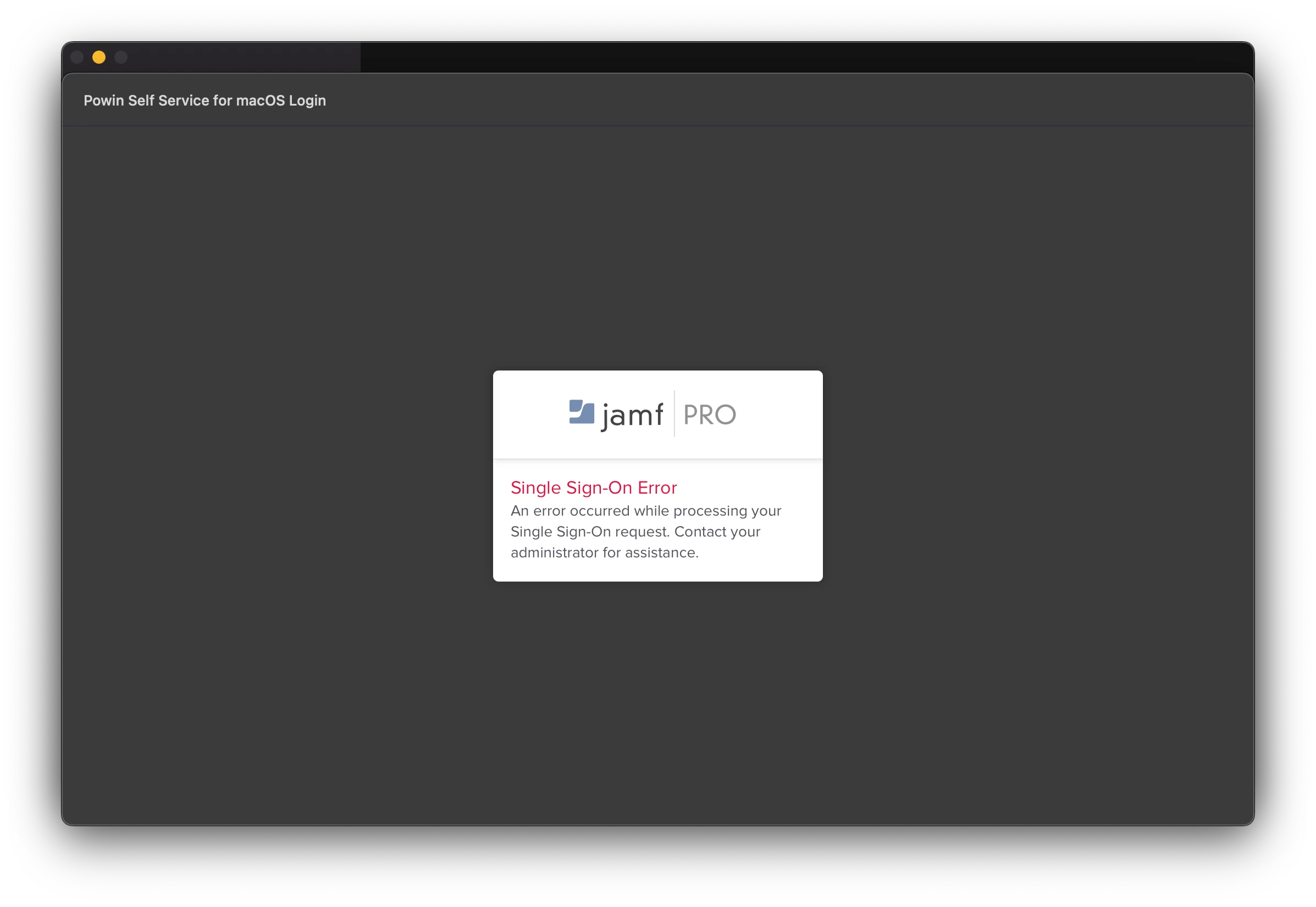

Single Sign-On Error in Self Service
  • April 28, 2022
  • 7 replies
  • 95 views
AntonyaJ
I've had this come up a number of times on the admin site, but this is a first for the Self Service app. I don't want my users to have to run into this.  When I run into it, I have to clear all cache related to login.microsoftonline.com, or open in private/incognito. Not something that can be done with the app. What can I do to keep this from happening in the app at least?
We're Azure IdP. I have Self Service set to require login, and to use SSO.
Best answer by Justin13579
I've tested and seen where if the SSO Token is set to never expire - this doesn't happen. That generally seems like a bad idea, but might point to the cause of the issue.
AntonyaJ
  • April 28, 2022
I had it set to expire after 8 hours. I was recommended to not do Never Expire, but I'm testing it out atm just for funsies. We'll see what happens /shrug
  • April 29, 2022
Had this for a while as well.. I just come to always open a incognito window as I thought disabling to not be a best practice.. but can confirm Disabling SAML Token expiration did eliminate the issue.

Did you get anywhere with Jamf support on this?
We had the same issue for our admins logging onto JSS.
We just checking before we add all users to SSO via Self Service.
AntonyaJ
  • December 5, 2022
After setting the token to never expire, I stopped having the problem.
