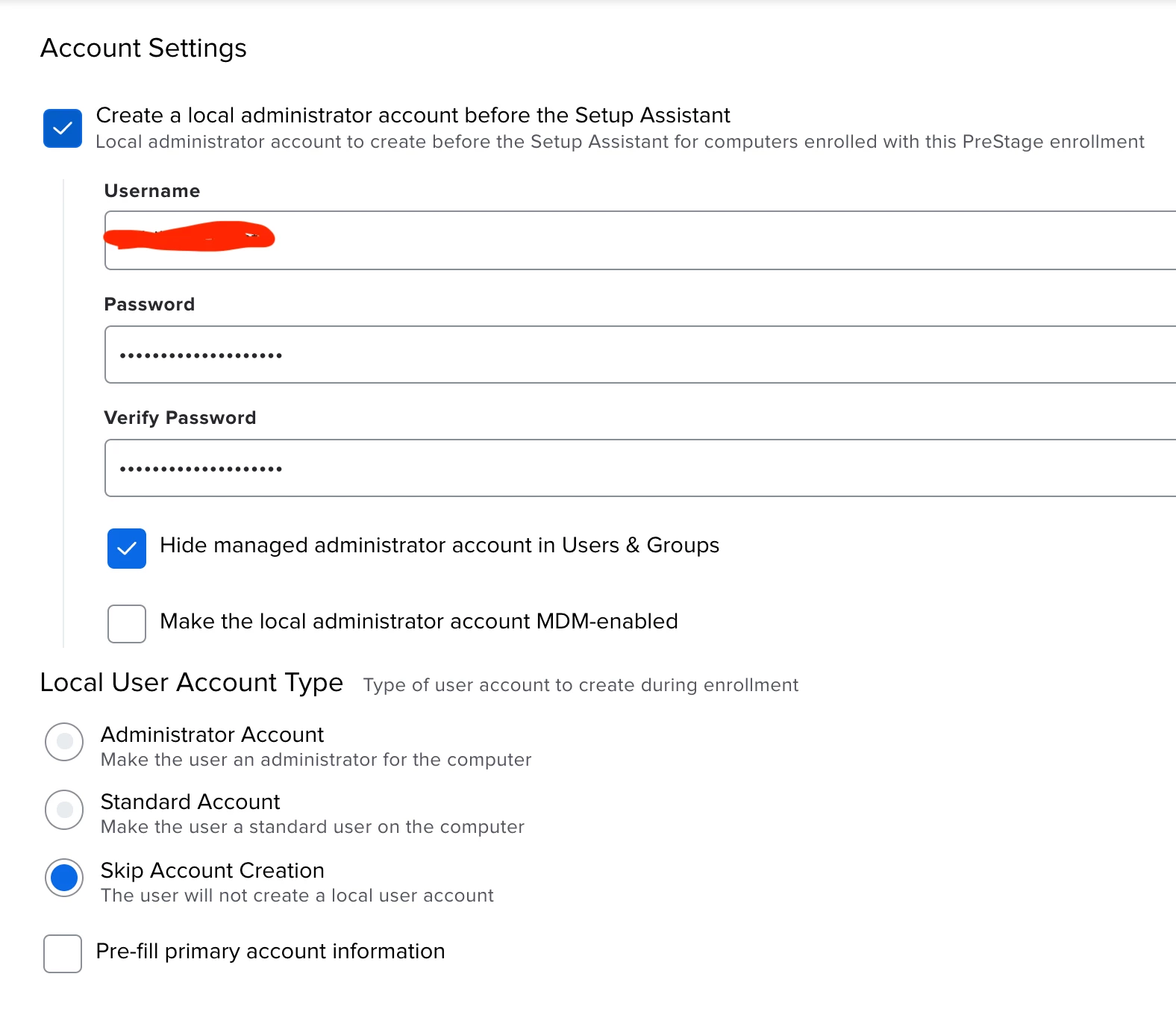

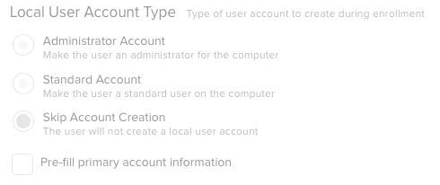

This used to work and it is all of the sudden not working, preference is, to create the admin account in the Pre Stage and then skip local account and when prompted by a login screen be able to login as the AD user. As stated this was working, however it now is prompting to create the local user. Ideas?

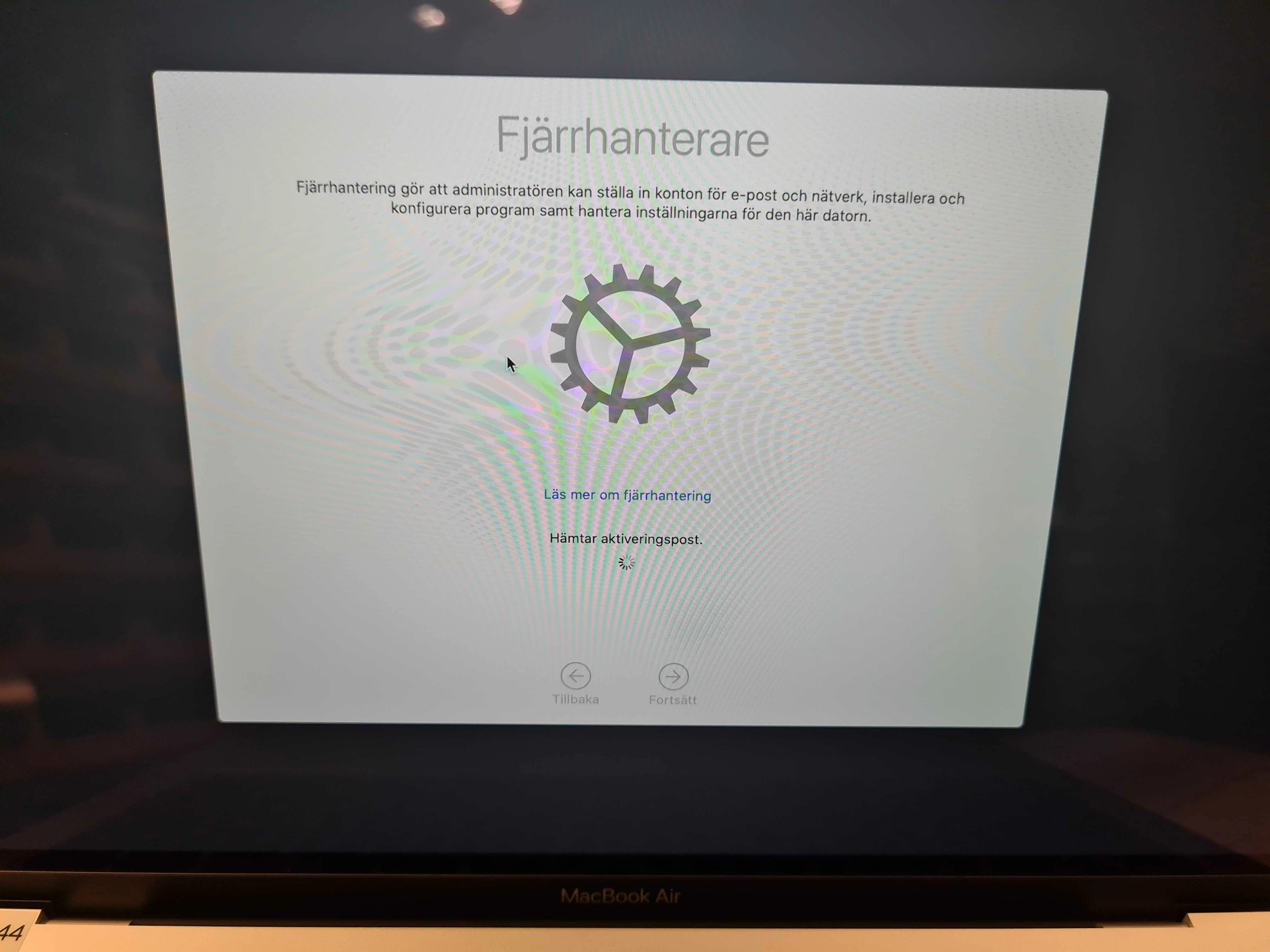

We have been seeing this since december 2020. It happens on 2 of 3 machines. Macs often needs to be reinstalled multiple times before enrolment success.
We have a support case at Jamf regarding this – so far without any success.
Our setup
- Jamf Pro 10.26.0
- Skipping Account Creation in PreStage.
- PreStage PKG installing Jamf Connect (tested with 2.0.2. and 2.1.2)

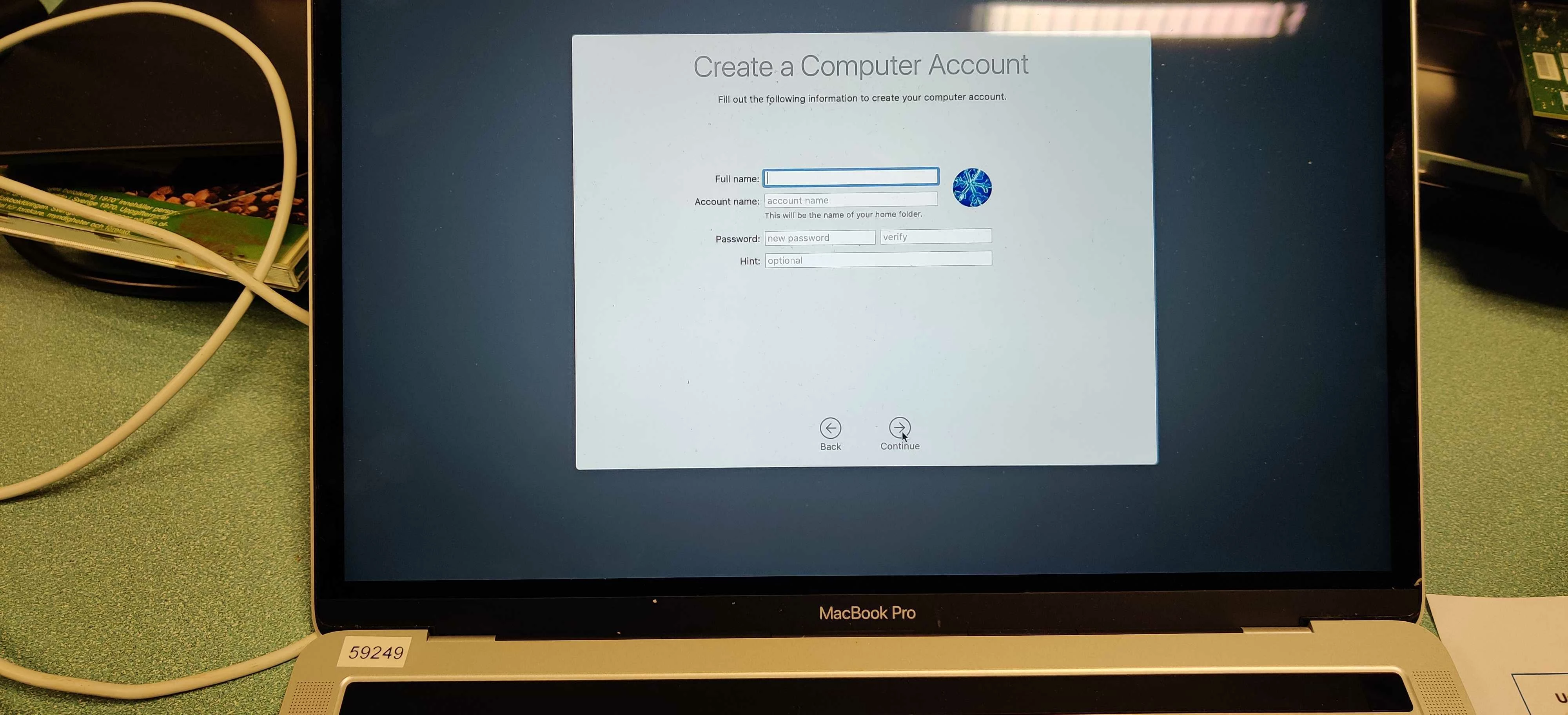

- After "Remote Management"-screen, "Create a Computer Account"-screen is shown.

ADE enrolment
Create a Computer Account is shown.
PreStage containing Skip Account Creation

Seeing this as well in an environment I manage. SSO works otherwise but we never see the SSO authentication appear at all in the Remote Management window; it just skips right to the Create a Computer Account screen. I would try to deploy Jamf Connect with the login window settings but that's a whole other ball of nightmares with Big Sur and I was hoping that this approach was going to be easier to implement.

We had 2 problems in our environment. Once we solved those problems, the enrollments worked perfectly.
1. Our UIE management account and the local administrator account deployment through the Prestage were the same. We changed the local admin account to a new one (and of course randomized the pwd for the old admin account/current UIE account).
2. We had to untick some boxes in our Prestage for skipping OOBE screens. I don't remember which of them we unticked unfortunately.
After doing the above changes, our deployments go through every time without issues.
