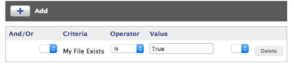

@monaronyc once you've created your Extension Attribute using the script that @bkramps posted, you would create a Smart Group looking for the result you want from that EA.
For example, if your Extension Attribute is called "My File Exists" or whatever, your Smart Group would look for true values in that EA:
Or if you wanted to know about that file missing, you could set the value to False.
