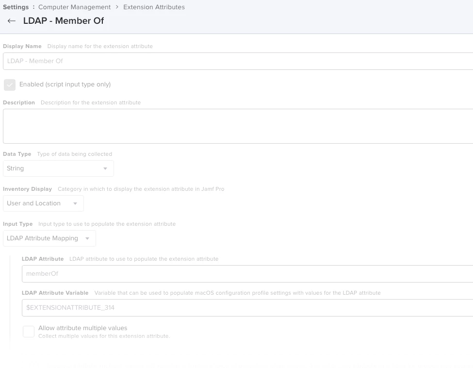

  • May 2, 2022
I am having trouble getting LDAP extension attributes and smart groups working. I'm attempting to use  "MemberOf". (See below). Should this show all of the AD groups the user belongs to? Is there a way to create an extension attribute to show a particular group such as "Is a member of marketing" ?
