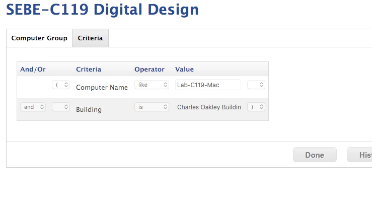

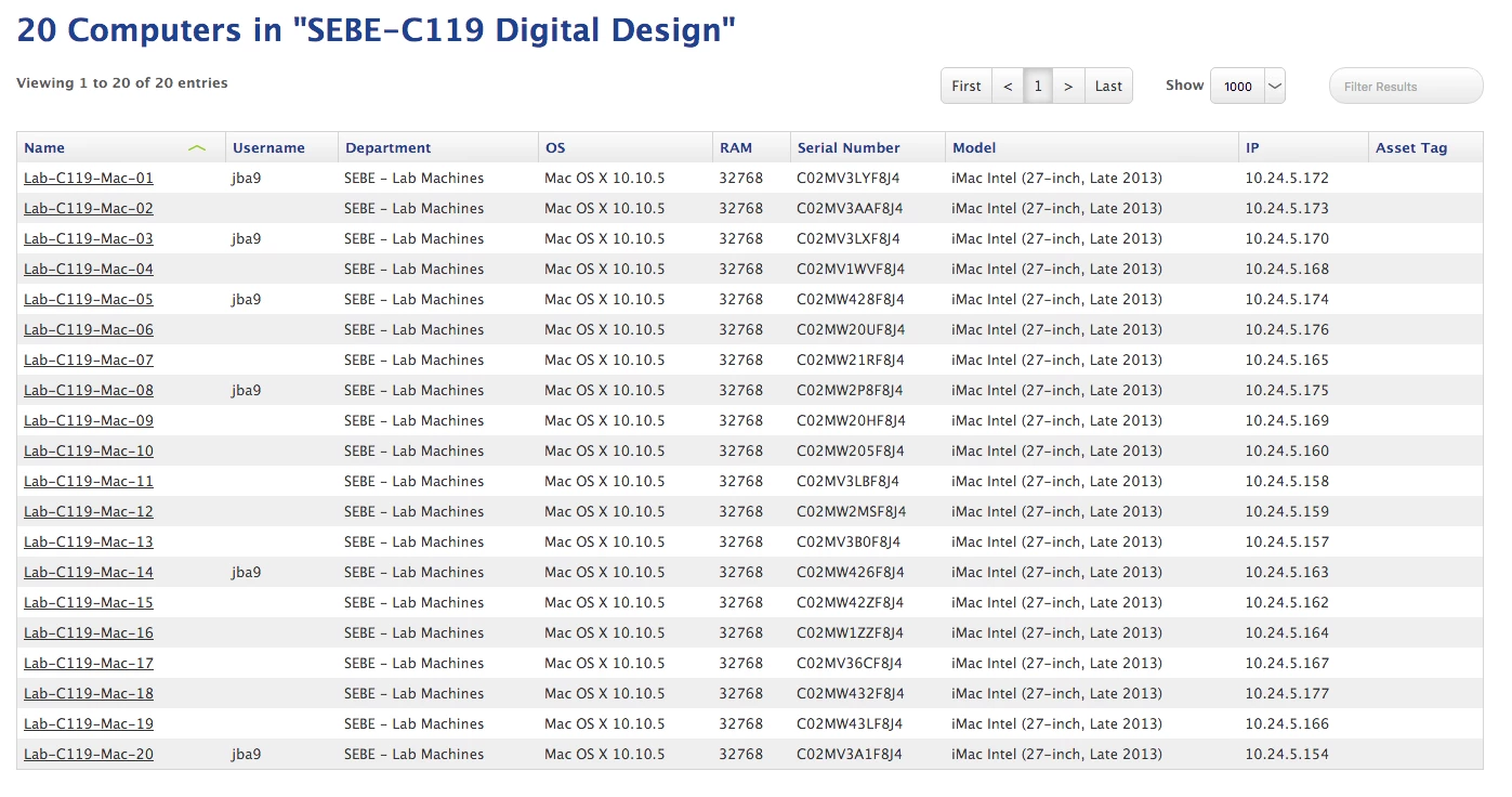

Need a little help with some smart groups; I have Labs setup within Smart Groups - "Lab-C119-Mac" This brings back 20 machines - like it should

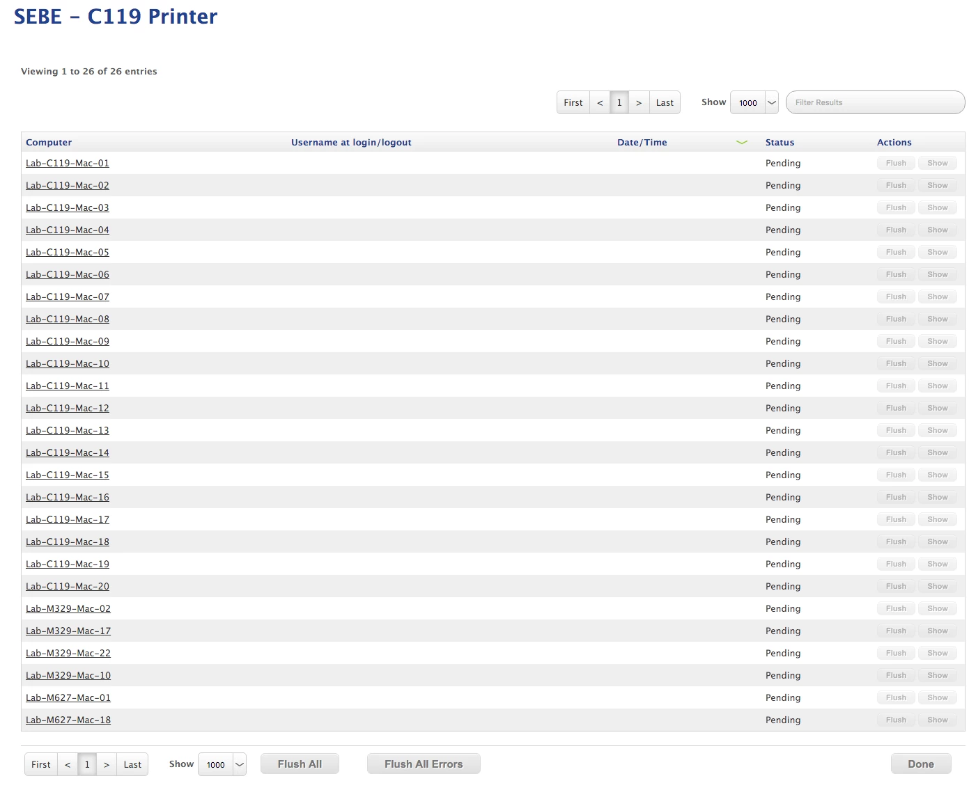

When I want to build a policy around this smart group - it always seems to gather machines from other Labs containing similar names, For Example: "Lab-Mac-M329-10"
I have even contained Lab C119 into its own building and again, the smart group looks correct, However I still have the same issue in Policies.

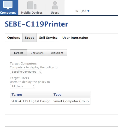

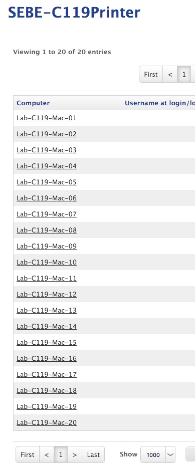

Screenshots attached
Thanks, Jeremy

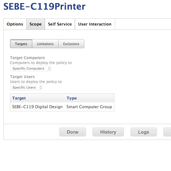

Best answer by Aziz
You'll need to change "Target All Users" to "Target Specific Users". That should show the correct scope.

@jacbgla can you show a screen shot of the Smart Group logic and the Policy Scoping including any limitations or exclusions in the scoping. That might help narrow down where the problem is.
  • January 25, 2016
Hi
Logic (All Machines have the correct building info)
Scope - No Limitations or exclusions are set.

@jacbgla the logic and scoping looks fine to me. That's really weird. Is it possible that the six computers containing Lab-M in their name could have been assigned Lab-C119 names and there is some corruption in their database records that would account for them showing in that smart group? Generally, for the handful of lab computers we have, we usually assign them to static groups and scope them that way. But your smart groups should work. Maybe your TAM has would have some idea about what could be causing the issue.

@jacbgla I might be wrong or just confused on this, but looking at your screenshots, I see the following:
Target Computers Computers to deploy the policy to [ Specific Computers ] Target Users Users to deploy the policy to [ All Users ]
If you only wanted to deploy this to target computers in the Smart Group I don't think the Target Users section should be showing up in the Scope section of the policy. I think its the fact that the Target Users is there at all and set to "All Users" that you are getting things off with the actual scope.
But since I'm not yet on JSS 9.82, may I ask what version you're running? Is this perhaps something new that shows up with 9.8x that I'm just not aware of? I can't even make a policy show both of those items like you have in your screenshot, so I'm unclear how it got set up that way.

@jacbgla I think @mm2270 is onto something. I didn't pay close enough attention to that. When I am targeting a specific smart group I have specific computers and specific users in the drop downs. Maybe if you change the users drop down to specific users that will resolve your issue.
  • January 25, 2016
  • January 26, 2016
Hi All
Thanks for all your responses. It looks like @Abdiaziz is correct, I am sure I have tried this before, nevertheless it seems to be working correctly now. Thankyou!
