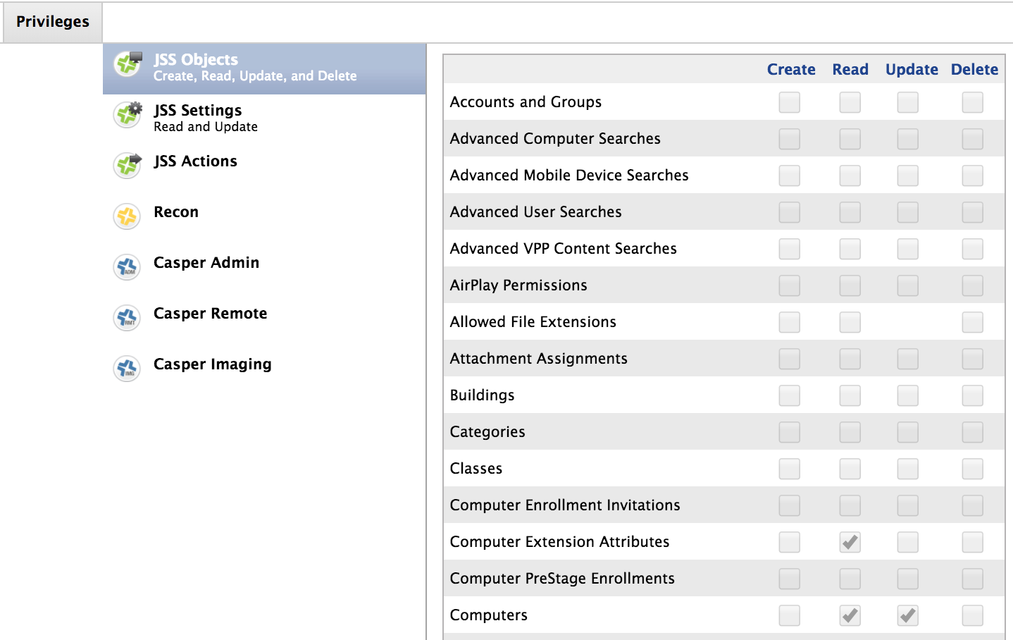

The Issue I have run into is the API user w/ the following permissions:
Read & Update permission for Computer Objects
Read permission for Computer Extension Attributes
I found Computer Extension Attributes but not Computer Objects, there is Computers but if I give this Read & Update permission the script fails at "Sending network location to Jamf Pro..."
If I give the API user full admin permission the script is successful, so just need to fins out what permissions the API account needs
Best answer by burdett
After much trial and error the permissions for API user are;
  • Read & Update permission for Computers
  • Read permission for Computer Extension Attributes
  • Update permission for Users
