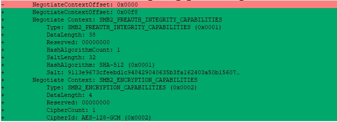

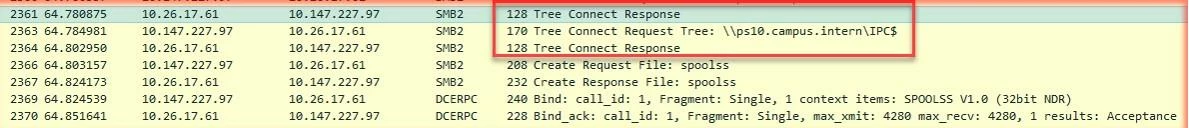

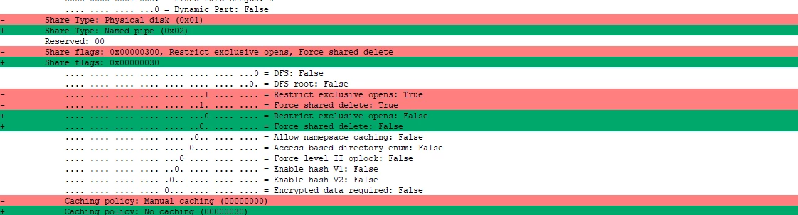

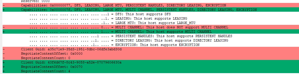

I got more details from our Wireshark traces.
  • The connection establishment of the SMB session is identical.
  • The NTLM protocol flow within SMB is identical.
  • The protocol flow for the SMB session is identical.
  • All SMB Capabilities are identical (MultiChannel, Integrity, Encryption, Ciphers, Nego, etc.).
  • The share flags, share capabilities and access mask are identical.
The standard macOS 12.2 client sends a "Tree Disconnect Request" ( with default printer URI), instead of a "Tree Connect Request" (with "encryption=no" addendum) - this is the only difference at the network level that causes the printing process to be aborted:
The comparison of the traces with the Finder access to the print server and the access via print management, however, shows some differences (on macOS 12.2 with default settings):
[  green = Finder access on print server  //  red = macOS printing  ]
  • Multichannel behavior:
  • Encryption capabilities:
  • Share Flags:
