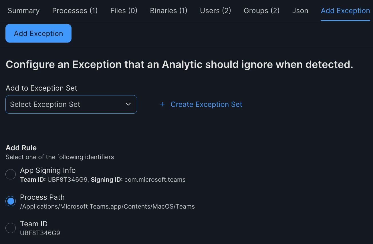

Have you tried going into one of the Alerts you would like to supress, and look into the exceptions section in the Alert itself?
See example below, you could do it on App Signing Info, if you would do TeamID you would safelist all the executables that are signed by a particular TeamID which might be to broad
Oh - nice.  Hadn't looked at that.  I will though.  I should be able to create an exception list for all of the "standard" installs. Then it would only hit on, well, others.  lol.  Perfect.  Thanks!

@don-f Well that or even better, you could easily safelist in that case the responsible process for installing the app bundle, Jamf as example!
  • Oct 13, 2023 4:37 PM UTC
That would be even better.  Save me time from going through every app and adding.  Thanks for the ideas.
