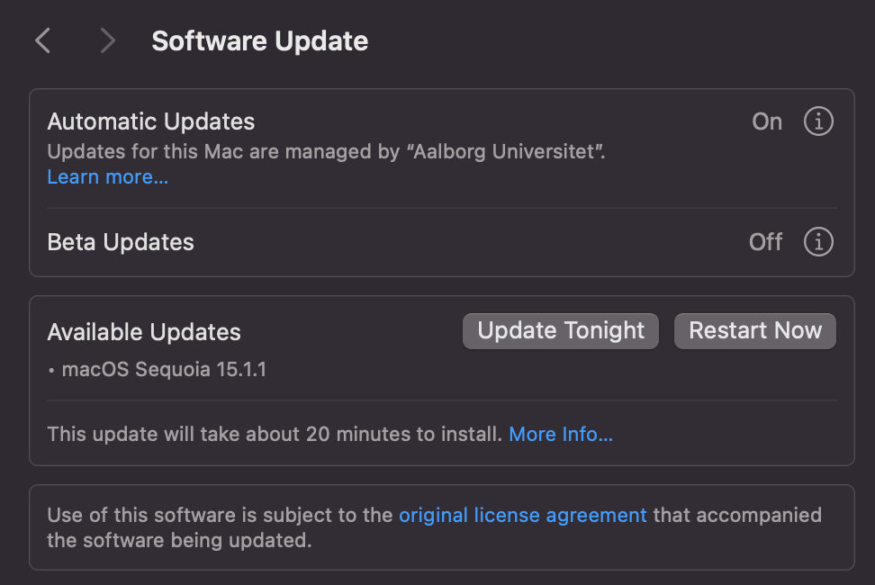

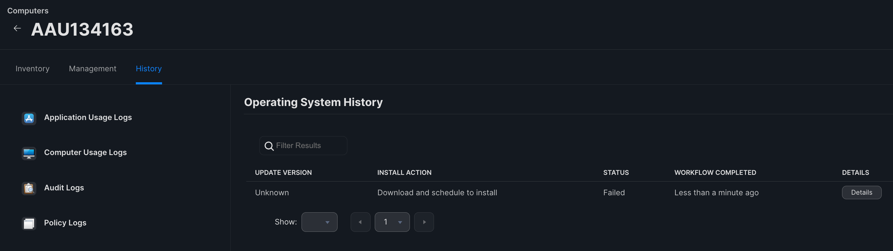

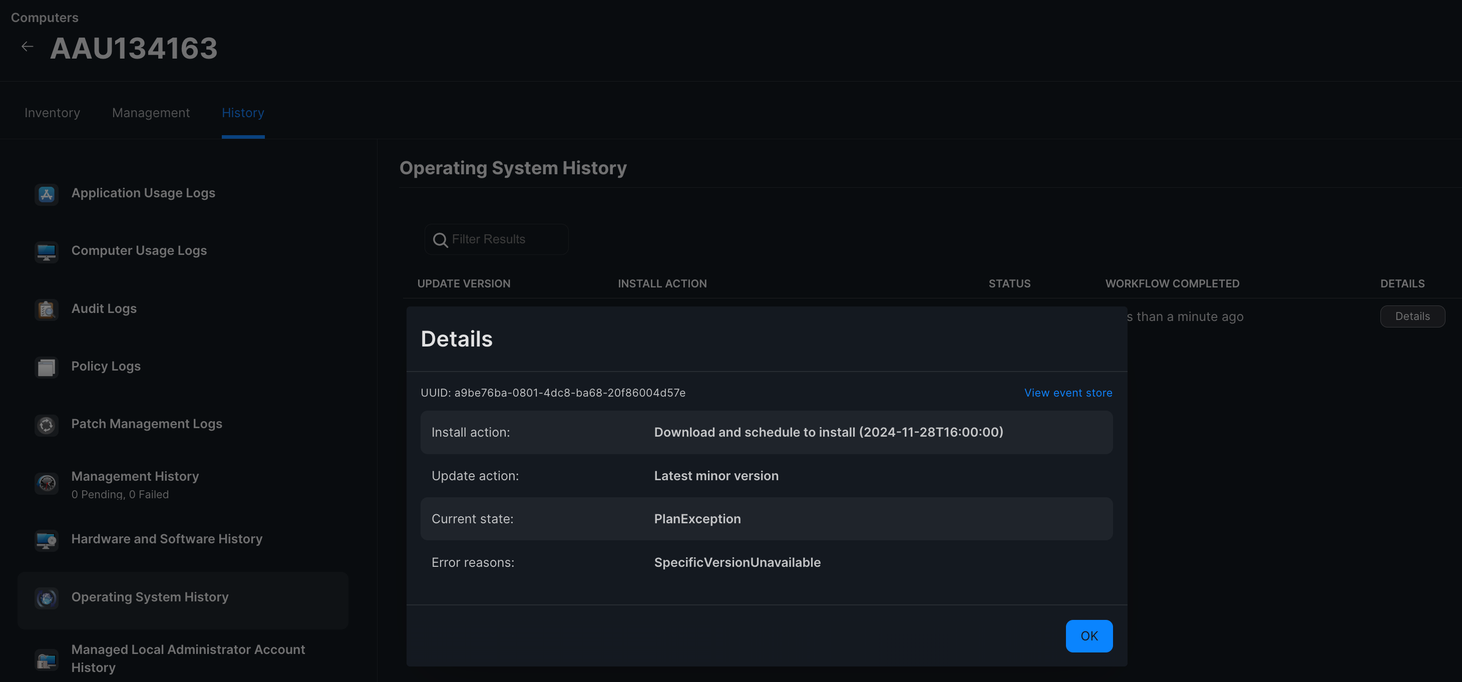

We are using the "Download and schedule to install" but we can see in the "Operating System History" that around 200 out of 650 Macs running Sequoia has a failed entry in the history. One of the errors we have not been able to find anything about is "Error reasons: SpecificVersionUnavailable" on a device running 15.1.0 and 15.1.1 is available in Software Update on the device. We are using "Latest minor version" when trying to push the install.
Anyone seen that error before and have a solution or reason for why that would happen?

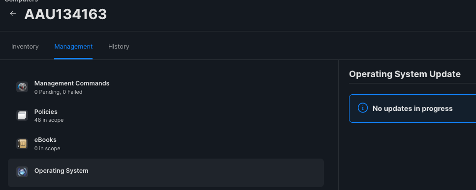

1. Click the Management tab Instead of going to the History tab. Click Operating System Update. Do you have a DDM log here or is nothing going on?

1. In the "Operating System" tab there is nothing, just "No updates in progress".
2. We actually tried that yesterday to clear the history as I read that in another post with another problem we also had. Looks like it has worked on most of the remaining Mac's. The deadline is set to tomorrow at 16:00, so we are waiting to see friday morning if devices have failed again. But this specific error I have only seen on one Mac so far (I have not gone through all 200 devices that had failed 😁)

The "SpecificVersionUnavailable" error may occur if the update hasn't fully propagated or is incorrectly flagged. Check device configurations and ensure network connectivity.

Sorry for the very late response. We switches to using specific version for the scope of our updates and that seems to work a lot better, but we still have some random fails that I'm trying to figure out. But at least I have not encountered that error since.
