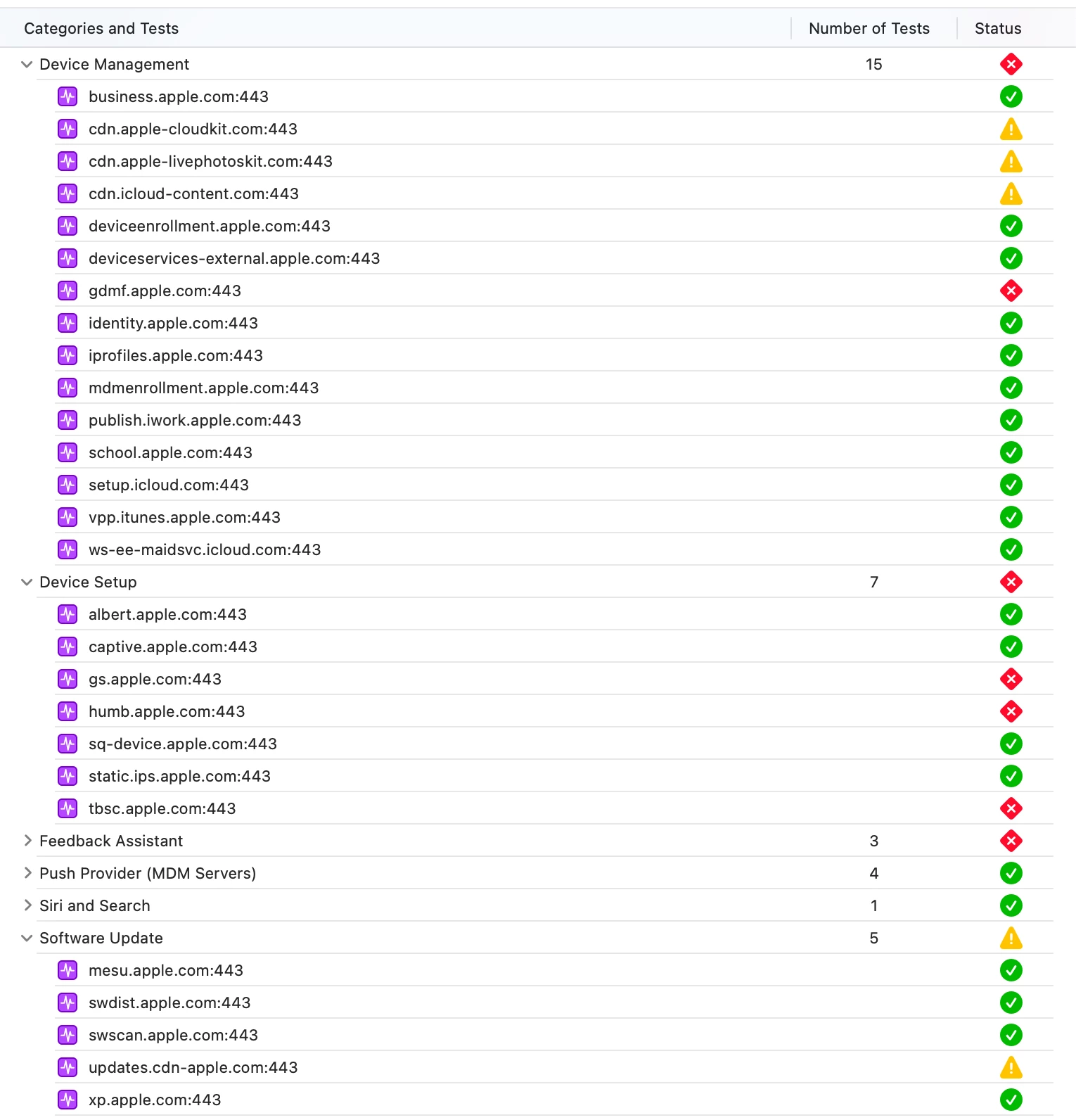

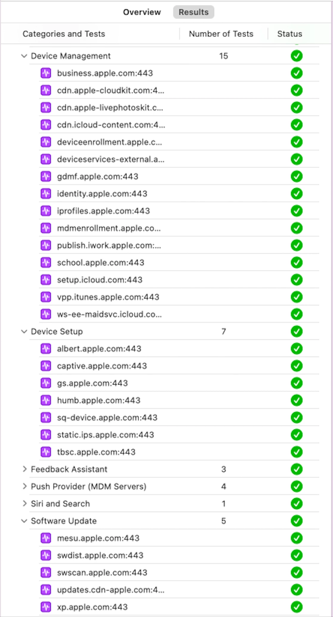

Yes I just need more information to narrow this down and understand better what is going on?
I am using Mac Evaluation Utility tool and here is the difference.
Mac connected to Internet:
Mac connected to Corporte Network:
It clarifies that mac isnt able to connect to certain Apple Domains.

I used the mac evaluation utility and found that gdmf.apple.com is blocked by the proxy, although apple domains are not blocked (no ssl intercepted) by our proxy.
We found out that gdmf.apple.com has no trusted issuer (cert-untrusted_issuer,)and is blocked by proxy.
Now I need to ask the security team if they can allow to exclude this domain from proxy.
