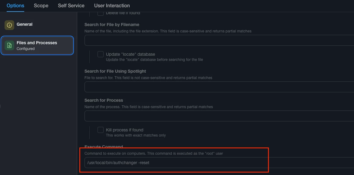

junjishimazaki
My org encountered the same issue so we set a policy to reset the authchanger. We had it execute the command: /usr/local/bin/authchanger -reset
It’s not a bash script but a File and Process. Set the trigger to Startup, Login, and recoccuring Check in.
