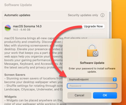

Posting on here since Sophos has been less then helpful, We installed Sophos endpoint wither their Ventura Config profile and it looks like it works and is functional. However when I go to do an update on the computer while logged in as the local admin no password is accepted. Also when I go to More info and then install through that window it locks SophosEndpoint as the user name and no password I try works there. I've attached a screenshot of the weird login window I haven't seen before

Looks like its performing permissions management over the softwareupdate binary. You will need to work with the vendor on this, even if they dont want to work with you. The application should be auto promoting this binary, and not prompting for anything so a rule is likely configured wrong.

  • Aug 1, 2023 8:35 AM UTC
How are you triggering the prompt? Ive not seen that before

@tycollins @s-mcc  anyone find a solution to this? I periodically receive the same error on Ventura.
@SCCM Initiating an OS upgrade from Settings will cause it:
