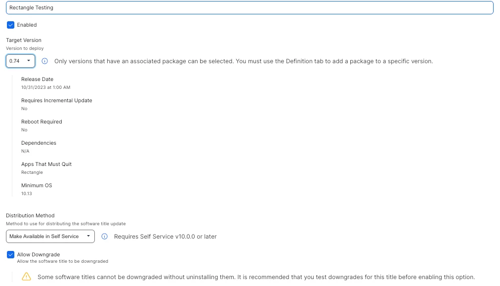

As long as you have the "Downgrade" option selected it allows you to revert back to any version you have historically maintained.
Certain apps may not allow it, but even then, you can still uninstall the app and reinstall it at the specified version.

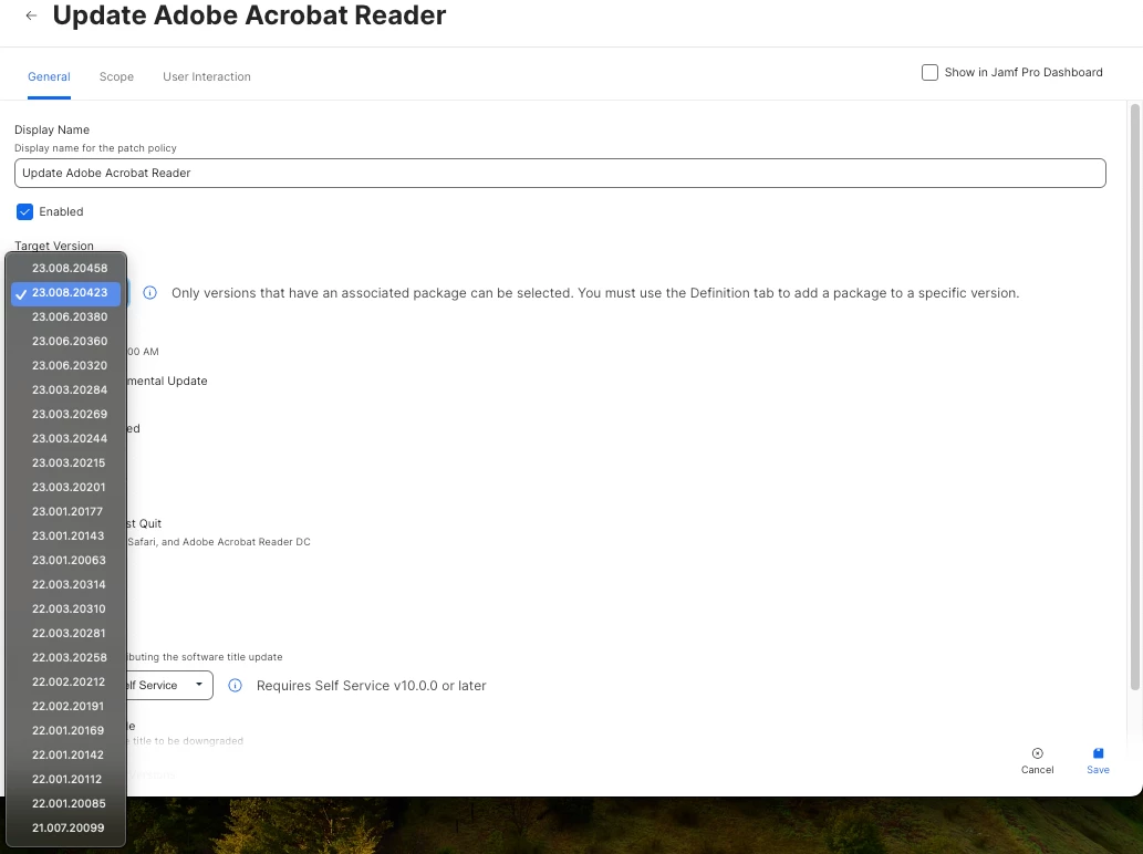

HI @Tribruin  and @lsv . If you enrol in the Jamf Pro 11.2 beta program you might find some more interesting information on this topic. Login to Jamf Account, click on the Feedback option from the menu and choose to enrol in the 11.2 beta. Once enrolled, the beta release notes will run you through the highlights of what is new.

11.2 was released today
https://learn.jamf.com/bundle/jamf-pro-release-notes-current/page/New_Features_and_Enhancements.html
I run through an example of how to use the new manual update version of App Installers in this blog post
https://www.jamf.com/blog/app-installers-whats-new/
