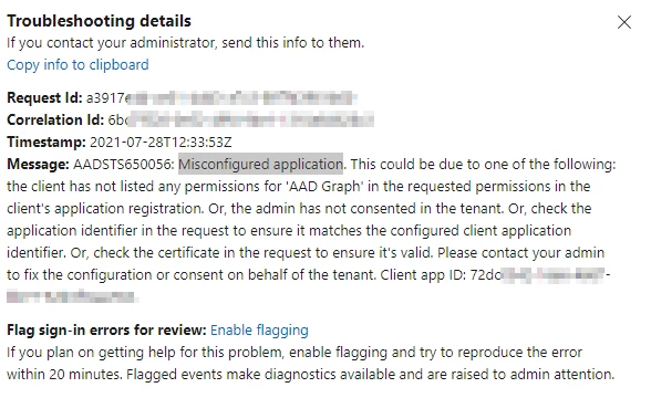

I am new here and just in the process of configuring Jamf Pro. Unfortunately I have problems with SSO configuration with AAD. When logging in I get the following error message.
What exactly do I need to do in AAD?
Thanks in advance.
Florian

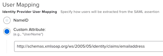

Ran into this issue myself when working with my Azure AD team. I opened up a ticket with Jamf Support and while waiting on a response I started pouring through the Jamf Pro logs and stumbled across what I believed was the issue.
In Single Sign-On settings under Identity Provider User Mapping, I selected Custom Attribute and set it to:
http://schemas.xmlsoap.org/ws/2005/05/identity/claims/emailaddress
Not sure if this exact line would help you, but you may want to check your logs and see.
Hope this helps as I spent weeks on this myself!
