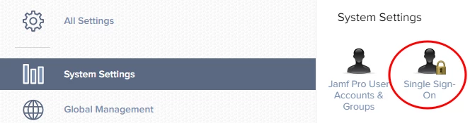

Yeah, this is a global setting.  Unfortunately you can't configure it as a per device setting:
Scroll down to Token Expiration Time Override:
Also, I didn't realise that the SAML default token expiry was 90 days. I couldn't find any info on that when I set SSO up, so that's partly why I just disabled it in Jamf. Thanks @cmcdonald89!
