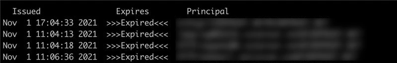

We have been using SSO Kerberos Extension with local accounts for a few months now (Big Sur). (Mac is not joined to the AD anymore).
It works fine, with one major exception:
If a user is connected to the corporate network for more than 10 hours, the Kerberos tickets expire and unfortunately are not renewed automatically!
The TTL period for a Kerberos ticket is 10 hours. This is normal. But if the user doesn't log out daily, he doesn't even notice that his tickets have expired.
You can delete the tickets manually in the terminal with kdestroy and recreate them with kinit, but of course most users don't know that. (Besides, this should work automatically).
I actually expected this SSO extension to notice itself when the tickets have expired and then automatically re-login to the AD in the background. (The credentials are stored locally anyway).
When connecting to the corporate network it does this automatically. Why can't it renew the tickets automatically?
Is this normal or have we configured something wrong?
Thanks for any hint!

I didn't think about it before, but you could also use the command 'app-sso -a $REALM' on a Mac with an expired ticket to troubleshoot it, since it would manually initiate the action of renewing an expired ticket using the SSO extension. If the command completes without errors and shows a Kerberos summary, it would seem that the SSO agent is not being prompted to renew the Kerberos ticket when it is expired, and the issue is likely internal to the Mac itself. If that command doesn't work, then you may have an issue in the environment that is causing it to fail.
I also discovered this option later and was already hoping that this would be the reason. We then cloned the profile (with this option enforced) and deployed it on some devices. Unfortunately the Kerberos tickets remained expired.
Thanks for you hint about the 'app-sso -a $REALM' command. Will try it as soon as possible. 🙂
We have about 400 Macs with Kerberos SSO. Many users report this problem to us. But most of them don't even notice it or they restart the Mac before the 10 hours.
In the same AD we have almost the same number of Macs without Kerberos SSO (classic mobile accounts). Of course, the problem never occurs there. (Or with a Screensaver Unlock you can quickly authenticate yourself again on the AD).

But I can confirm, that the kdestroy command alone (sometimes?) triggers a refresh/recreation of the tickets. Even if I don't use the app-sso --authenticate command.
