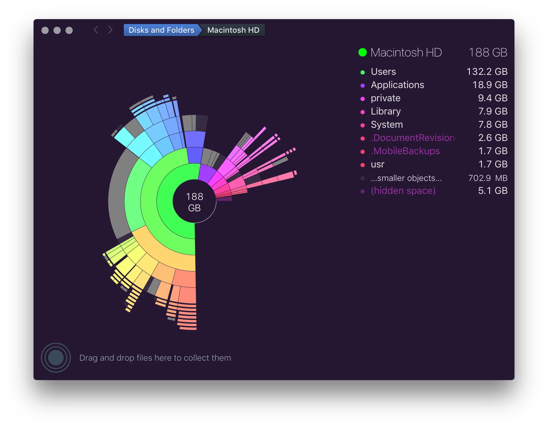

I keep getting Mac users that are getting the Start up disk is almost full message. When I look at the Storage tab in About this mac I am seeing around 50 to 80 gb if space being used by "Other". I tried using a program called daisy disc to help find what the "other" is. So far I have not been able to find what is taking up so much space. Has anyone else had this issue or have recommendations on places to look?

Are you downloading the web version of Daisy Disk? It has administrative ability to report on things that the Mac App Store version cannot due to sandboxing restrictions. If you have the MAS version, just move it to the desktop and then download the web version. It will see the MAS receipt and you can then delete the mac store version.
Look for "Scan as Administrator" and you'll know if local time machine snapshots are part of the "other" or if it's runaway logging or files in the system area. Most likely you should be able to correlate the total user space from /Users and subtract that from the total storage size to see how much space is "missing" in the overhead/system/non-user space.
