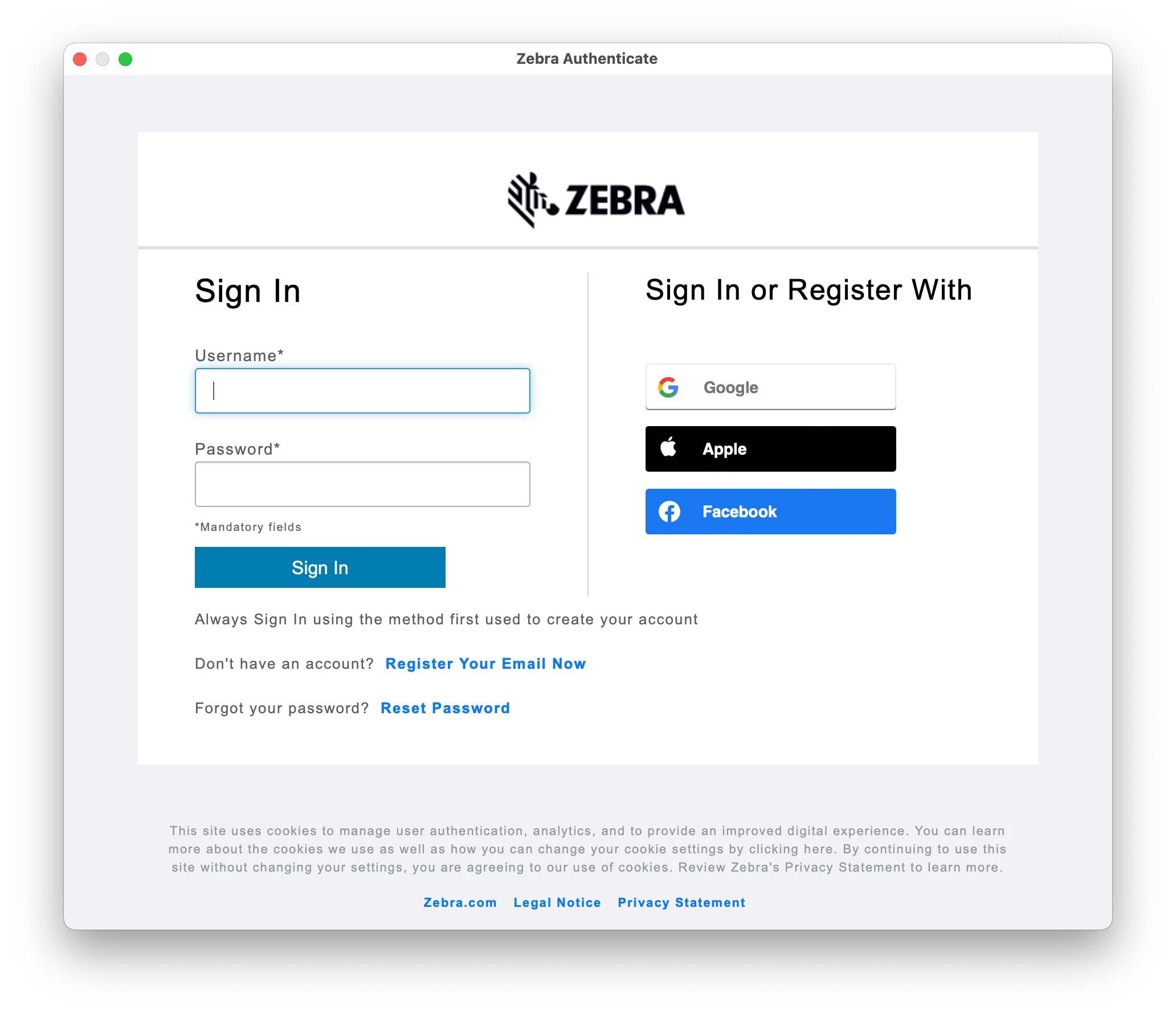

gskibum
If only I had known before customer made this purchase…
One has to sign in to an online account just to run the installer.
Maybe it's not too late to be returned.

garybidwell
  • Mar 3, 2023 2:28 PM UTC
Most of HP inkjet printer setup's are now like that, a right pain.

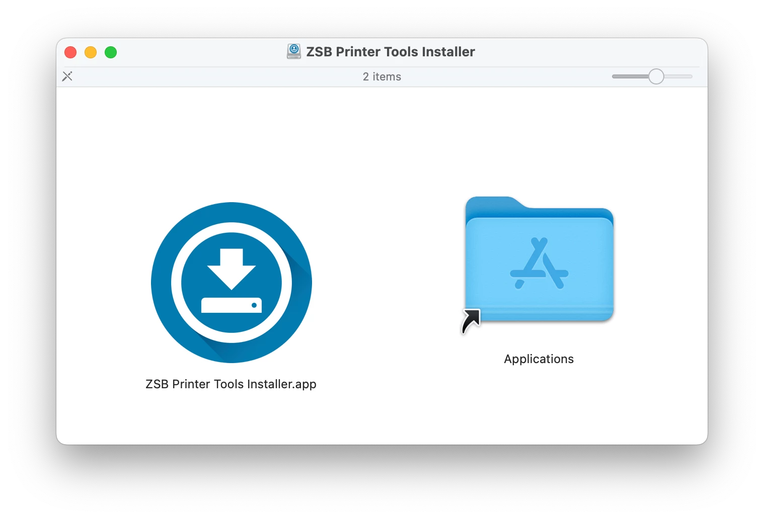

cdev
  • Mar 3, 2023 6:53 PM UTC
At one point, the Zebra tools were completely unnecessary to making the printer work. There are Zebra drivers for a couple of different protocols included with macOS and the printers can be setup manually. It might be worth looking at the setup with the tools and without - you may not need them. Once a working printer object is made, Jamf Admin can make a deployable printer queue.
AJPinto
  • Mar 6, 2023 3:03 PM UTC
This is the exact reason I keep hardware standards. "You" get what is on the list, or "you" are on your own lol.
Beyond reaching out to the vendor to see if they have an enterprise package you can try installing the package/application on your device, and the packaging the drivers from /Library/Printers/zebra and see if that is sufficient to deploy and have the printers function.
Zebra does have a post up telling you that you should use the CUPS drivers for Zebra printers on macOS. The article was recently updated and looks pretty well written.
IMPORTANT! Zebra suggests the use of the CUPS driver for use on macOS operating systems. The CUPS driver is pre-installed on macOS devices. Therefore, it is not necessary to download and install a driver for Zebra printers on macOS devices.
Installing a Network Zebra Printer on a Mac
