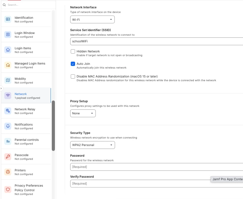

I’d go with a combination of Configuration Profile (Network) and a Script.
  1. Create a configuration profile for your school wifi network.
This will prioritize this network, but still allow for the device to join other networks.  When the device tries to connect to a network, if this one is there it should select it over all others.
  1. Create a Script that will check if the school wifi is present.  If it IS present then it will trigger the WiFi OFF and then back ON.  What that does is since the WIFI you want is present, the device turns off the WiFi, turns WIFi back on, and then connects to the most prioritized network connection.  Set the script to run at Recuring Check-in.
  2. TEST before implimenting.
