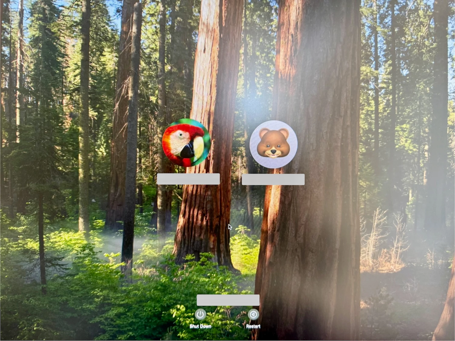

I'm seeing some strange behaviour with the login window on devices in one Jamf environment but not in another.

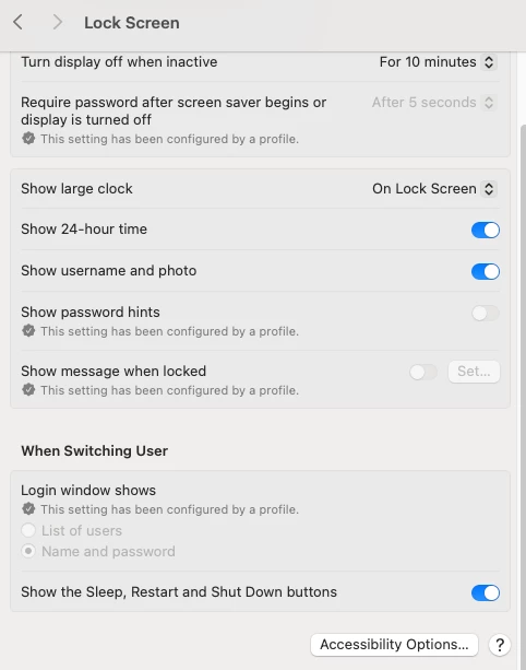

All machines have the CIS L1 baseline and some additional lockdown restrictions on them. They should be asking for the username and password at the login window on startup and after a logout.

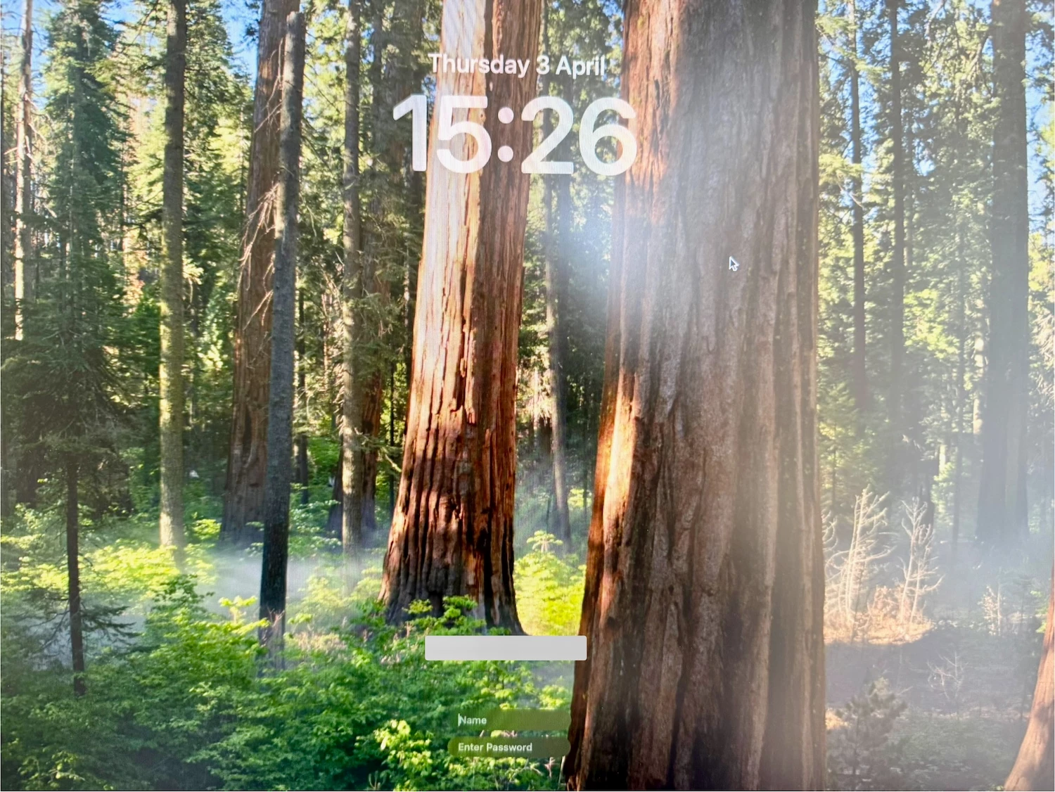

This works fine for devices in one environment but in the other I get the user account(s) listed on startup and only the password is required. It works as expected if you log out though.
I wondered if it was something relating to FileVault but, again, the configs between both Jamf environments should be the same. The only difference I can see is that one Mac is Intel (T2) and the other is M1.
Here are some examples of what happens on the Mac that isn't working as expected:-
Startup:
After logout:
Some of the settings applied:

i could be wrong but isn't this expected behavior for intel machines and filevault? This is  what I have seen this week working with intels again. 2nd screenshot is after logout and not reboot. didn't Rich cover this a few years back here
RDowson
  • Apr 3, 2025 10:29 PM UTC
Thanks! I did wonder if it was an Intel vs Apple Silicon thing. Looks like it expected behaviour then.
The one in the screen grabs is an Intel machine so that makes sense.
