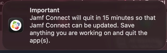

Hi, anyone know how I can suppress this notification, what should one configure in the configuration profile? I think it might have something to do with the management action app, based on the icon. I’ve configured a Management Action profile with a notifications payload a coupla months back but looks like it don’t work. I’m concerned users are going to start logging tickets for this

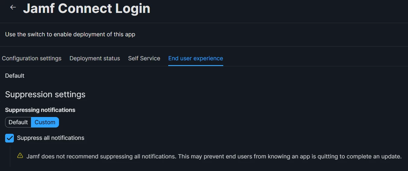

I thought so already. At the ‘End user experience’ you can make adjustments on notifications- or at the bottom disable it.

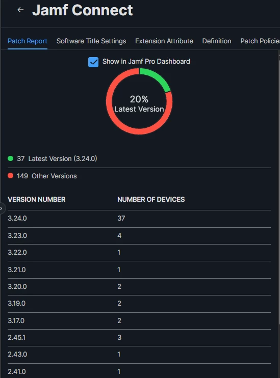

Hi ​@Cephas do you have it set up in Mac apps? Or where do you install Jamf connect?
  • Aug 4, 2026 1:18 PM UTC
Good question. I’m still somewhat confused where im deploying it from. Since that Self Service plus “integration” with Jamf Connect i started being confused. We’re using Mac Apps but I’m confused if it the same thing. If I click on the entry in Mac Apps and scroll down the version I see does not correlate to Jamf Connect and seems to be the same as Self Service+
But a coupla months ago I also configured a definition in Patch Management, so I’m confused where Jamf Connect is deploying from now. As this Patch Management option does seem to do the updates?
  • Aug 4, 2026 2:54 PM UTC
Thanks ​@peterlbk I’ve suppressed it now, despite that Jamf recommendation against it. Guess I’m just gonna have to see how it goes.

For Jamf Connect, I think you’re just fine to suppress the notification.
The login window is inactive until the user has logged out. There’s no need to alert anyone while logged in.
