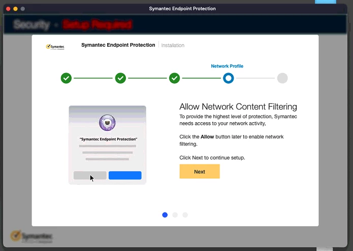

Hello All,
we are installing our latest SEP with version 14.3.3384 on Big Sur (M1 MacBook) however it is constantly asking to enable the content filter

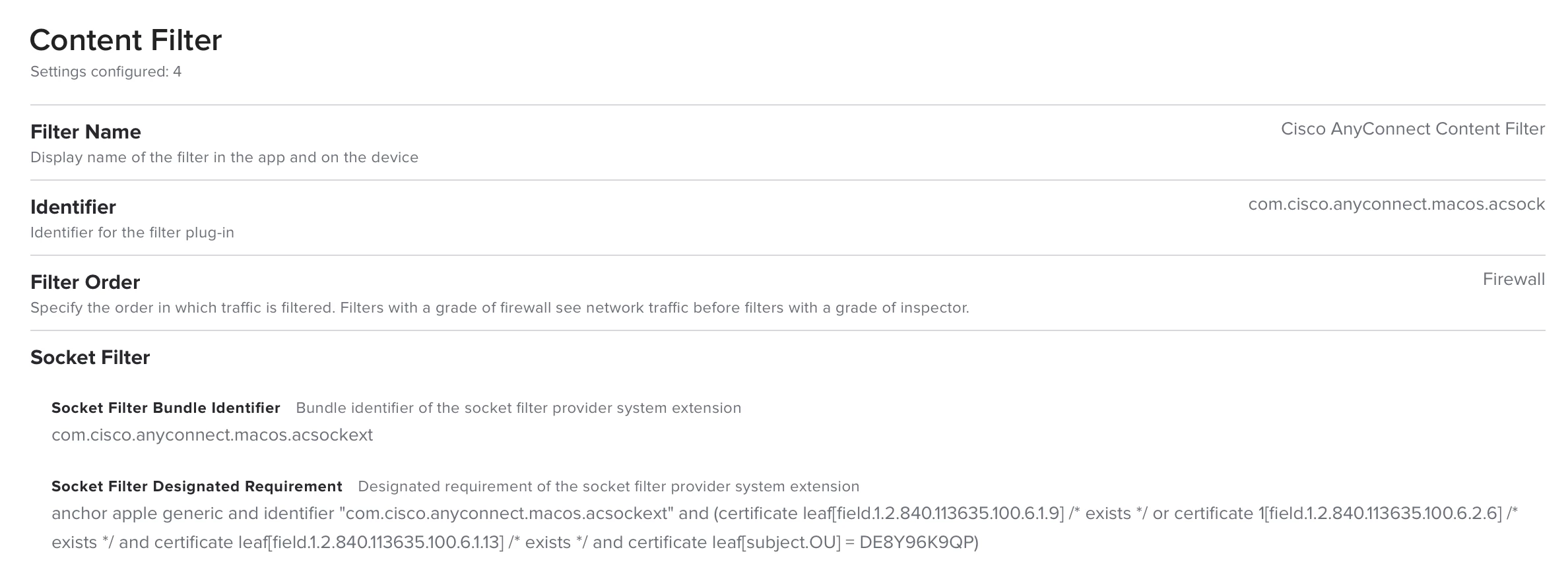

I know with Cisco AnyConnect as an example they have excellent documentation and I was able to get this resolved with a Configuration Profile. (https://www.cisco.com/c/en/us/td/docs/security/vpn_client/anyconnect/anyconnect49/administration/guide/b_AnyConnect_Administrator_Guide_4-9/macos11-on-ac.html)

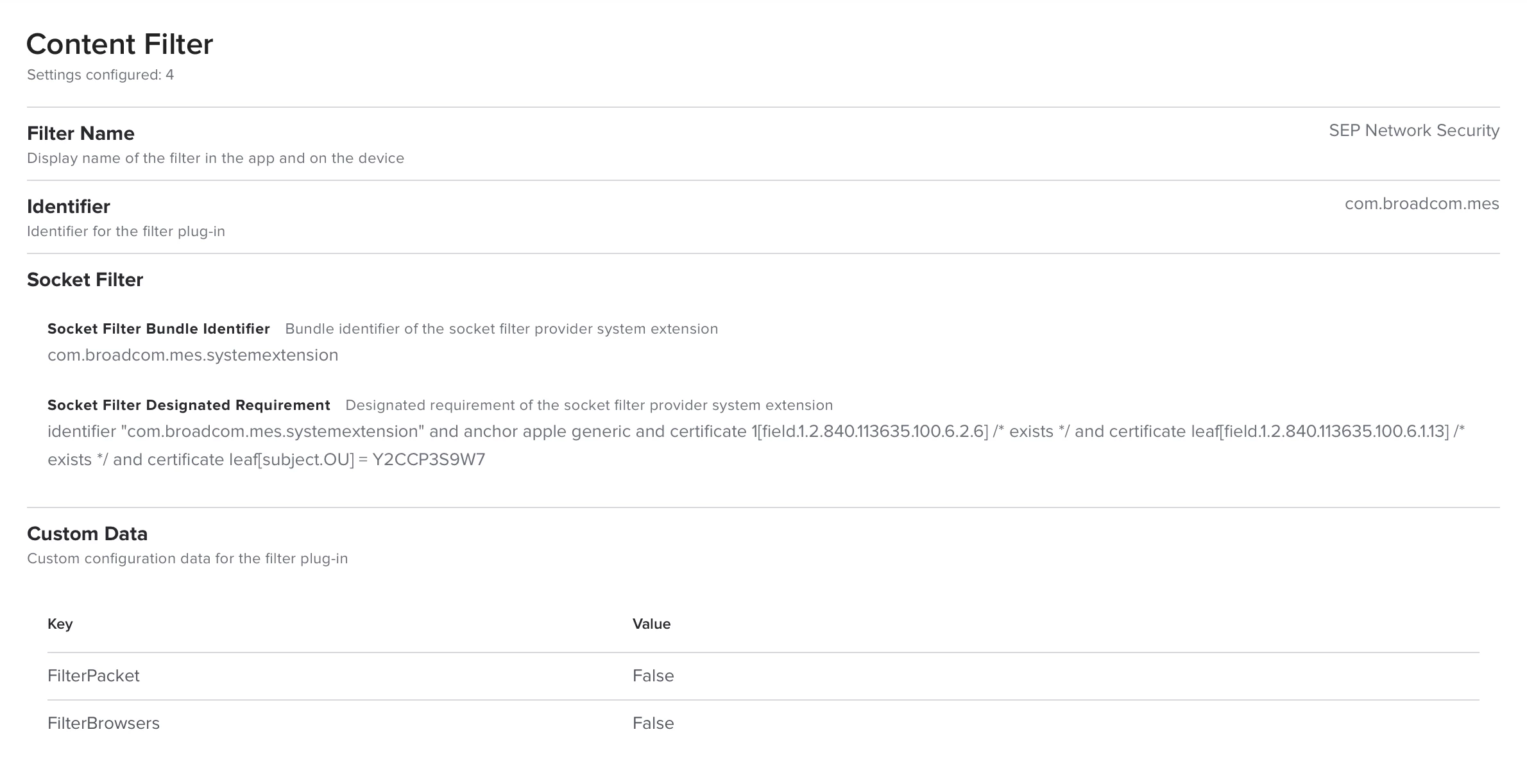

I am seeing similar. I made a Content Filter config profile for Broadcom SEP which is similar to the Cisco AnyConnect one, but with the com.broadcom.mes info, and while it will make the "You are not protected" notification disappear at profile install time, that message will come right back on reboot.
bwoods
  • January 4, 2021
After the content filter is installed, you'll get a prompt notifying you that "You are not protected". We found that you can prevent this by opening the app immediately after installation. It just seems to be a bug with this version that won't likely be fixed until the next version is released.

Here's what we get from the SEP guys:
https://knowledge.broadcom.com/external/article/176222
There is a profile to download at the bottom, but when imported into JAMF Pro, some areas failed to populate and so it wouldn't save. I got a call with them this week to get more info from them.
Btw, can you share the Cisco Anyconnect one you got to work? Thats next on my list of things to update.
  • January 4, 2021
Here is my working profile for AnyConnect 4.9.x. You need to make sure you have the System Extension approved as well.
