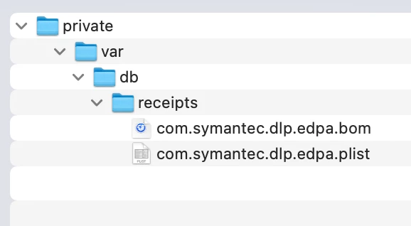

If you look at the readme file downloaded from SymantecRemovalTool, see if any of the files used by WSS are touched. I needed to keep DLP installed as well. All the DLP files stay in place so it continues to work. The only "gotcha" is that it will delete the receipts com.symantec.dlp.edpa.bom and com.symantec.dlp.edpa.plist which are both needed for the DLP uninstall_agent script to work. But you can add those files back in if you are needing to uninstall DLP.

@DBrowning perhaps you can provide direction on our situation. We are unable to remove DLP from our machines - both attempting the uninstaller that Symantec provides and attempting the workaround script found here on Jamf Nation. You mention adding the files back so that the uninstaller works - how did you go about doing this?

@josh.glenn I went to a machine with a fresh install and copied the 2 files the uninstaller look at. put them in a package and installed them. Then you can run the uninstaller without issue.
