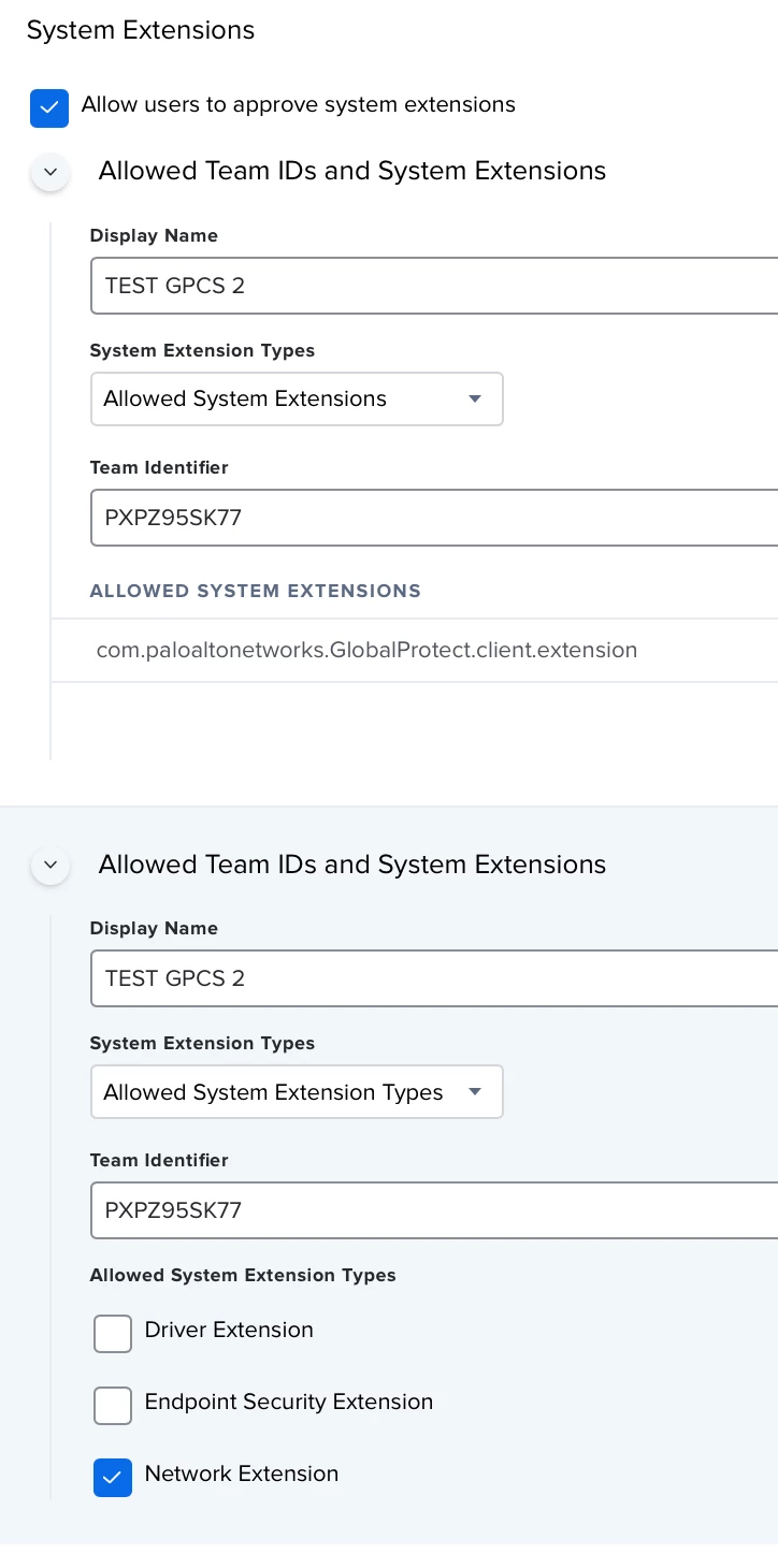

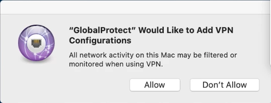

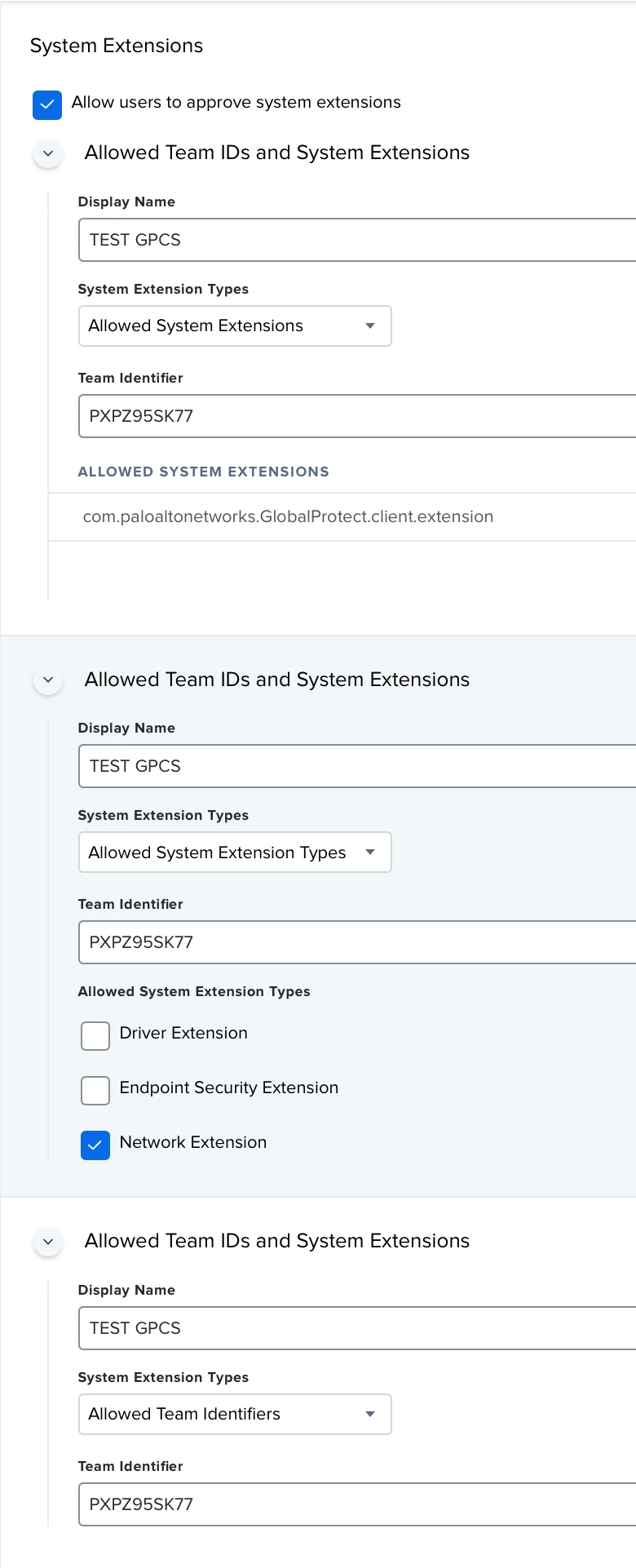

I'm working on setting up a policy for GlobalProtect 5.1.4 which switches to System Extension from Kernel Extensions.
I've set up a config profile to approve the system extension.
First I tried just the team ID, then I added the ALLOWED SYSTEM EXTENSIONS as well.
but when I run systemextensionsctl list I get
1 extension(s)
--- com.apple.system_extension.network_extension
enabled active  teamID  bundleID (version)  name    [state]
    *   PXPZ95SK77  com.paloaltonetworks.GlobalProtect.client.extension (5.1.4-45/1)    GlobalProtectExtension  [activated waiting for user]

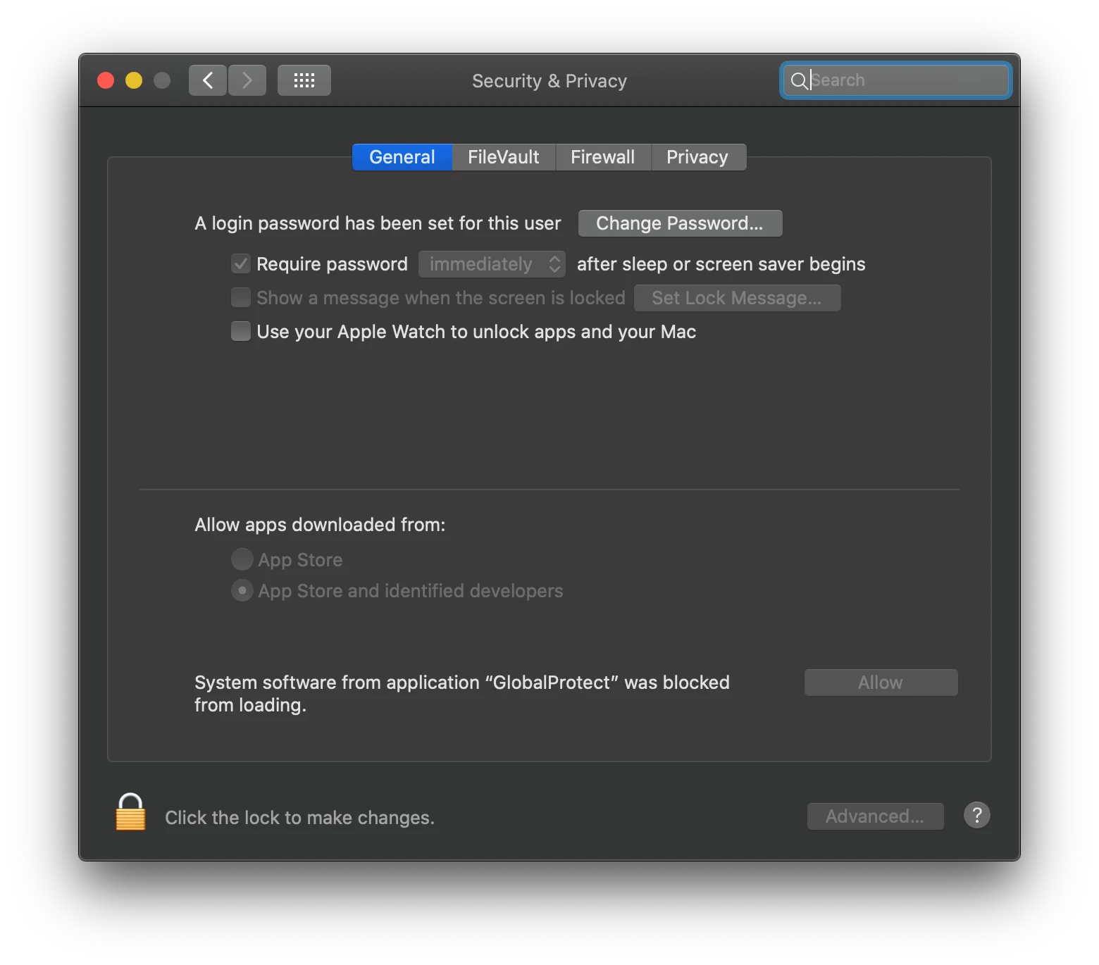

and System Preferences>Security & Privacy still has this prompt
How can I approve this for the user?

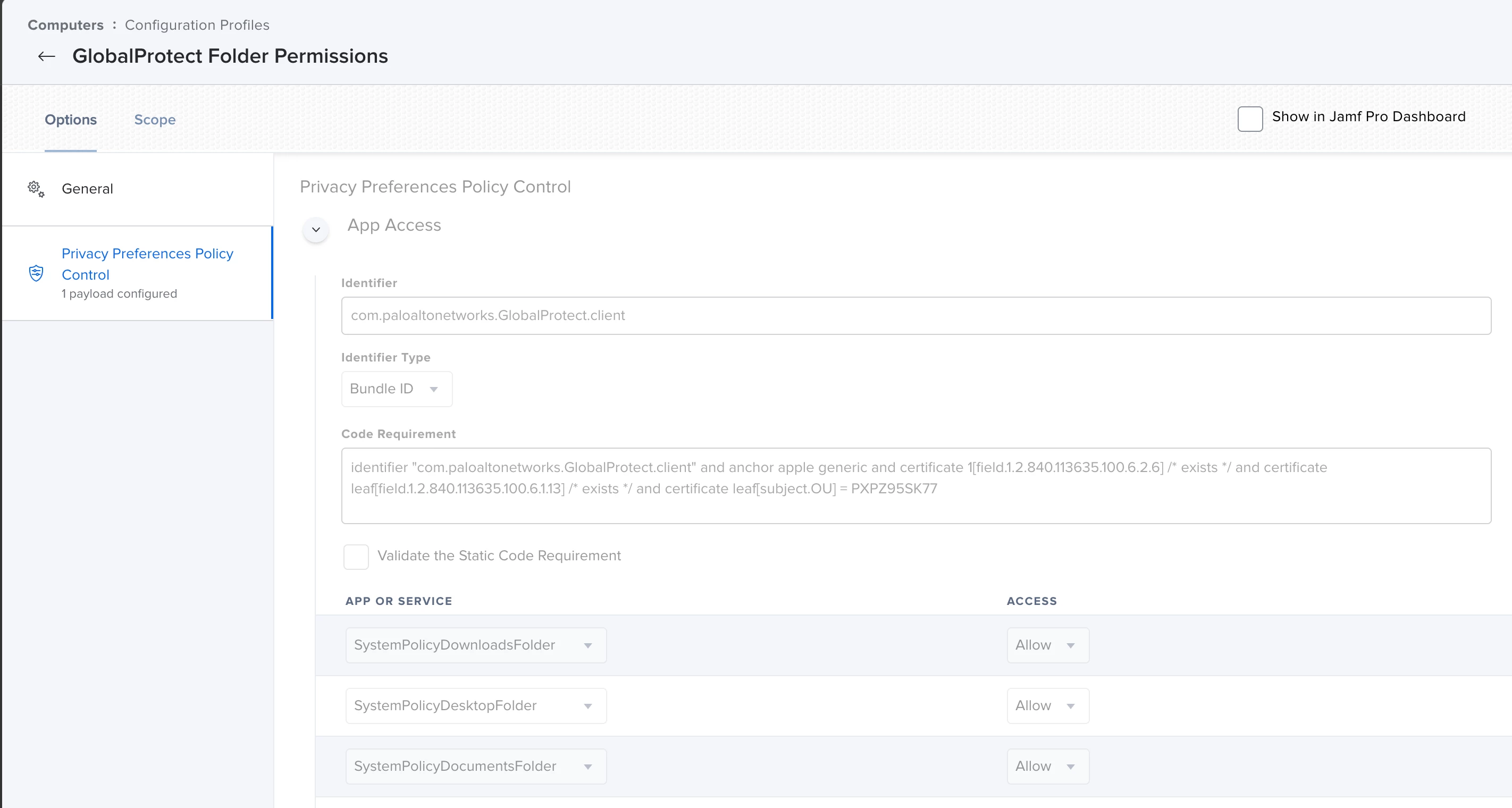

I tried a blanket PPPC config profile that just gave it all access, but still have that prompt.
Anyone know how to solve this?

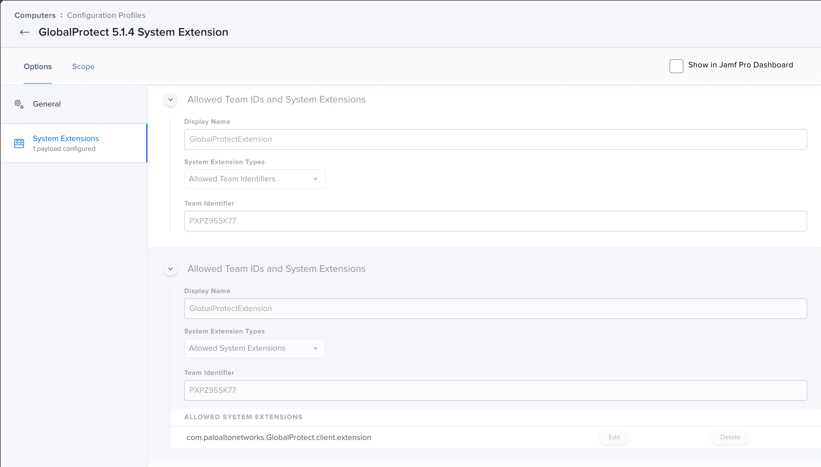

Unfortunately, yes. I'm also not sure 'blanket' system extensions work in the same way they do with kernel extensions.
I had to explicitly name the extension in addition to providing the Team ID.
  • Jun 13, 2020 5:38 PM UTC
Correct with SEXT both team ID and extension name, however its appears there in the profile, perhaps the 1st section of the profile that lists just the team id only should be removed, for GP 5.1.4 I only have the 2nd item in the config TeamID and SEXT named. and its working for me. of course I still have the config layed down prior to deployment as its needed. FYI I also still have the GP KEXT profile on these machines as we are in transition haven't tried clean in stall without that.
bradtchapman
Forum|alt.badge.img+20
  • Jun 13, 2020 9:13 PM UTC
Technically these are duplicates with conflicting permission. You may have been overly specific with the second item.
AFAIK the only reason to populate the "allowed system extensions" area is if you intend to whitelist only certain sexts from the same Team ID while blocking all other sexts. Inasfar as you trust the vendor, you should allow them all.
Remove the second payload and see what happens.

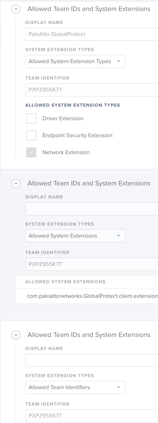

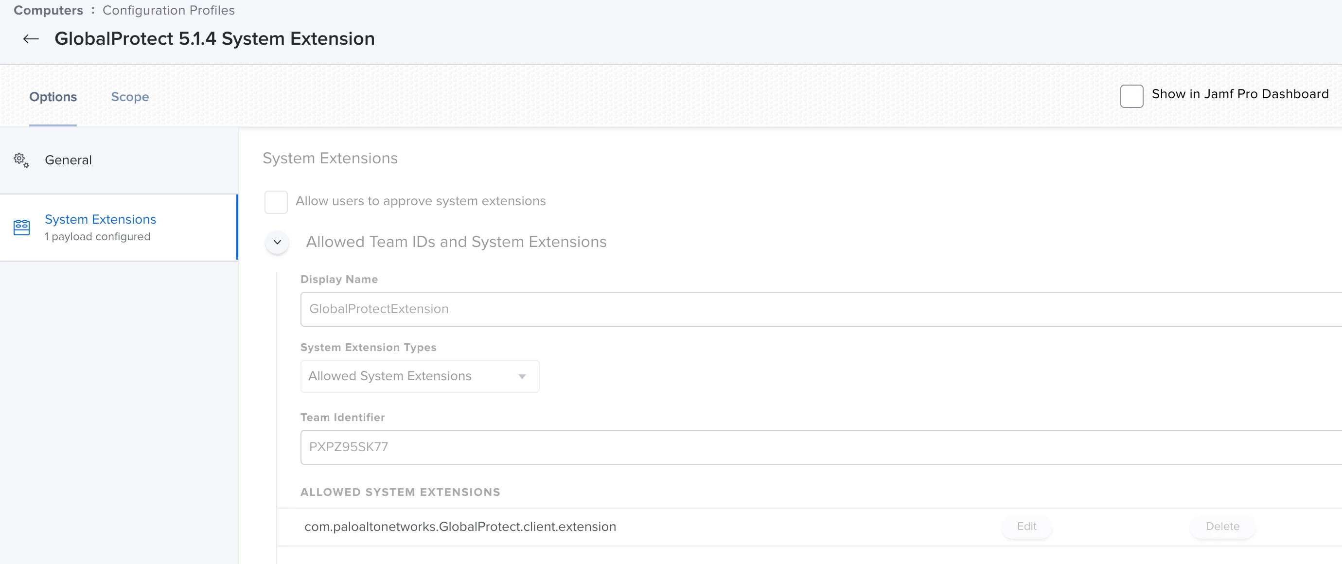

I believe for system extensions they can not be whitelisted with just team id (like KEXTS can be) they must Alis list the System Extension itself (so for me the 2nd part of the config profile with the names system extension com.paloal.xxxx must be used, it might not be working as the 1st part of the config profile lists only the team id and perhaps its getting stuck on that part, try a config profile with only the 2nd item listing the system extension by name and deploy system extension and install the app to see if it properly whitelists and enables the system extension
sdagley
  • Jun 15, 2020 4:55 PM UTC
Looking to see if there was an open PI regarding signed Configuration Profiles uploaded to JSS 10.21.0, I came across this PI for System Extensions that sounds like it might be applicable here:
PI-007713 Jamf Pro fails to include the Allowed Team Identifiers setting in the System Extensions payload of a computer configuration profile.
  • Jun 15, 2020 6:29 PM UTC
@jkryklywec @bradtchapman I used only the second payload, and also made sure the profile was installed before the software was installed and that seems to have resolved the issue. At least on my test computer.
  • Jun 15, 2020 8:16 PM UTC
I can get the extension trusted
but my issue is that end users will now receive a prompt stating ""GlobalProtect" Would like to Add VPN Configurations" with an Allow or Don't Allow button. I'd like to suppress that or automate the choice of "Allow"

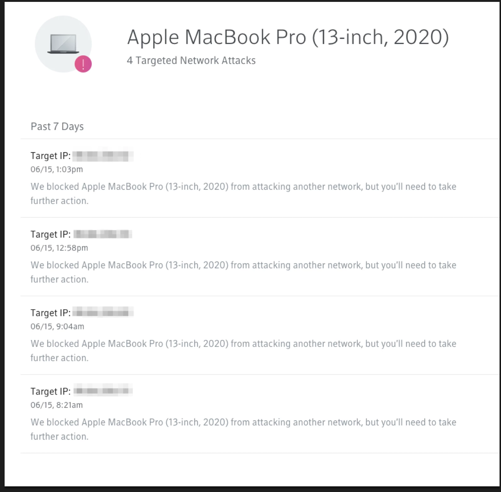

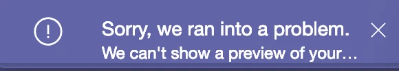

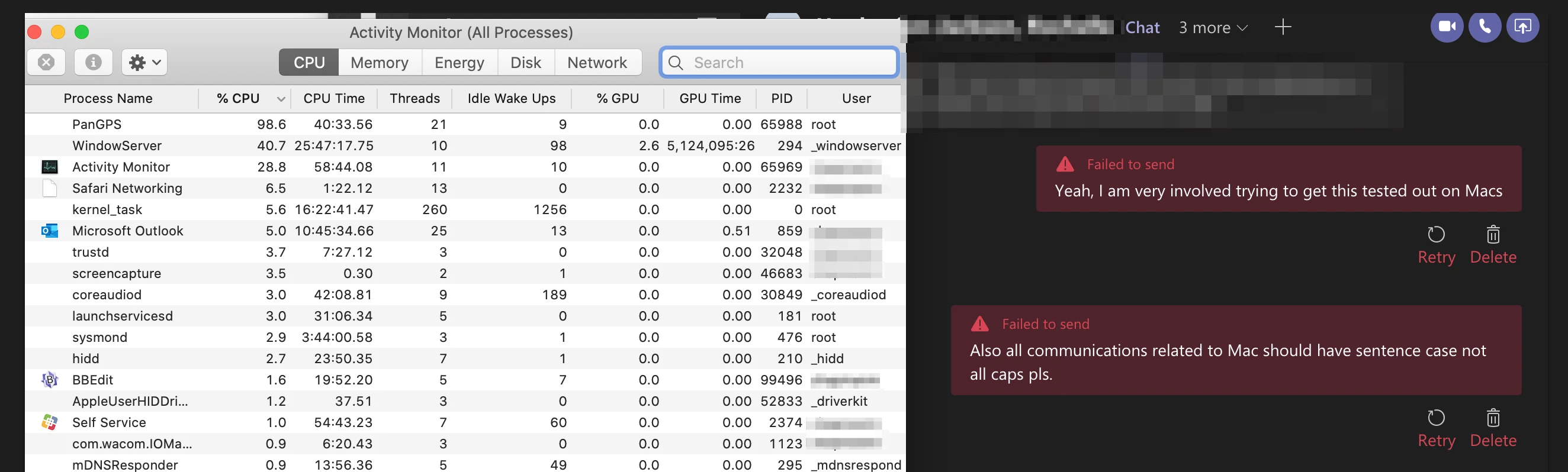

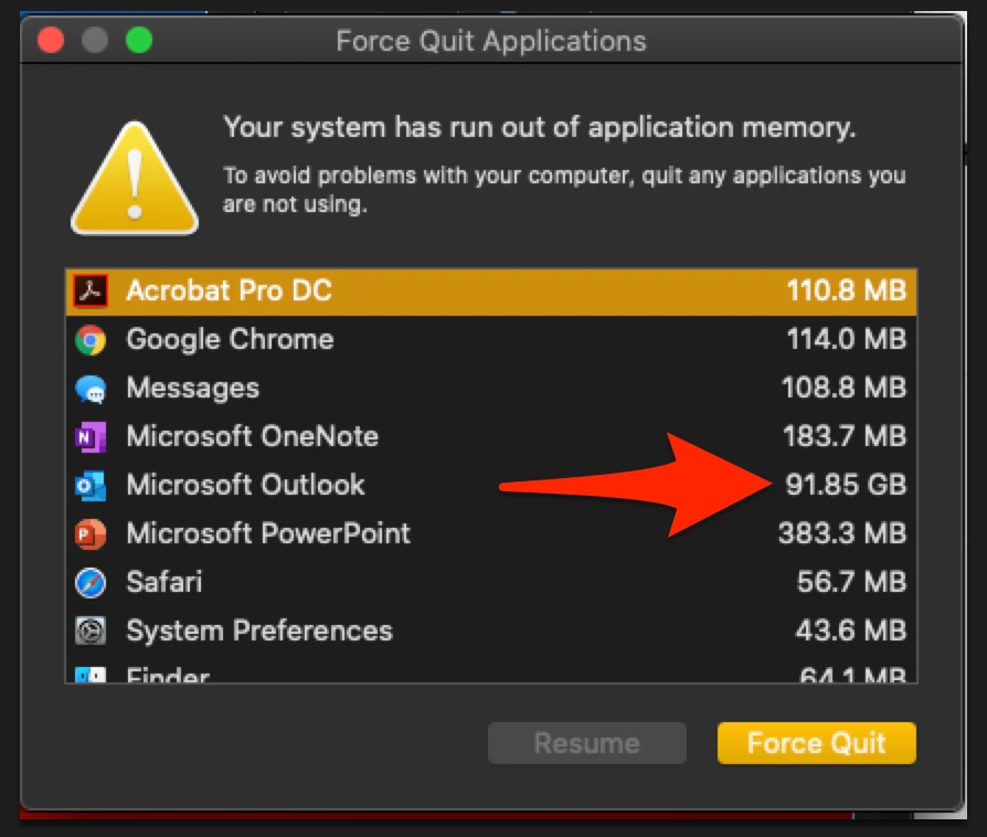

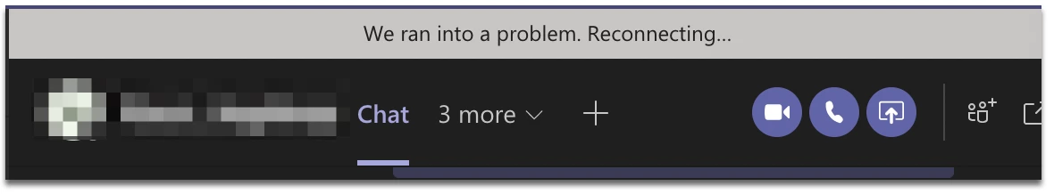

We started having issues with 5.0.8-4 and Catalina where any O365 traffic was having issues with Autosave (Word, Excel, PPT), syncing with OneDrive, Sharepoint (sites not loading), websites not loading completely, and Teams not sending messages. If the Gateway was changed or the GPCS was refreshed then the behavior briefly went away until the Gateway reconnected. Some days it was impossible to work, so I was able to disable VPN, but for end users, it's set to be always on.
I imagine that most users will just bypass autosave and save locally, which defeats the purpose of having OneDrive.
We opened a case with Palo Alto, Microsoft, and Apple. Palo Alto said it was a Safari issue. Microsoft confirmed that they use Webkit in their apps, Apple said, hey we'd love to help (and I don't know what behind the scenes things might be happening, but there is no partnership that I know of between Palo Alto and Apple, so its a crapshoot?)
One user got this from his ISP (COX Communications) along with his system warning him of his apps running out of memory.
So Moving to 5.1.4-45 was supposed to fix this issue, except that at the time our version of Jamf didn't support the System Extension payload and there was little or very hard to find documentation for Mac on Palo Alto's site. Until this weekend when we upgraded from Jamf Pro 10.13.1 to 10.22.1 (yeah, I know). Still, now that we have the payload, we reached out to Palo Alto once again for documentation on how to configure their stuff, and I feel bad for the engineer, who was very helpful, even though he ended up finding this same article. (Personally, I think the devs don't know that MDM also applies for Mac, but whatever.)

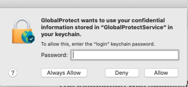

But there is also one other issue that I am chasing a screenshot of, which is a Keychain login prompt. I should be talking to the engineer again before the week is out. I'll post my findings here once I hear back.

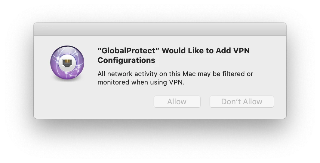

  • Jul 16, 2020 1:50 PM UTC
@daniel.behan @TechM I think the allow VPN prompt comes from GP being on the computer Before the system extension config profile. When that happens I uninstall and reinstall GP. (we have a Self Service policy configured that Wipes GP off the computer, and reinstalls it and sets it back up. So I just tell Users to click that button and it's stopped that "Add VPN Configurations" prompt 100% of the time.
Regarding the keychain prompt, the user just needs to enter their password and click always allow. There isn't really another way around it that I've ever figured out, and I've asked about it and looked into it a decent amount.

I've found the article that talks about the Keychain login prompt.
https://docs.paloaltonetworks.com/globalprotect/5-1/globalprotect-app-release-notes/gp-app-release-information/globalprotect-app-upgrade-downgrade-considerations.html
Among other things, it says: "The following Keychain pop-up prompt can appear if the Save User Credentials option is enabled in the portal configuration"

  • Jul 17, 2020 2:22 PM UTC
@strayer I'd be curious to see how to avoid the prompt to allow a vpn configuration. I get it every time, even installing manually. And now there's an issue with PPPC because the bundle ID changed from com.paloaltonetworks.GlobalProtect in version 5.0.x to com.paloaltonetworks.GlobalProtect.client in version 5.1.x
I was able to make another profile for version 5.1.x, but it only works for new builds, but not upgrades. When a user upgrades, the Profile isn't honored. I had version 5.0.x uninstalled, reset the TCC settings on the Mac, applied the new Profile, then installed 5.1.x and it still prompted.

@daniel.behan I'm really not sure why your experience is much different than mine, That prompt has only happened for us a few times, and each time our Reset GlobalProtect policy has fixed it.
I've attached screenshots of the 2 GlobalProtect related config profiles that are pushed to every Catalina Machine.
Our "Reset GlobalProtect" Self service option triggers 3 other policies in a row.

TechM
  • Jul 18, 2020 2:01 AM UTC
UPDATE:
Setting up two different Config Profiles to test with individually still has issues with connectivity with Teams and other internet connectivity. The only thing being managed at this point is the Config Profile.
The Mac is scoped.
Config Profile is verified.
Software is installed with the installer with the System Extensions box checked.
Both make no difference as it relates to performance.
CP #1
CP#2
We still see this prompt:
So then I looked in Little Snitch and I see this:
So that message is strange. I can't find any documentation on it. But I go and look at what's in that folder referenced above and I see each system extension for every time I installed GPCS. I tried uninstalling it while having it opened, and they don't come out. I tried deleting them myself and I get this message:
It was almost 1AM so I called it a night. I'm at a total loss here.
  • Sep 21, 2020 7:53 PM UTC
Curious if anyone has managed to stop this VPN prompt from coming back up?
  • Sep 21, 2020 8:30 PM UTC
@aarron.tilley https://knowledgebase.paloaltonetworks.com/KCSArticleDetail?id=kA14u000000HAW8 there are 4 config profiles linked on the article on their support site. I looked at the name of the network configuration (GlobalProtectDo) that the pop up was making and matched it to the one made by one of the config profile. (GlobalProtectSplitTunnelDomain) and that solved it for me so far. Hopefully that solves it for good.
Thanks @strayer, that did solve it for me
