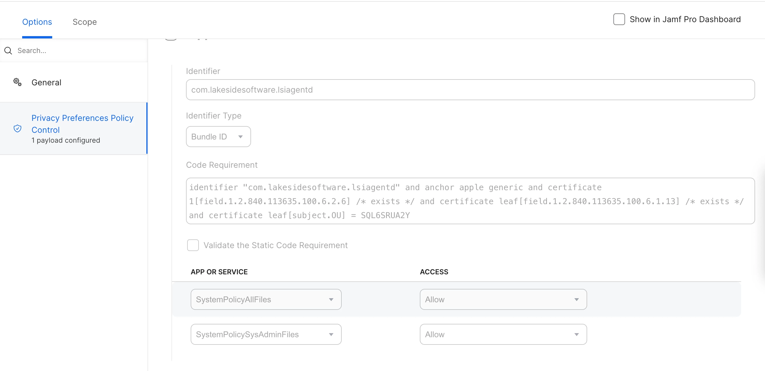

Can you please post screenshots of your profile payloads? They could help us figure out what may be wrong.
  • Dec 27, 2023 5:10 AM UTC
@howie_isaacks please find the screenshot per request
howie_isaacks
  • Dec 27, 2023 5:43 PM UTC
This looks correct. What you are seeing is the on/off switch for full disk access is not toggled to on? I have noticed that some of my agents for which I created profiles to grant them full disk access show the on/off switch toggled off even though I know the agents do actually have full disk access. I used Jamf's PPPC utility to generate the code requirement.
@howie_isaacks I agree with you because when manually create a profile in Intune for Mac for full disk access, I couldn't see the profile under profile section. Later, I used PPPC utility from Github and upload the .mobileconfig in Intune. Immediately able to see the profile under profile section. However still toggle off, but I could see that agents are having full disk access.
