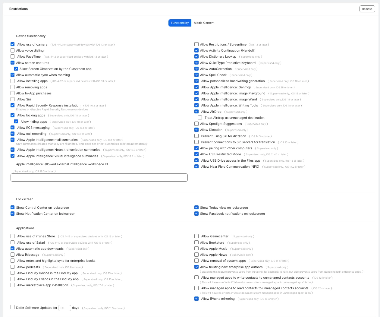

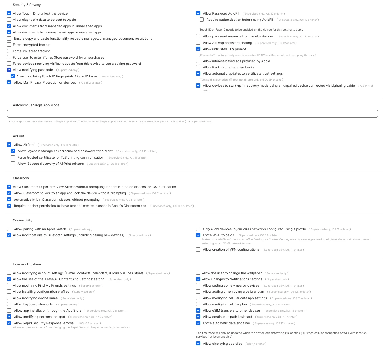

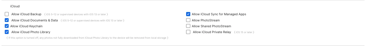

I am attaching screenshots of the profile for restrictions, i don't think this is the problem. We don't use Single App mode or Guided Access as far as i know either. Thanks for the input nonetheless.
