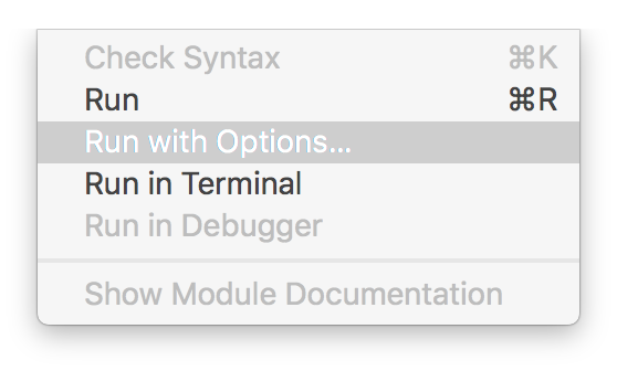

Coderunner can also be useful to write and Debug Scripts. https://coderunnerapp.com
  • May 31, 2018 11:52 AM UTC
I highly 2nd the recommendation to learn with coderunner, really quick for testing any scripts and code locally and debugging

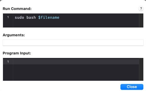

jkeller13
  • Sep 5, 2019 7:10 PM UTC
@skinford & @claudiogardini - You can run the script with sudo using CodeRunner. With the script open, go to "Run Settings" in the top left corner, and change the 'Run Command:' to add sudo in front.
1 | bash $filename       changes to        1 | sudo bash $filename
This is per script window, though you can change the default setting to include sudo as well.

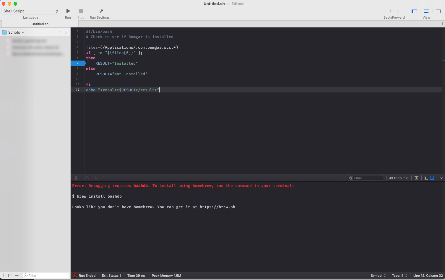

  • Mar 17, 2022 9:31 PM UTC
I am getting error when running this with sudo
jkeller13
  • Sep 27, 2023 12:07 AM UTC
Never saw this reply until now, my apologies. If you didn't figure it out, that's because you set a breakpoint at line 7 for the debugger. Un-click the blue mark on line 7 and you should be good.
