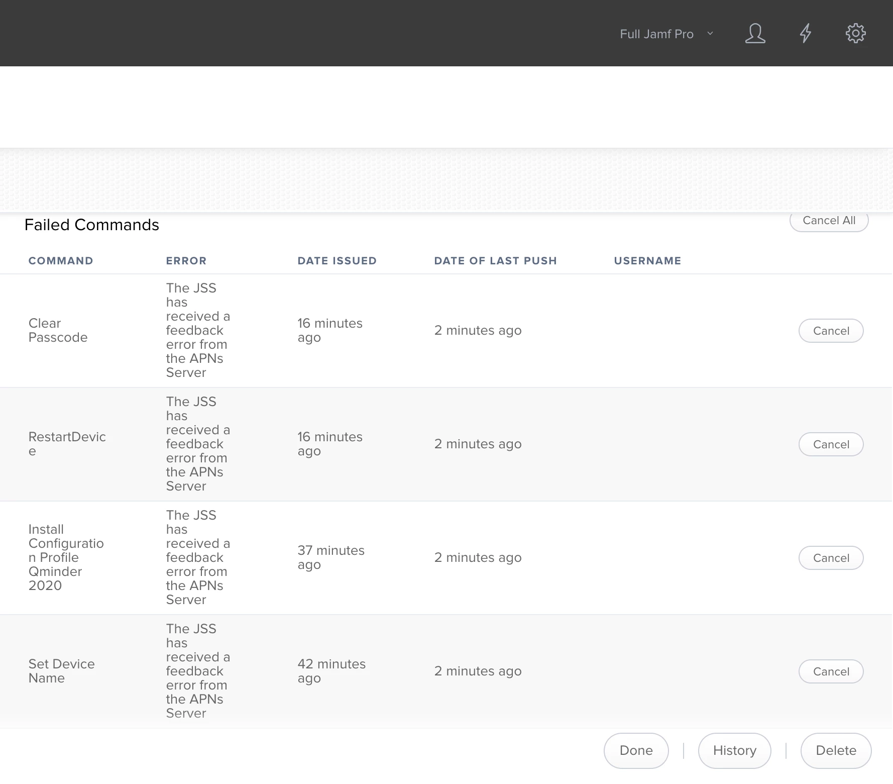

Hello,
I'm looking for some insite into possible causes of the message "The JSS has received a feedback error from the APNs Server," all help is appreciated.
Thank you,
Jacob

The APN server issue usually means the push certificate is off, or that there was a slight delay in configuration per enrollment or re-enrollment.
Solution 1- Match the unique identifier:
In Jamf > Settings > Global Management > Push certificates... make sure the number under “identification” matches the topic ID in your device
Topic ID is located in your device > Settings > General > Profiles > MDM profiles > more details > select the first payload on the list > locate topic... should be something along of: com.apple. Mgmt.external.### * if these matches then we can be safe to assume it was a delay in configurations
Solution 2:
Clear all pending and failed command and resent an “Update Inventory” command
