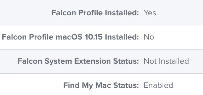

  • August 17, 2023
I followed the Crowdstrike documentation to setup the Config Profile to the tee. There is a script with a smart group that reports back any Macs that do not have the Falcon System Extension "Not Installed" Some Macs are successfully installing the System Extension portion of the Config Profile while others are not. any feedback on this?
Here is the script I am using for the reporting of the custom Extension Attribute:
#!/bin/bash # Gets the installation status of the CrowdStrike Falcon Agent System Extension # # Returns: # Installed - Falcon Agent system extension is installed and running # Requires Approval - Falcon Configuration Profile from Jamf is not installed # Not Installed - Falcon Agent is not installed CheckIfRoot() { if [[ $(id -u) -ne 0 ]]; then echo "This script must be run as root" 1>&2 exit 1 fi } CheckAgentStatus() { active_version=$(/Applications/Falcon.app/Contents/Resources/falconctl stats agent_info 2>/dev/null | awk '/version/ {print $2}') # Prints Enabled if an active agent was found, otherwise print Disabled if [[ -n $active_version ]]; then echo "<result>Installed</result>" else active_version=$(systemextensionsctl list 2>/dev/null | grep -Eo "(.(.|\\s))+X9E956P446\\scom\\.crowdstrike\\.falcon\\.Agent \\((\\d+)\\.(\\d+)/(\\d+)\\.(\\d+)\\)\\sAgent\\s\\[activated waiting for user]") if [[ -n $active_version ]]; then echo "<result>Requires Approval</result>" else echo "<result>Not Installed</result>" fi fi } if [[ "${BASH_SOURCE[0]}" -ef "$0" ]]; then CheckIfRoot CheckAgentStatus fi
