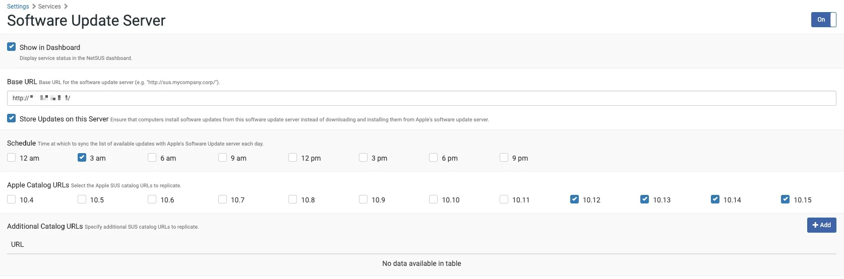

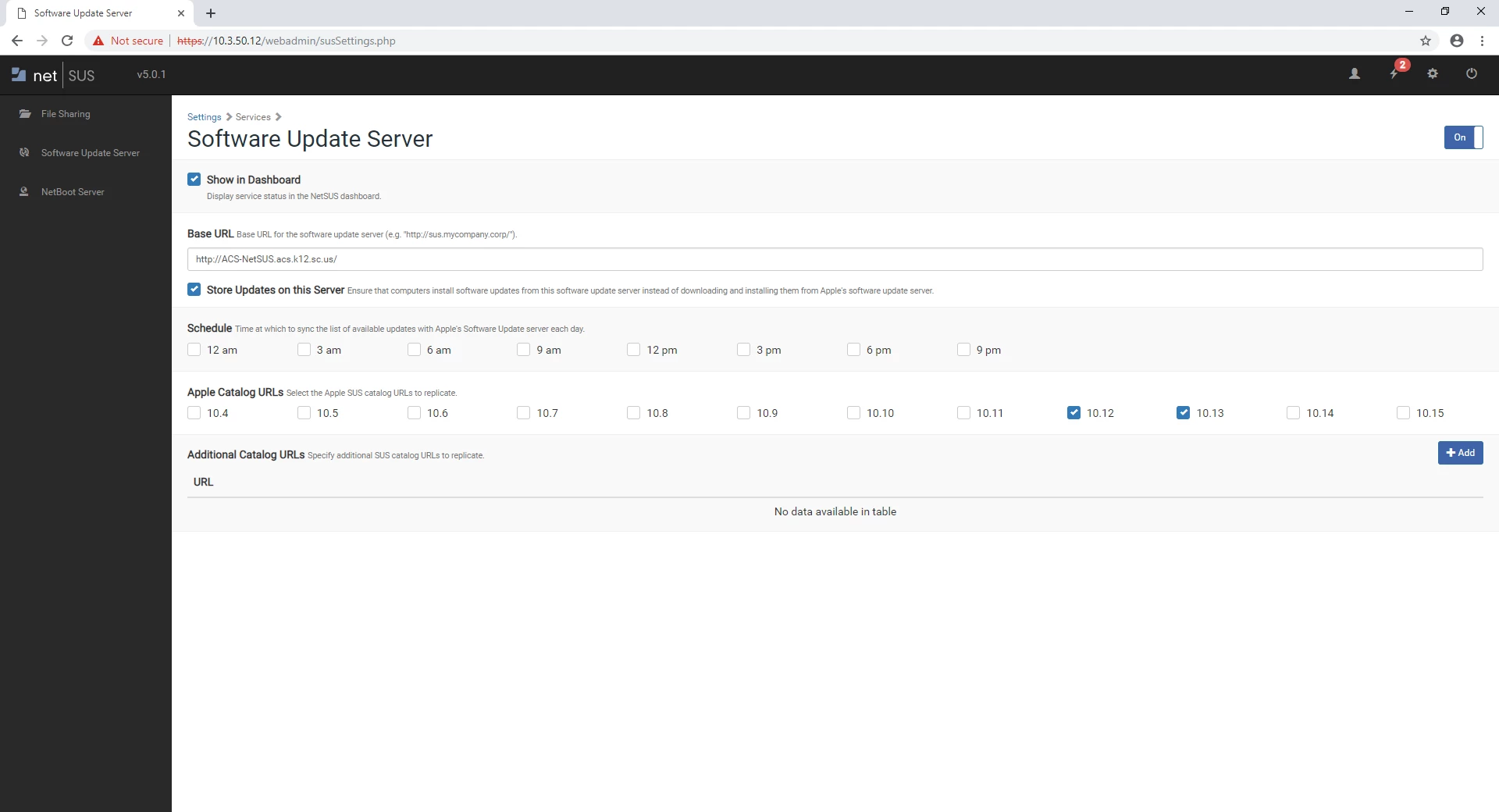

Hello NetSUS professionals. I was pointed to NetSUS by JAMF Support in order to store our software and OS updates locally instead of eating up oour bandwidth. SO, I have downloaded and installed the Netsus v5.0.1 ova and I have kicked off the updates. The help that I know I need is how to setup the Branch URLS's and the additional Apple SUS Catalogs (I am Lost)? My enviromet has Macs that go back to 10.12.6 and newest are 10.14.6. Can someone please explain to me in "NetSUS 101 for Beginners" terms, maybe with screen shots included on how I need to setup my NetSUS in order to have all our devices use our NetSUS Server instead of going out to Apple's update servers? Any help would be greatly appreciated and much needed.

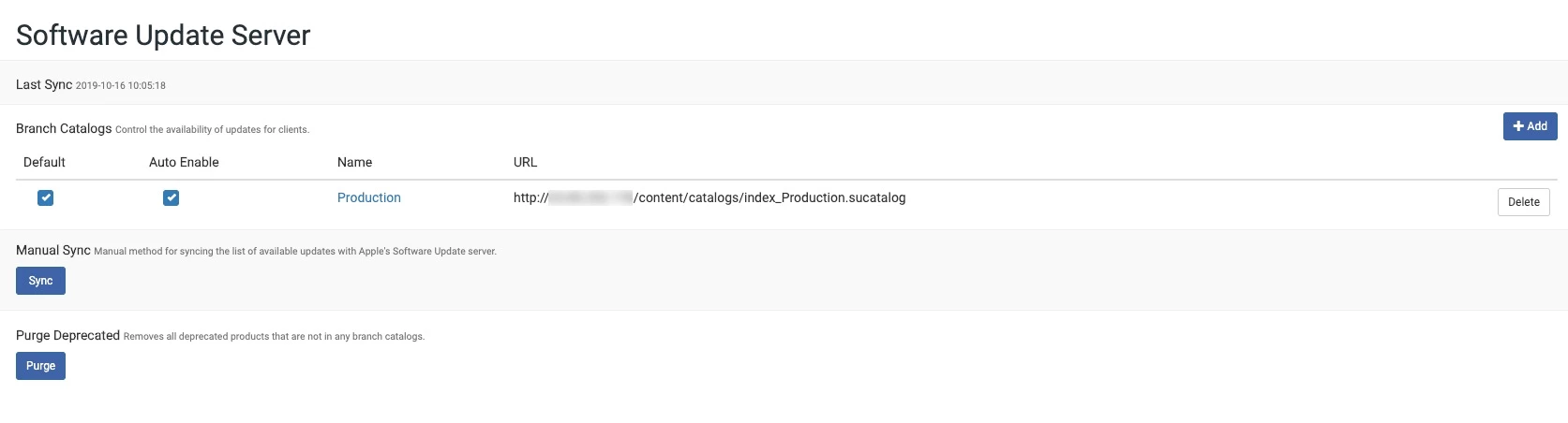

EDIT: I forgot to add, You can setup multiple branch catalogs if you wish. I only have one for production and the "Default" and "Auto Enable" are selected.

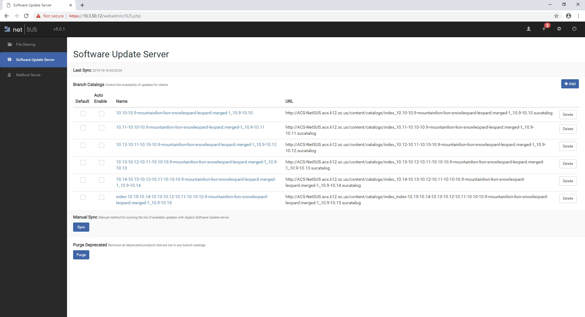

The reason I setup multiple Branch Catalogs is I thought you had to create one for each Mac OS version that I had locally onsite that would be retrieving updates from the NetSUS server. Please explain if this is not correct? I would love to be able to point all my local Mac's to one URL (Branch Catalog) and it get all the updates no matter what the version of OS it is. Can I create just a "Default" and "Production" and place ALL updates there no matter what the Mac OS version is?

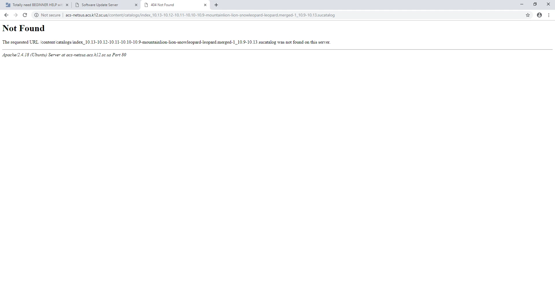

Another question I have is that when I try to access the branch URL it says "not found" is this normal because the port etc that the clients will establish connectivity to it?

Yep, you can have just one Branch Catalog and have all your Macs pointed to that one branch and have multiple macOS versions on that one branch also.
Here is how mine looks
I'm not sure why when you click on the branch that it isn't showing. Since nothing is setup yet it may be easiest to delete all your current branches and recreate the one you will use.
