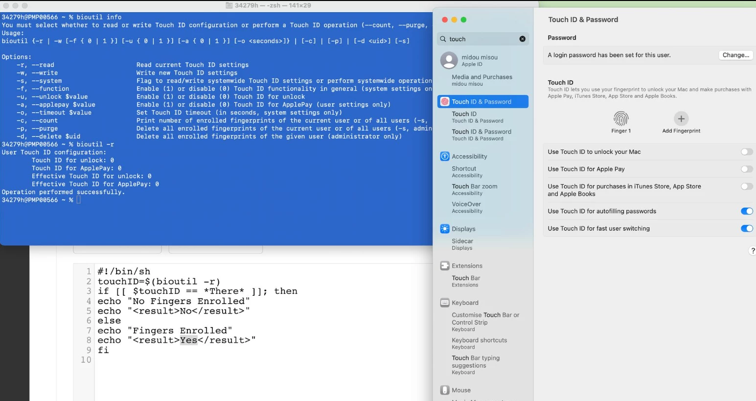

I would  like to know how many are using TouchID to unlock their macs.
My EA is working pretty good. However, i am not able to exclude who have the fingerprint set but not used.
Any idea please?

So are you looking to determine who have a finger enrolled but have TouchID to unlock disabled?
  • Feb 1, 2023 1:21 PM UTC
I like to know only people using Fingerprint to unlock their MacOS
DBrowning
  • Feb 1, 2023 1:45 PM UTC
I don't think you can get that granular from looking at the status.  If you use bioutil -cs it will tell you what users have at least 1 finger enrolled.
$ sudo bioutil -cs
User 503: 2 fingerprint(s)
Operation performed successfully.

  • Mar 21, 2023 9:59 AM UTC
#!/bin/zsh
# This script will list all the users enrolled in Touch ID
# that have "unlock with fingerprint" enabled.
# First, check if the system even supports Touch ID
# If not, bail out and report unsupported.
touchIDfunctionality=$(/usr/bin/bioutil -rs | grep "Touch ID functionality")
if [[ -z $touchIDfunctionality ]]
then
echo "<result>Unsupported</result>"
# Next, list all the users over UID 500 and run 'bioutil' with sudo -u .
# Only capture users that have > 0 fingerprints registered,
# and finally confirm that they have enabled unlocking the Mac.
tidEnrolledUsers=($(for i in $(ls -lan /Users/ | awk '$3 > 500 { print $9 }'); do sudo -u $i /usr/bin/bioutil -c; done | awk '/User/ && !/0 fingerprint/ { print $0 }' | awk '{ print $2 }' | sed "s_:__g" ))
tidUsersArray=()
for i in ${tidEnrolledUsers[@]}
do
tidUser=$(ls -lan /Users/ | grep "$i" | awk 'BEGIN { RS="" ; FS="\\n" } { print $1 }' | awk '{ print $9 }')
tidStatus=$(/usr/bin/sudo -u "$tidUser" /usr/bin/bioutil -r | awk '/unlock/ && !/Effective/ { print $5 }')
[[ $tidStatus == "1" ]] && tidUsersArray+=("$tidUser")
done
# Finally, print the results!
if [[ -n $tidUsersArray ]]
then
echo "<result>Active Users: $tidUsersArray</result>"
else
echo "<result>Not Enabled for Unlock</result>"
