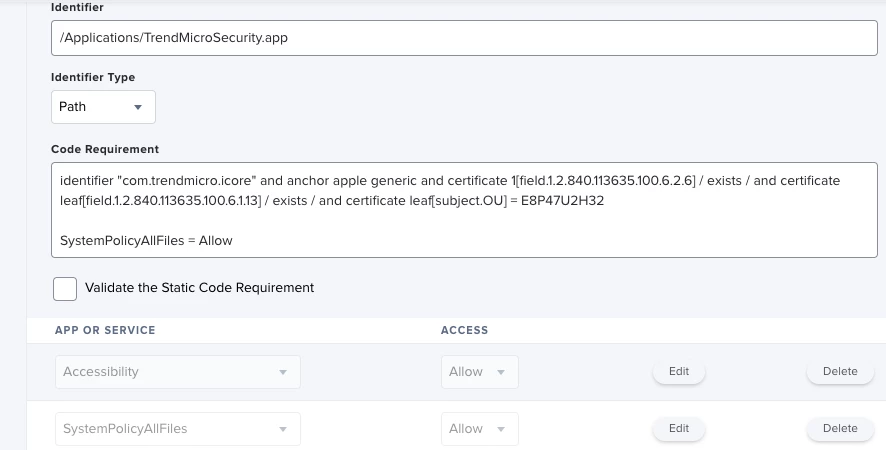

Thanks for posting this so quickly. I've updated my previously working PPPC profile for our Apex One but I still don't see iCoreService listed after the profile applies and I've added the TrendMicroSecurity.app to the profile and that appears, but isn't checked. What am I missing?
  • September 23, 2020

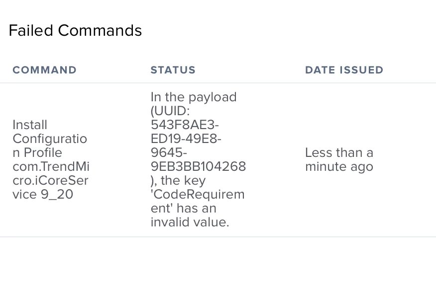

Setting it up like above I get a Failed Command in the Inventory of my test machine.
In the payload (UUID: 543F8AE3-ED19-49E8-9645-9EB3BB104268), the key 'CodeRequirement' has an invalid value.

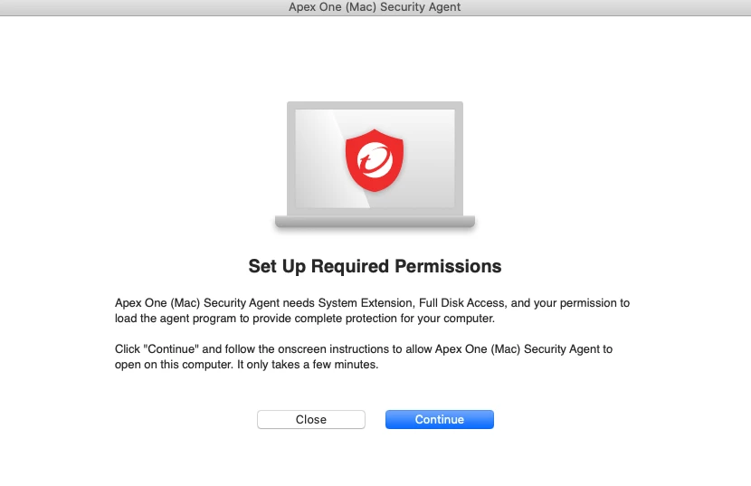

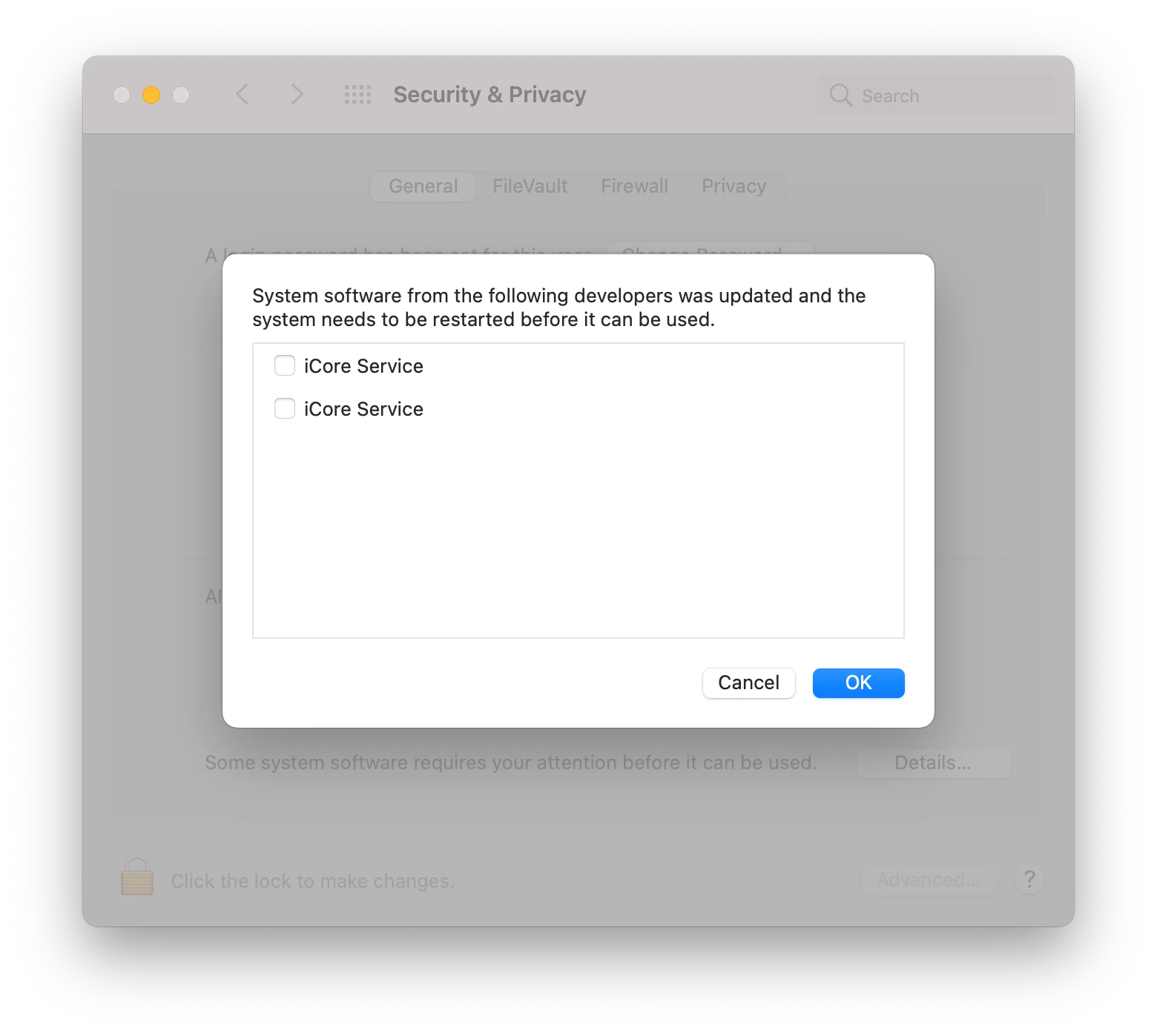

I was only made aware of the change following an overnight update to the Apex One application and being met with the attached image:
So I believe that the PPPC setup for Apex One on all versions up to v.3.5.3617 will be fine, but when the Agent and Console are updated you will need to have the new location added to the PPPC profile

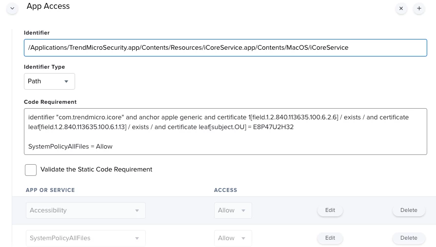

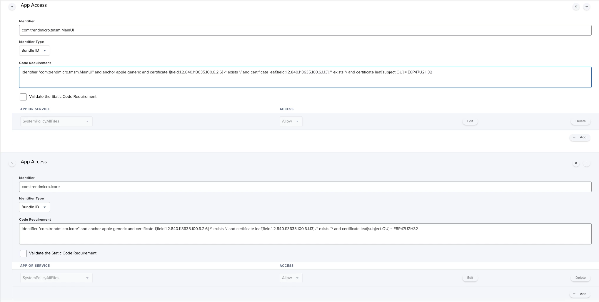

I must be missing something Still getting invalid value in code requirement. Can I get a copy paste of what is in one that works? Or a download of one that works? I can deal with restarting the app that's way easier than trying to get the rest done for each user.

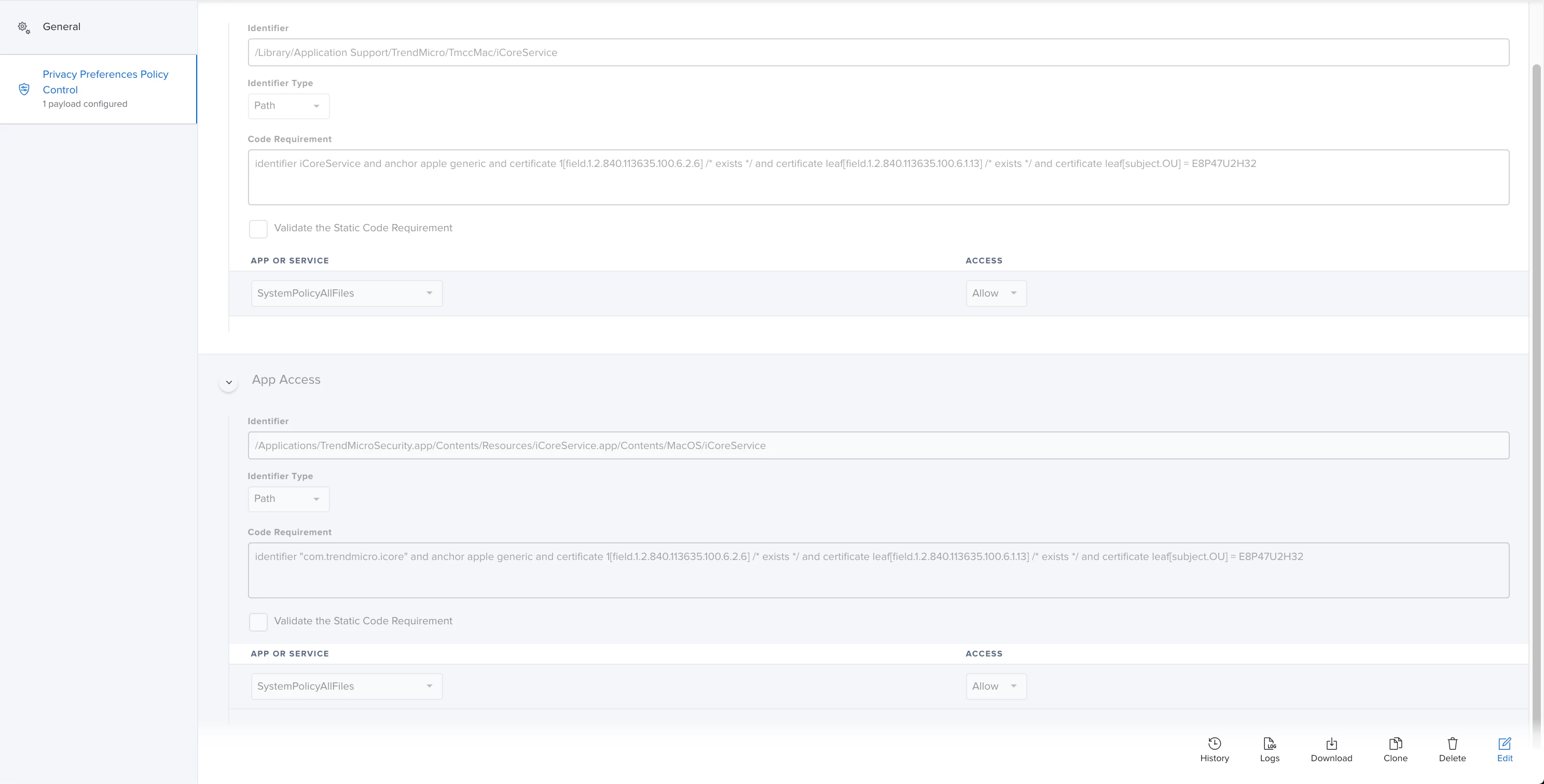

@erichughes Here is a screenshot of the PPPC config that works for us... Hope it helps.
Just in Case...
Identifier: com.trendmicro.tmsm.MainUI Identifier Type: Bundle ID Code Requirement: identifier "com.trendmicro.tmsm.MainUI" and anchor apple generic and certificate 1[field.1.2.840.113635.100.6.2.6] / exists / and certificate leaf[field.1.2.840.113635.100.6.1.13] / exists / and certificate leaf[subject.OU] = E8P47U2H32 App or Service: SystemPolicyAllFiles Allow
and
Identifier: com.trendmicro.icore Identifier Type: Bundle ID Code Requirement: identifier "com.trendmicro.icore" and anchor apple generic and certificate 1[field.1.2.840.113635.100.6.2.6] / exists / and certificate leaf[field.1.2.840.113635.100.6.1.13] / exists / and certificate leaf[subject.OU] = E8P47U2H32 App or Service: SystemPolicyAllFiles Allow
Thank you very much. Finally got it. The star characters were messing me up. Once I got that it works once the client machine is restarted. Much appreciated.

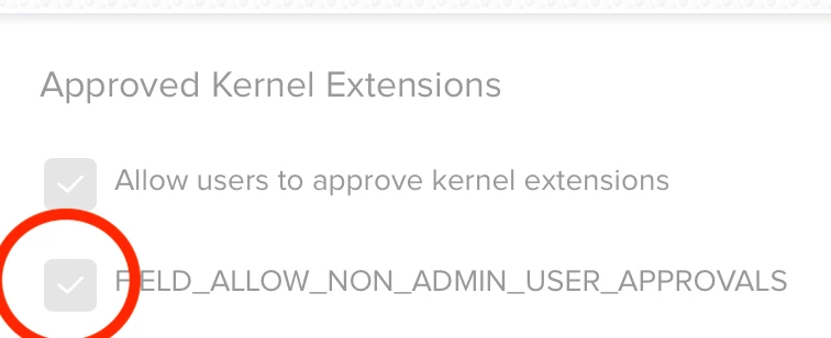

We found checking the FIELD_ALLOW_NON_ADMIN_USER_APPROVALS at least allows users to authorize their own kernel extensions, but we've still been unable to completely automate it.

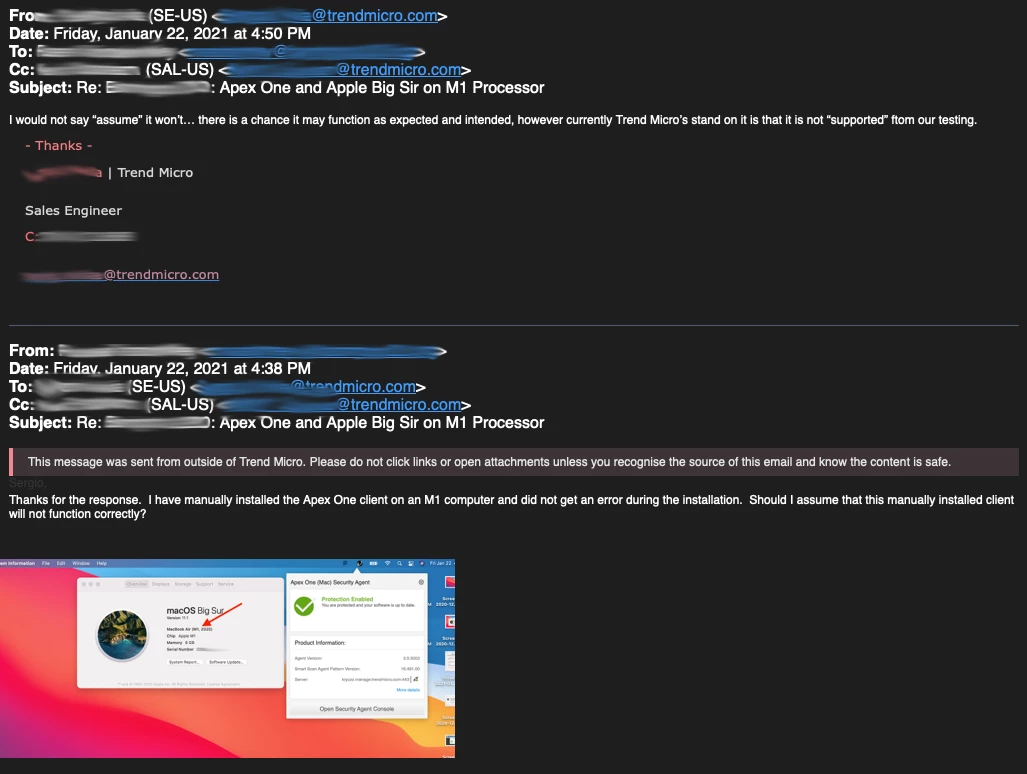

You are correct mnickels. I have worked with our Trend Support rep and he actually provided me with some "Official" PPPC's. Granted I had to fix one of them and added a few more to the allowed list(Don't forget to restart after install). I can provided if someone has need of them. Also I'd like to point out that if you have M1 computers in your future, they are NOT supported by TrendMicro. Even manually installing the client, it will not function as inteneded. I just learned that support for the Apple M1 chips is planned for Q2 2021.

@jbryant I've had a look on Big Sur on an M1 and Trend installs fine and appears to run but there is no way to automate approval of the kernel extension like before. It's incredibly annoying.

From TrendMicro (aka Horse's Mouth):

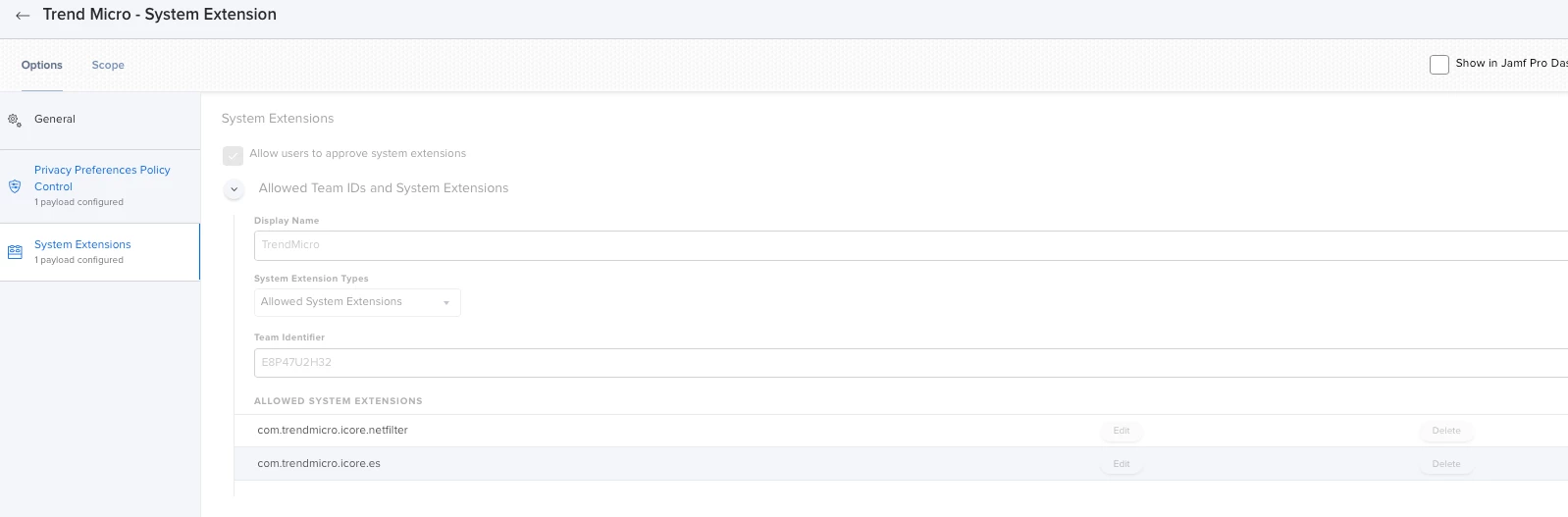

  • February 18, 2021
@ jbryant
Thanks for sharing the profiles. I had to make 1 adjustment in the "TrendMicro_-_System_Extension" profile (see attached image) .
