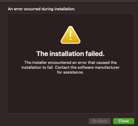

I'm trying to deploy Safari to our test group, but for some reason it keeps failing. I use the same policy I just switch out the PKG. I'm getting the below error message. I've redownloaded and uploaded the install, but it's still failing. I'm plugged in to power, have good connection.
Installation failed. The installer reported: installer: Package name is Safari17.3VenturaAuto
installer: Installing at base path / installer: The install failed. (The Installer encountered an error that caused the installation to fail. Contact the software manufacturer for assistance. An error occurred while running scripts from the package “Safari17.3VenturaAuto.pkg”.)

SMR1
  • Jan 24, 2024 3:15 PM UTC
The install fails when I run it locally.
