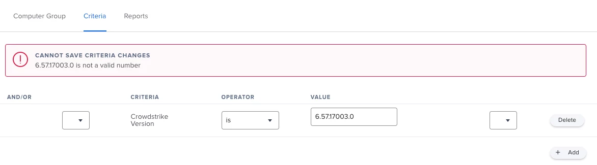

I got it working as a string, but I wanted to set it as an integer. If I set it as integer, it will allow for a Smart Group to fit criteria as 'more than' or 'less than', but the problem is, the Version shows up as invalid. Check out these screenshots.
The EA is working fine and shows the Crowdstrike Version, but apparently Smart Groups see that integer as invalid?
mm2270
  • Aug 11, 2023 1:35 AM UTC
That's because 6.57.17003.0 is not an integer. Integers are basically whole numbers (positive or negative). Even if the version was something like 6.57, that is still not an integer, it's a decimal.
I suggest just using it as a string for now. Unfortunately Jamf doesn't have Crowdstrike in their list of patch management titles or you would be able to use that to build smart groups to give you the less than or greater than function. You could consider submitting a feature request / idea to have them include that in the future.
Alternatively, you could look into Jamf's Title Editor to create your own patch title if you really really want that type of version check functionality.

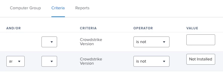

janzaldua
  • Aug 11, 2023 3:56 PM UTC
I prefer to check the agent status and the last connection date to verify compliance
And how would you make a Smart Group based on these EA's?
I was going to make a Smart Group based on the version. That if a version does not show blank, and does not show 'Not Installed', it should be installed. As it will show a version number.
mm2270
  • Aug 11, 2023 4:07 PM UTC
What you have there should work, if your goal is to show devices that do not have CS installed.
janzaldua
  • Aug 11, 2023 4:39 PM UTC
@mm2270 - Maybe how I did it is confusing, but my goal is quite the opposite. I want to show devices that DO have CS installed. Which is why the Operator is set to "is not" 'Not Installed' - A double negative, meaning, IS Installed.
mm2270
  • Aug 11, 2023 4:51 PM UTC
OK, yeah, I see that now. If you're using my "status" EA, it would show something like "connected" or "connecting" for devices with CS installed and it making connections back to the server. Maybe you could use that as a criteria.
