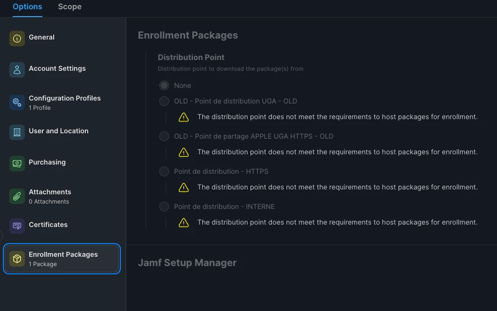

Did you add JSM package and your JSM conifiguration to the prestage? Once the two are there, it should run right after enrollment.
LaurentCh
  • Jun 9, 2026 11:51 AM UTC
Yes i’ve both and i have one configuration profile for JSM

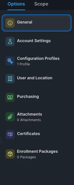

mvu
  • Jun 9, 2026 12:42 PM UTC
In your screen shot, you have 0 Enrollment Packages. Try adding the JSM Package there and test again.

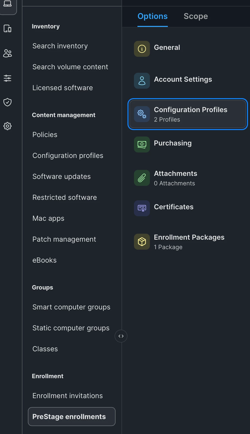

LaurentCh
  • Jun 9, 2026 1:10 PM UTC
I’ve just add the package in the enrollement package but i still must stop setup assistant on a panel to have JSM launch

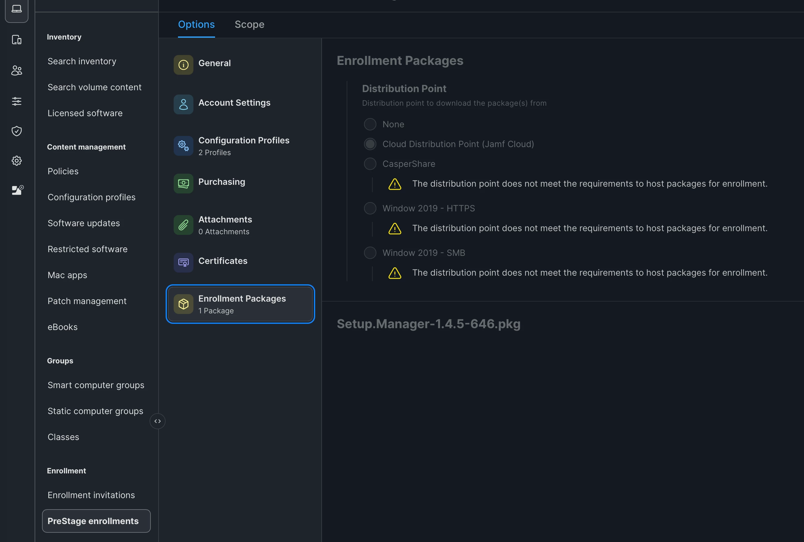

LaurentCh
  • Jun 11, 2026 11:59 AM UTC
Hi, I’ve finally abandonned using Enrollement Packages, because we don’t have Jamf Cloud and our Jamf Pro on Prem instance has network shares manager by active directory accounts… I ask if it’s possible to have a network share R/O openned for everyone but i don’t think its possible.

mvu
  • Jun 11, 2026 1:08 PM UTC
Jamf Setup Manager should still work with On Premise Jamf instance, I believe.
Just requires a distribution point that is configured withan HTTPS distribution point. You might have that setup already?
LaurentCh
  • Jun 11, 2026 1:16 PM UTC
We have distributions points configured, one in HTTP with a R/W account and one HTTPS with a R/O access account.
I saw to use enrollement packages we must have a R/O share with an access to everyone, i think it’s pretty un secure.
